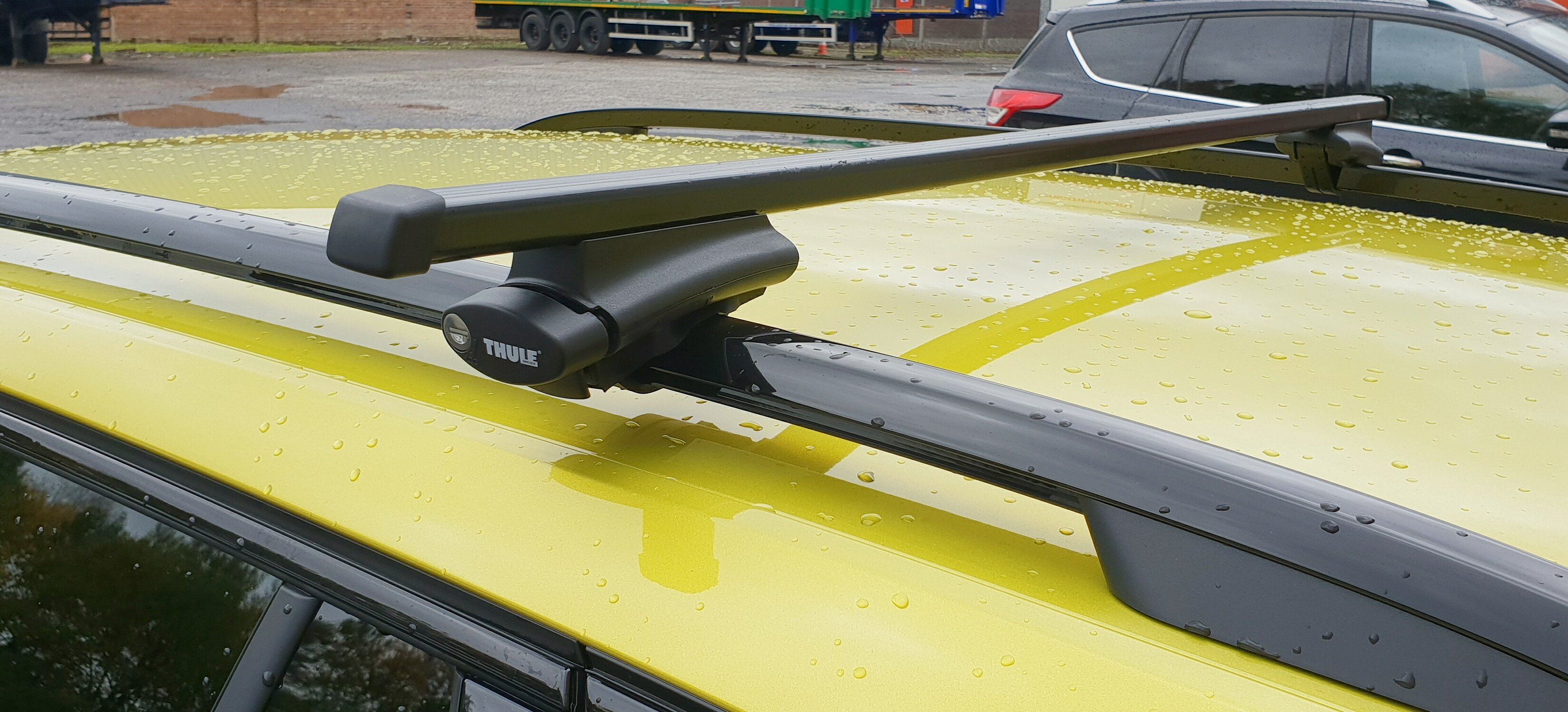

I got the 775 delivered today. Thankfully there is plenty channel space on the bar, so I was able to fit the 127cm square bars with no problems.
Now to sell the old foot assemble for the Octy.
Edited by danmaca
Great news, looks good! Nice and low.
