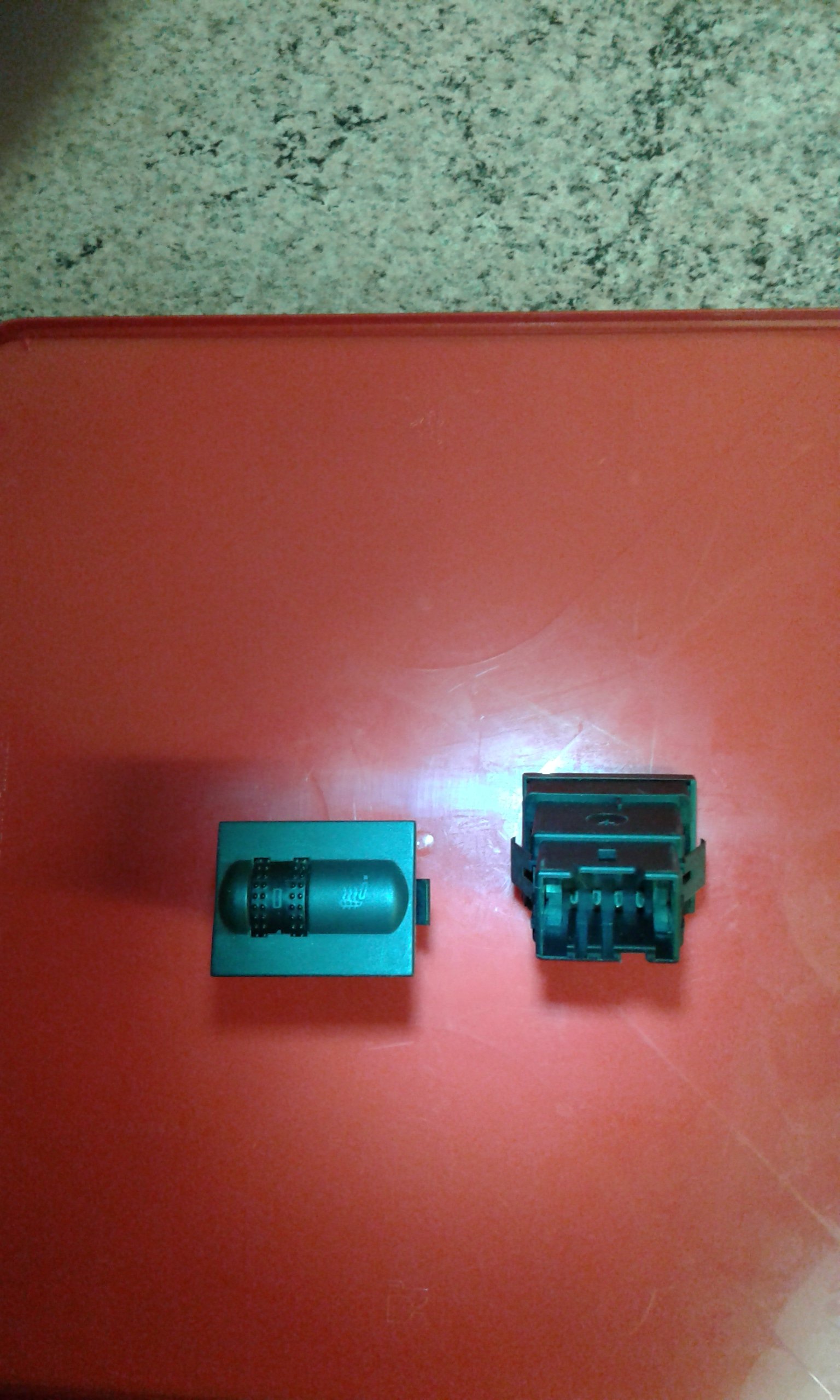

What do the switches you've fitted and not fitted look like?
Thanks for your time Wino.
These are the temperature switches.

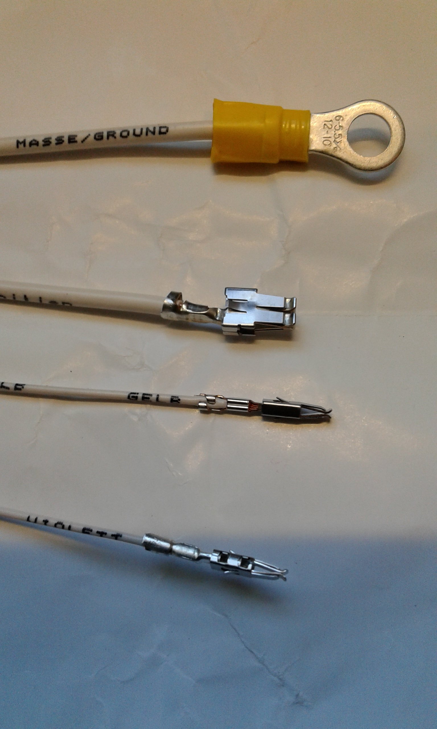

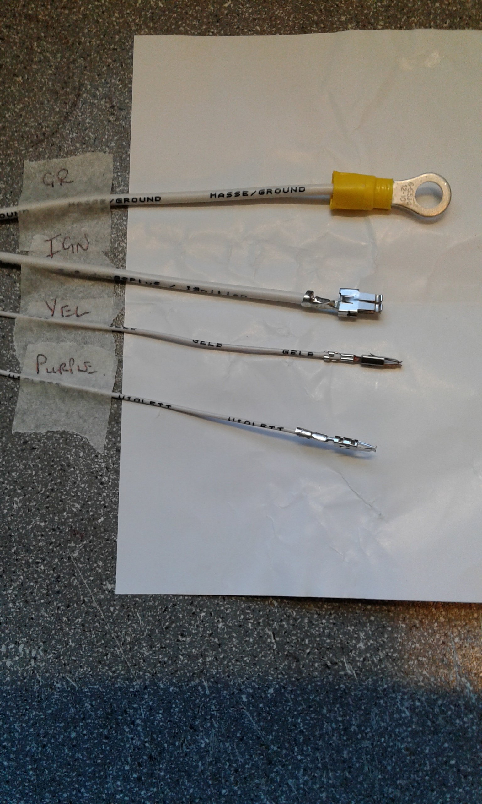

It would help really if we new what yellow and purple wires do.
@NZ100 sorry for the delay in replying.
I'm fairly sure the yellow and violet wires form part of the load management system so that the CCM can shut off the seats if the battery voltage drops too low.
The connections should be as follows:
Violet - Connector XS2 Pin 10 on CCM
Yellow - Connector XS2 Pin 3 on CCM
Hope this helps!

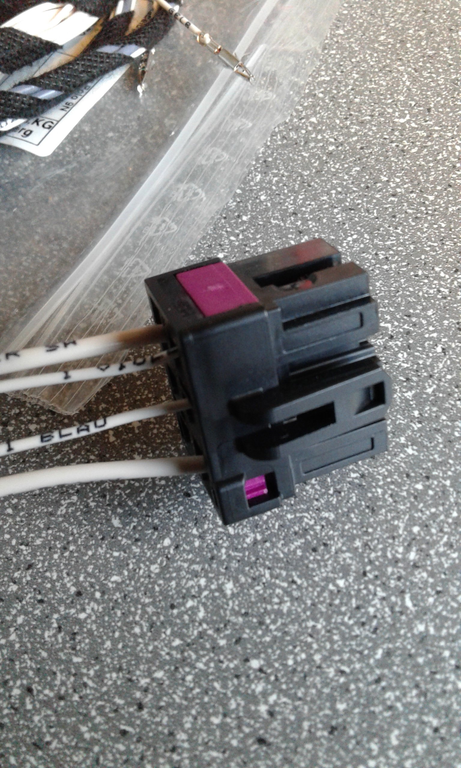

I thought I'd got this sussed a few minutes ago, but then the haze descended again as I found different circuits for different versions of the seat heating in the Polo diagrams that had different pin numbering on the switches from the numbering on the circuit I posted on page 1 (which I now think must be Fabia type).
Starting again from what I hope is the right Polo diagram.
Ignoring Pin 1 of the Kufatec connectors for now as we don't have anywhere to put it...
For each seat/switch combination
Pin 2 of the Kufatec connector needs to go to pin 4 of the switch
Pin 3 of the Kufatec connector needs to go to chassis/earth as does pin 5 of the switch
Pin 4 of the Kufatec connector needs to go to an ignition-switched 12V 15A fused supply as does pin 3 of the switch
The 15A fuse should be shared with the other seat
Also, if you want the switch to light up like the other switches, pin 6 needs to have a feed from the dash illumination rail
Not sure what if anything your switches are currently plugged into, but if there is an existing connector in the car for each, we'll need to know which colour wires go to which pin numbers. They probably don't go where you need them to.
Try to get better photos of the Kufatec connector showing pin numbers (I think it goes 123 down one side and then 4 opposite 1?, of the ones with wires in), and one of the switches again showing connector pin numbers if possible.

I thought, before i fit them, would i be able to sort the heating out first. Took a chance and ordered a loom, for a VW Polo, to be sure i got the right plugs to plug  under the seat, and also the control switches . So the loom fits everything.  Where do you connect the five connections you have at the end of the loom. Do i need the control switches to be illuminated , not really. Down to four wires, we now have, yellow and purple wires, X figured they were to do with battery management . Down to two wires, one is ground, the other is ignition . W, sorted that the Roomster, electrically , does not have the places to plug the yellow and the purple wires in.
What would happen if i just linked up the ground, and the ignition wires up ?
Try it (as already said elsewhere).
Essentially is a very simple circuit and shouldnt be over complicated. As long as the ignition live is fused then it should be all good.

That's what I'm struggling to visualise. You've posted a photo of the car side of the underseat connector with only four terminals populated.
You've posted a picture of a Kufatec plug with only four wires connected. I made the assumption that fits the plug with only four wires. Two of these, one for each seat? One with a 'purple' wire, one with a 'yellow'?
You've said nothing about what other bits of loom might be supplied such as might connect to the switches.  Help us to help you.
