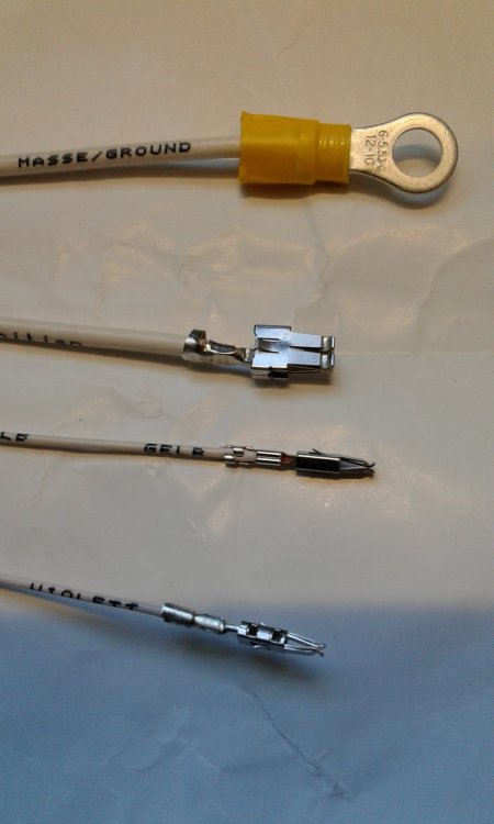

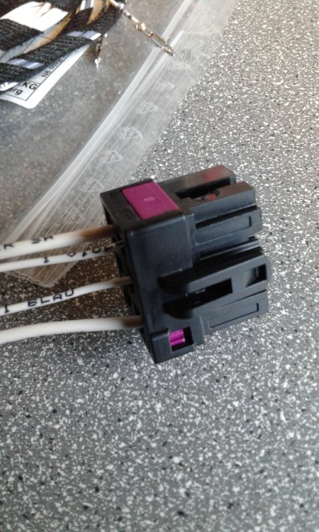

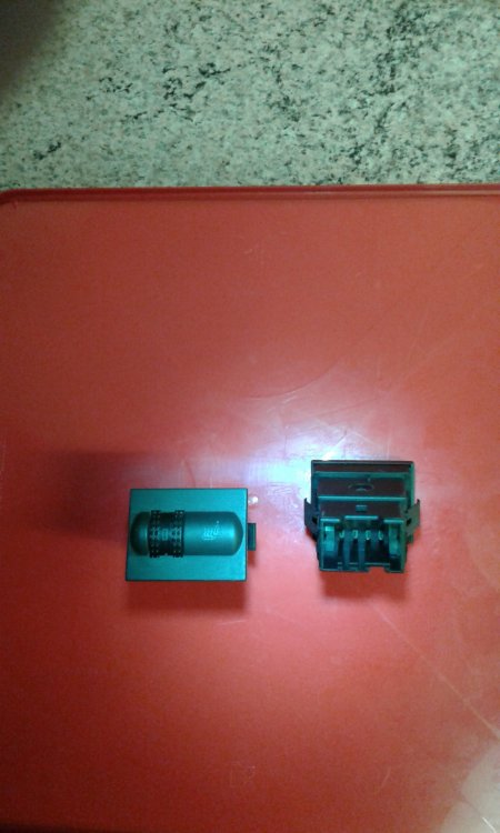

Yes the loom has two plugs, one for each seat, and two plugs, one for each heater control. And the five wires that come out of the end of the loom. The main thing was, because the seats wer e going into a different car, where do the connections go, which is what you and others have done.

Without you having to look back on all the previous posts, i ended up, once the loom and switches were fitted i basically ended up with, a wire that goes to ignition and one that goes to ground.
