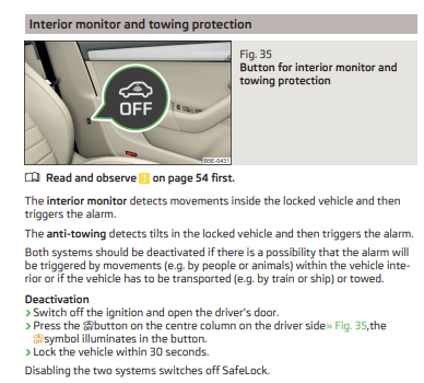

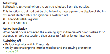

Reading the manual (https://ws.skoda-auto.com/OwnersManualService/Data/en/Octavia_5E/05-2016/Manual/Octavia/A7_Octavia_OwnersManual.pdf?_ga=2.31008895.1723216336.1541424053-1b4691cf-b83c-4334-92b5-015fc90f0968) suggests:
To disable the interior sensors:
Regarding SafeLock (Deadlocks) -
- In summary,
The alarm is always activated upon locking the car (one press or two), however the interior monitors can be disabled by pressing the button beside the drivers seat.
SafeLock is also always activated by default, however to disable this, you must press the lock button a second time within a short period of time.
If you disable the deadlocks, the alarm will still be activated.

My 2017 Octavia has no button on the pillar to disable the internal sensors, and a double click on the remote does that.
Are you sure? All Octavia's with a factory alarm from at least 2014 onwards have an interior monitor deactivation switch, at least according to their user manuals. Double locking is only used to deactivate the SafeLock system.
I am certain because I changed from a 2010 Mk2 with the button, and had used it fairly frequently when leaving our dog in the car.
Weird, seems the FL reverted to using the Infotainment instead. Ah well, useful to know since I'm getting an FL soon and I tend to lock the car with the kids in at petrol stations etc :D
Correct. It was present in my 2015 Octavia but on the 2018 FL model the option is only in the infotainment menu.
I'm sure someone (dealer?) told me pressing the lock button twice disables the internal sensors, and it seems to have worked so far for me,  This is not documented in the handbook however.
