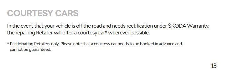

My 8 year old / 150,000 mile MkII Superb had a new EGR valve fitted a few months ago, under warranty, at a UK-based Skoda main dealer. They didn't have an available courtesy car so Skoda UK stepped-in and arranged a hire car via their partnership with Thrifty, all sorted within a couple of hours.
Have you checked out the warranty terms and conditions, does your use of the car as a taxi adversely affect the elements of the warranty, in particular the area that covers a replacement vehicle?
I assume your car is classed as an 'approved used' vehicle?
If so take a look here...
http://www.skoda.co.uk/SiteCollectionDocuments/downloads/brochures/SKODA_Warranty_Terms_Used_Car.pdf
Check out page 13...

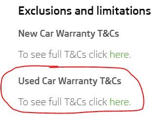

I suspect the warranty could potentially be invalid as warranty exclusions include :
"The vehicle is operated long term in a country for which it has not be specified"
This is legal semantics, but if that version was never on sale in Ireland, they could invoke that clause
http://www.skoda.co.uk/SiteCollectionDocuments/downloads/brochures/SKODA_Warranty_Terms_August_2018_New_Car-1.pdf
