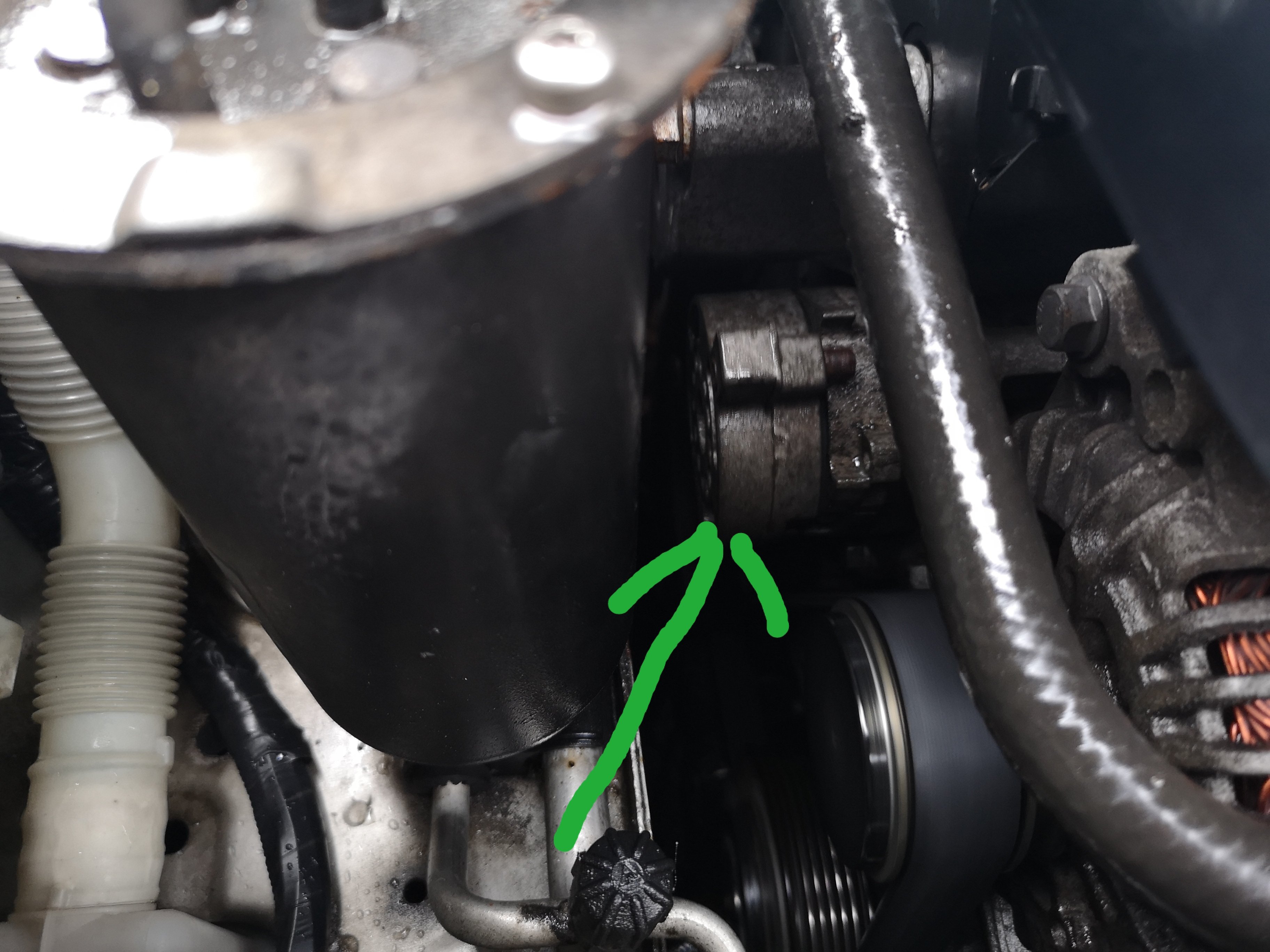

Thanks all checked seems ok while im on here what is this unit it seems to move creating a chuggy chuggy sound not heard this before.
Aux belt tensioner.
Sometimes a failing or seized alternator pulley can make that tensioner bounce about a bit
Oh joy.. New alternator needed then i assume.. It is charging ok atm.

As this car has a dmf, this probably is an alternator fitted with a unidirectional clutched pulley, its common for those to seize and cause this symptom Can be changed but requires a puller or some elbow grease to get it off the shaft. Used to cost around £50 for a new pulley.
 Cheers xman
To check, remove belt, use a screwdriver carefully to lock the rotor and see if the pulley locks in one direction  and is free to turn in reverse.
