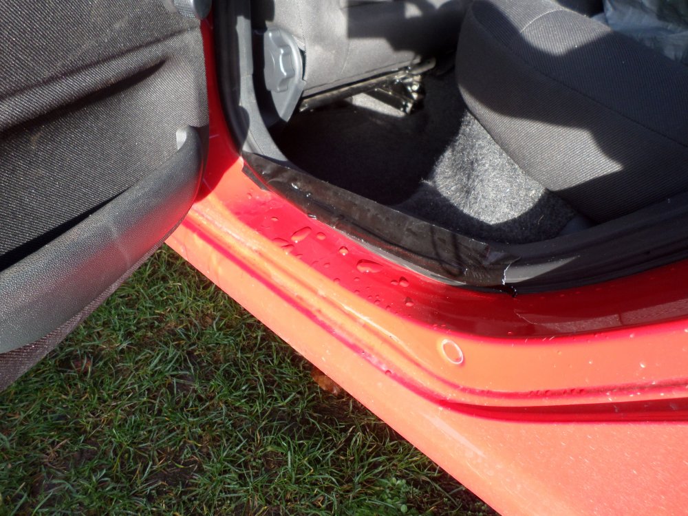

waiting for warmer weather to do mine, in the meantime another use for gaffer tape, the engineer's solution to many problems.SAM_0168.thumb.JPG.7039c154976f8c6f1c232eb0772d6b31.JPG

Similar problem, but it will wait for better weather. Had the fronts done under warranty lots of years ago. Bloke I spoke to said if cards were screwed in, they replaced seals,if rivited then they used sealant. I'm tempted to seal a plastic bag on the inside of door, so that it gets between door and upper sill and keeps water out of car, letting it drain to the outside.
Now also thinking of fitting bilge pump to rear floors. :D
