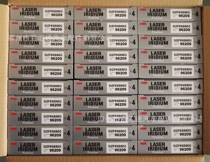

These are the NGK IRIDIUM IX I bought and were utter crap

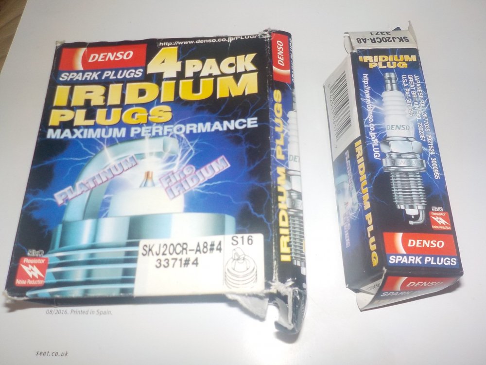

These are the bad boys you want

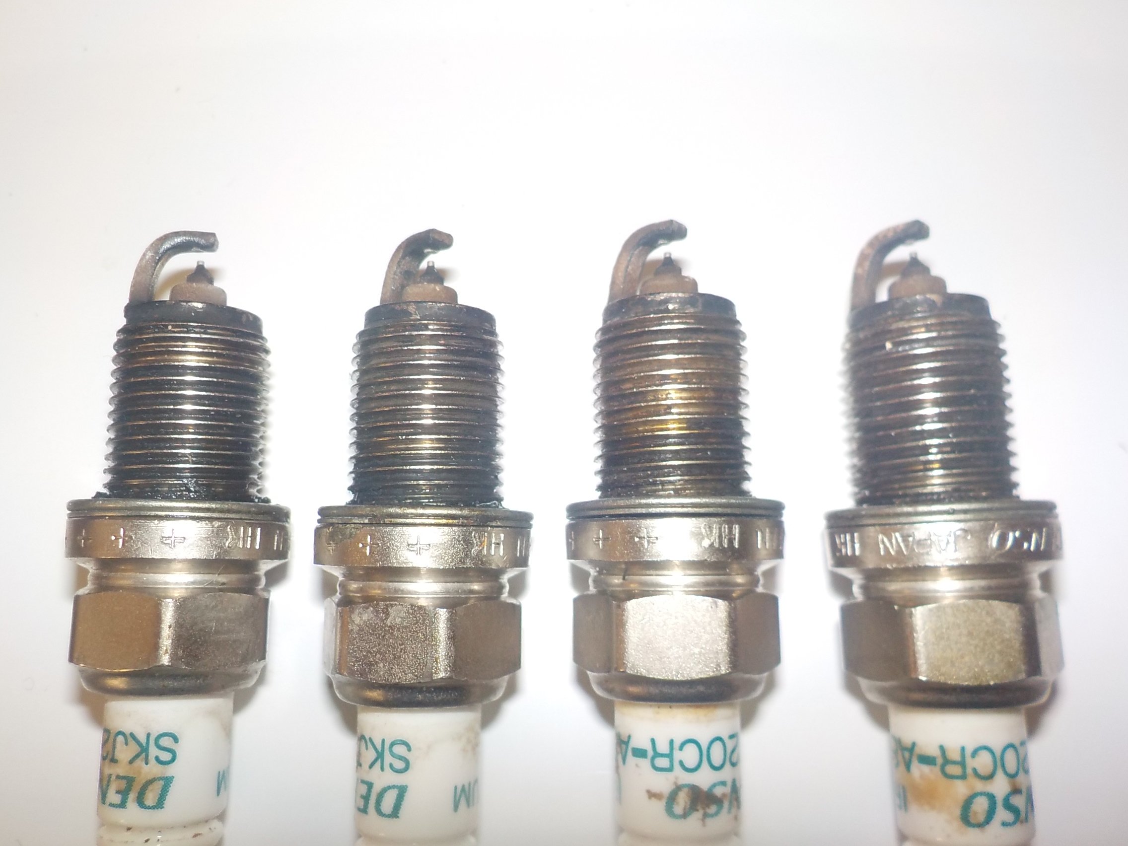

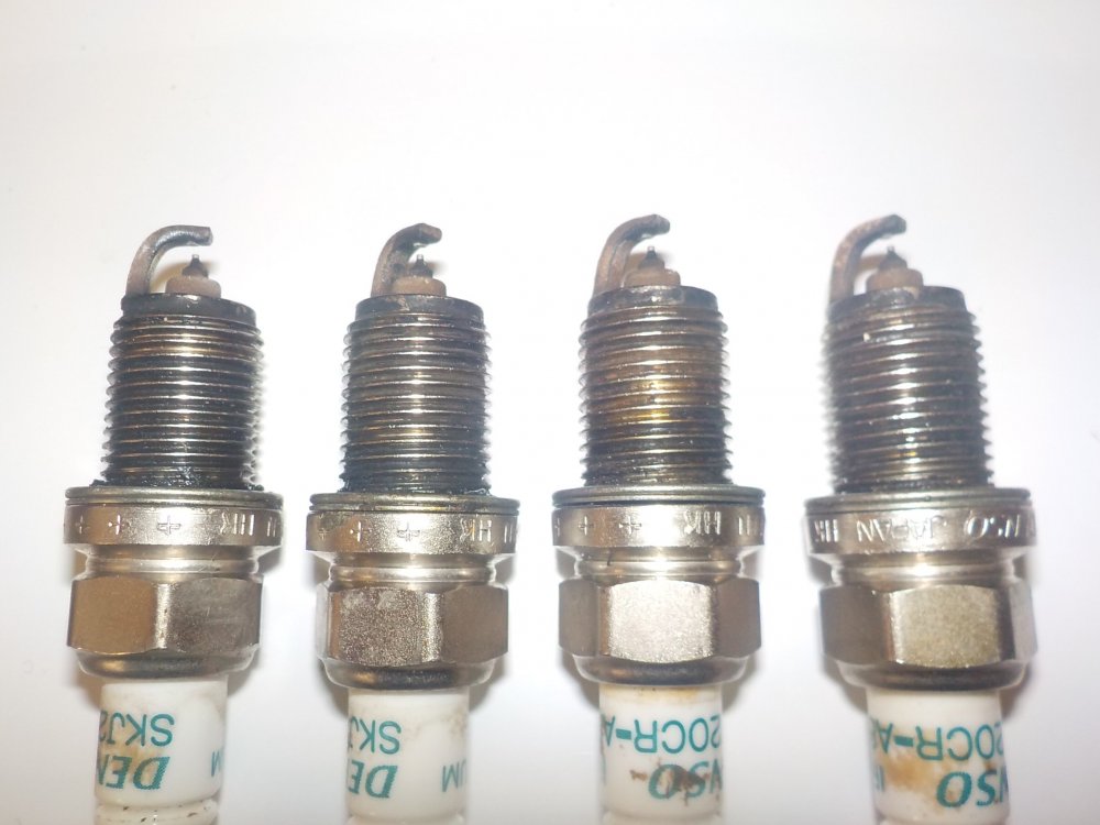

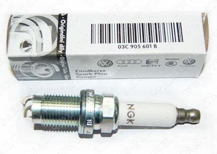

I've just uploaded the 2 photos of the plugs, mines standard haven't remapped yet but only got racingline air filter on which is pretty good

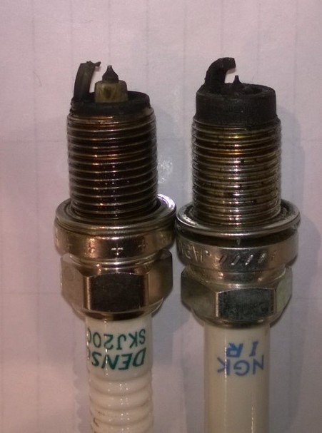

These are the DENSO i have always put in my or others Twinchargers and never had an issue.
But another member has had. (See bottom picture.)
Remember there are Hooky Spark Plugs about, always buy from Trusted Sellers / Suppliers.

MY NGK  plugs.looked like the last picture after a month
Are you sure they were not Fake NGK's,  & what gap were they at?
the original and the updated are crap but usually lasted 10,000 miles or more.  Or the 1 that gets burnt out does.
Best Check the Ignition Coil is OK.
The Bottom Left Plug is why so many engine got wrecked.
