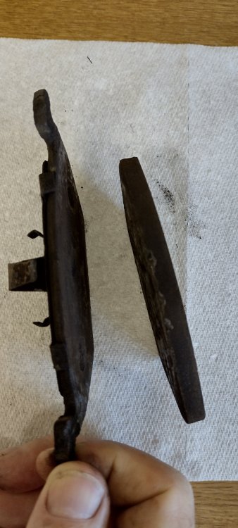

IMG_20240127_091951317_HDR.thumb.jpg.5d8fa6572f2cb08e7379b68c42318bba.jpgBosch Brake Pads bought from EuroCar Parts fitted June 2019 along with new ATE discs. So now 4½ years, 45,000 miles  half worn.
Leaving house, slow speed, suddenly loud banging, terrible noises and super aggressive snatching when braking. Then a big bang and no brakes. Partial braking restored after pumping pedal several times gently but obviously metal on metal and very little stopping power.
Roadside examination showed friction pad had completely detatched from its backing plate. Pad thrown into road.
Fortunate it happened within 20 yards of home and never went above 3- 5 mph. Would have been disastrous had it happened later in normal traffic and likely to have been fatal on a motorway.

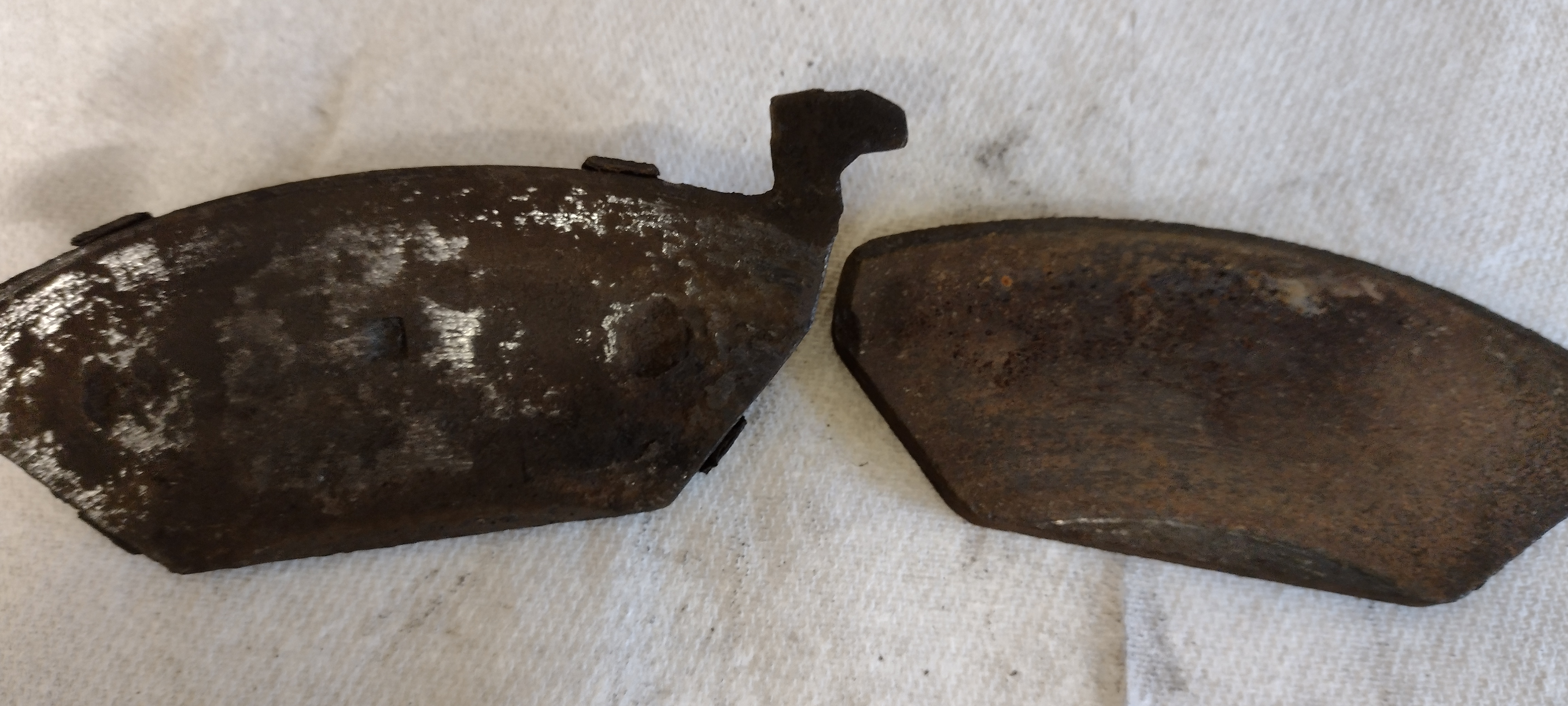

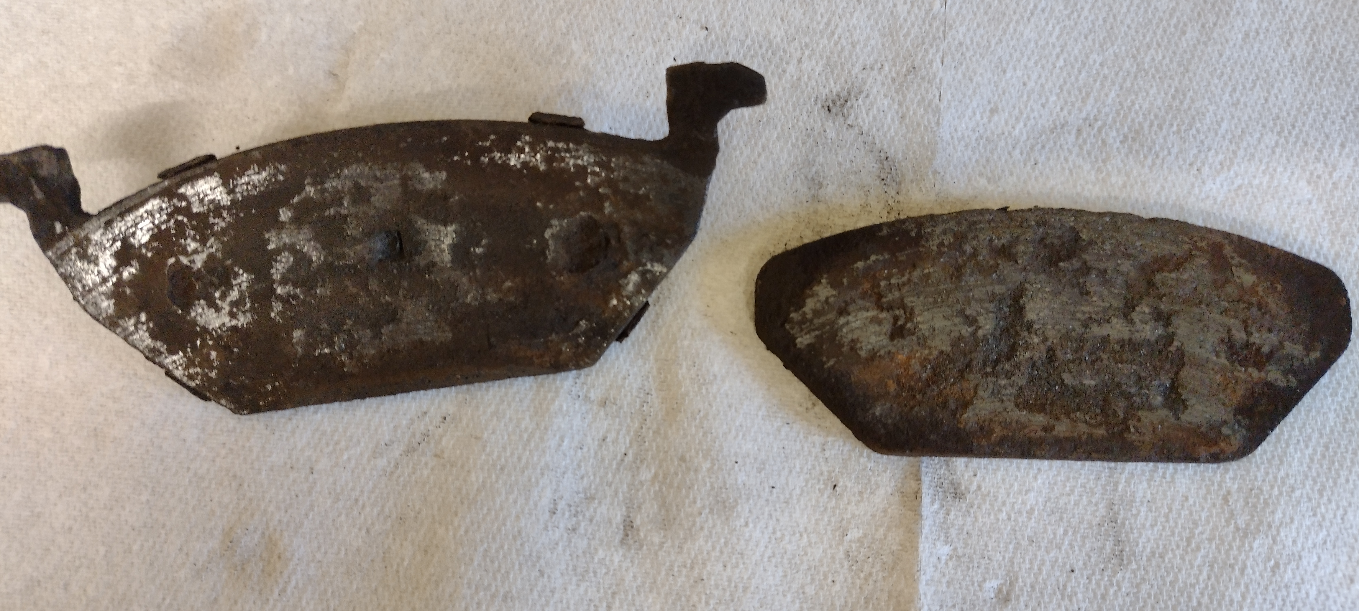

Bonded side of pad
Friction side

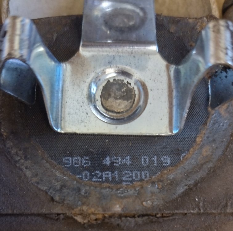

Part no

I have in the past seen indents or holes in the backing plate and the friction material has had locating pegs sticking into them, the idea was that they would take the shear force if the bond was to fail but pad material is very brittle, you could not rely on it holding up under an emergency stop.
I know the reason this was dropped, water ingress through the holes was creeping into the bond by capillary action creating rust which seperated the pad from the backing, just like what is visible in the OP's photograph.
@xman
Do you live by the sea and is the car parked outside?
Those backing plates are as rotten as a carrot and you can track the water ingress from the inner and outer curves.

Beyond the pad/plate interface the plates are in reasonable condition. Water between friction pad and backing plate is possibly behind the failure, but that shouldn't happen if bonding has been properly applied and fully seal the pad to the plate.
@J.R.I recall in previous threads you said you have extremely poor eyesight 🥸 You can't really judge anything from those poor quality pictures as there is a 3d element you can't see.
I'll update if I get any feedback from Bosch or ECP.
I know what rust looks like regardless of the quality of your photographs but thank-you nonetheless for your disdain regarding my eyesight.
There is a 3D element that I can see, there are voids in the back of the pad that align exactly with the most corroded areas.
