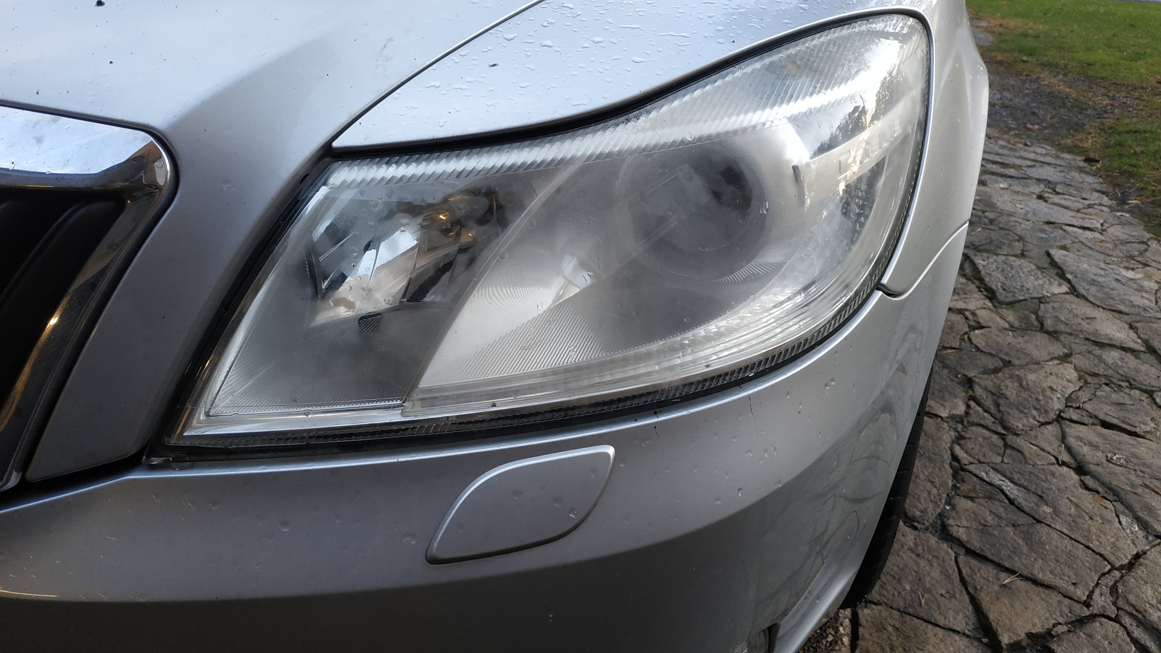

This is what I typically find in the morning. The other day I had moisture droplets running down on the inside only a couple.
That's nothing, you want to see mine for the last few days. Have even driven in daylight with the headlights on to try to dry it out, without success. Plenty of droplets in my headlight. Wish there was an easy cure!

Condensation is fine, water droplets suggests excessive moisture ingress.
OK...
Not OK...
Just to update you all I took the advice of @langers2k . I stripped the headlights out removed al the bulbs and waked the hairdryer on it about 15 mins each light. I will now monitor and see what happens after rain to see if a have a bigger problem.
The main offender was the drivers side so I have a good look around while the unit was out and the vent whole was blocked - SPIDER!!!
or in future for an easy fix just remove the rubber backing cover when going on a run the heat from engine will dry it out
