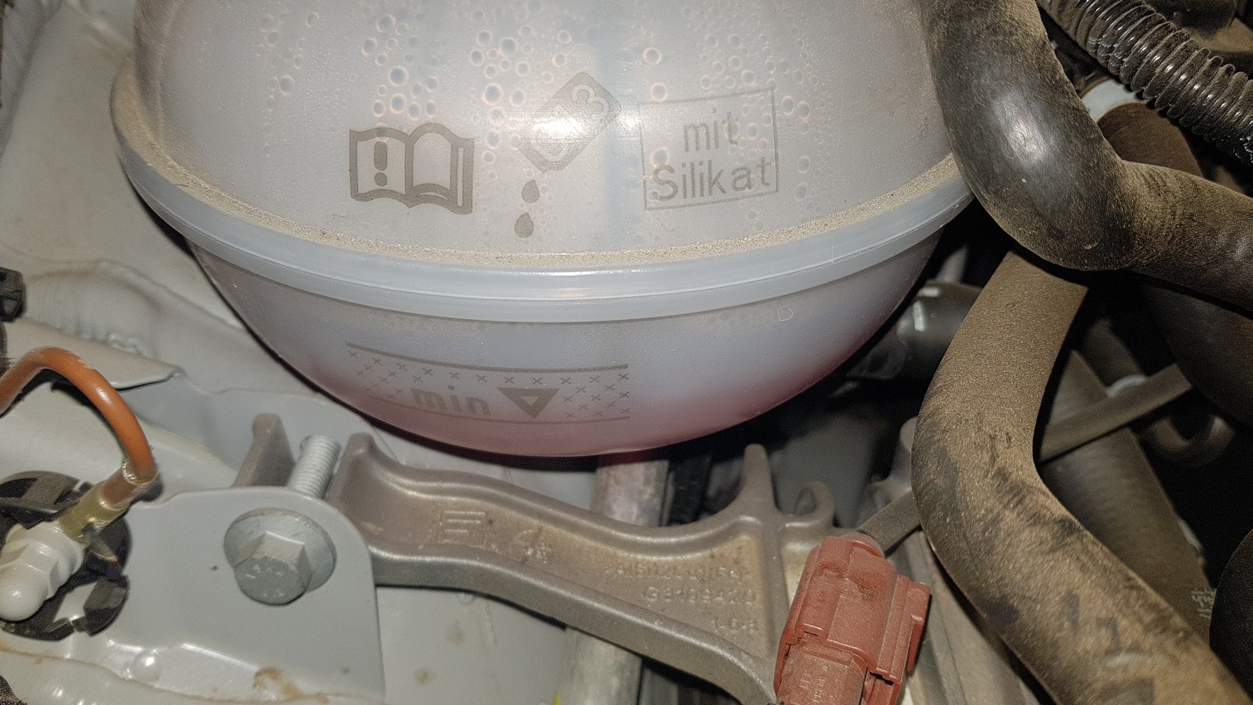

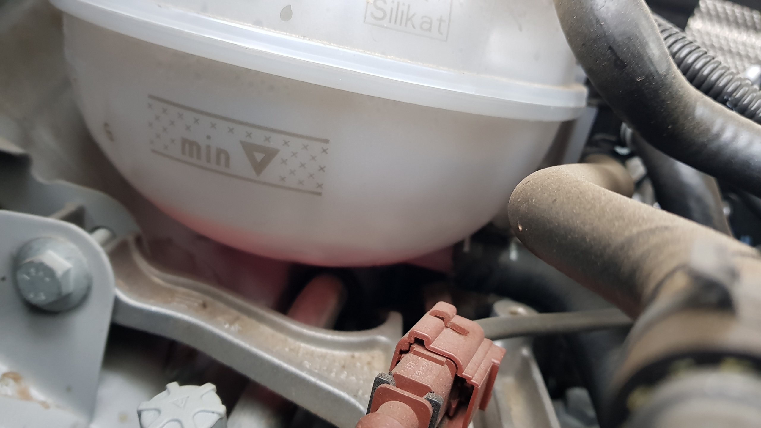

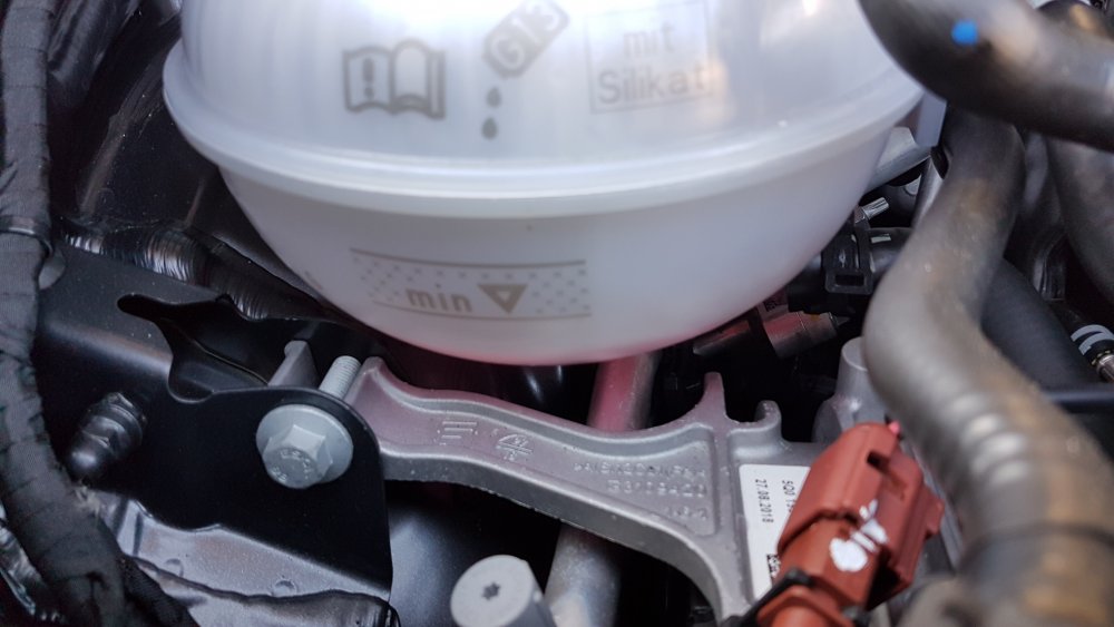

I put around 300ml. Maybe I should have put more, but it's not too late :D
 Please see below the pictures from the before and after:
Edited by Gabi4
After 5000 km on the clock, no change of coolant level was observed  :)

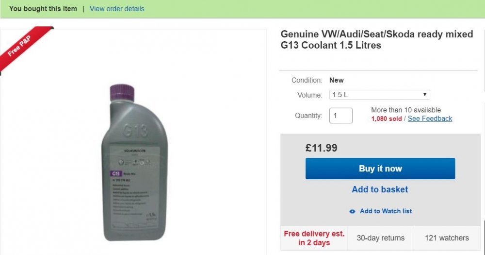

I bought some anyway. No harm in having a spare litre at home, or in the boot.
Only £12 delivered to your door...
