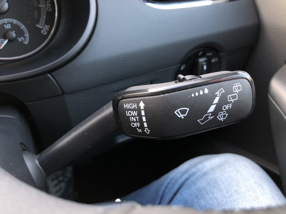

Also I’ve attached a picture of the right stick, I’m not sure if this has the sensor? I push it up once and it’ll wipe every 15 seconds but will wipe more if there’s more rain.
 Looks like I might need to plug in a vcds and get it uploaded to help.

The rain light sensor wouldn’t be obvious from the wiper stalk.
If you say whereabouts in the country you are, then there may be someone local with VCDS who can scan your car.

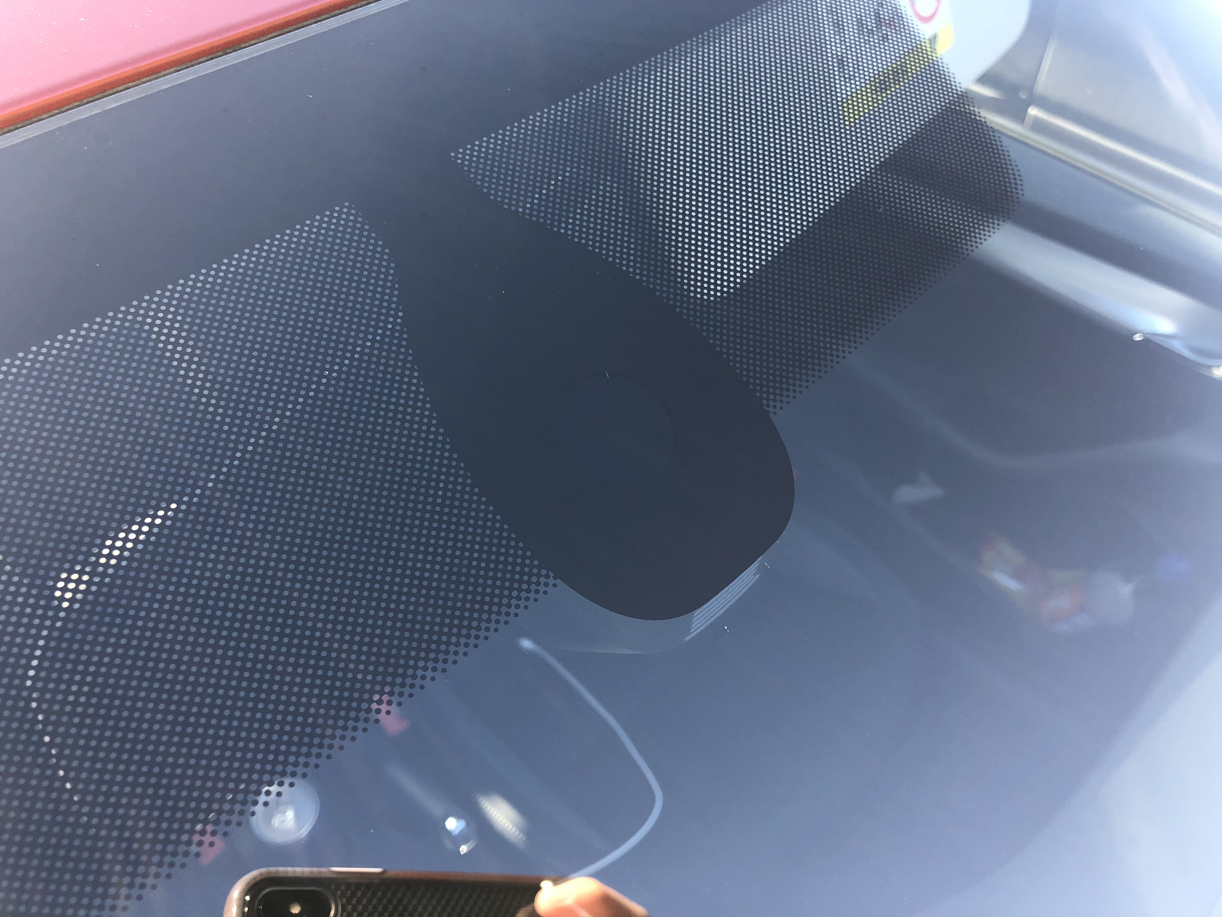

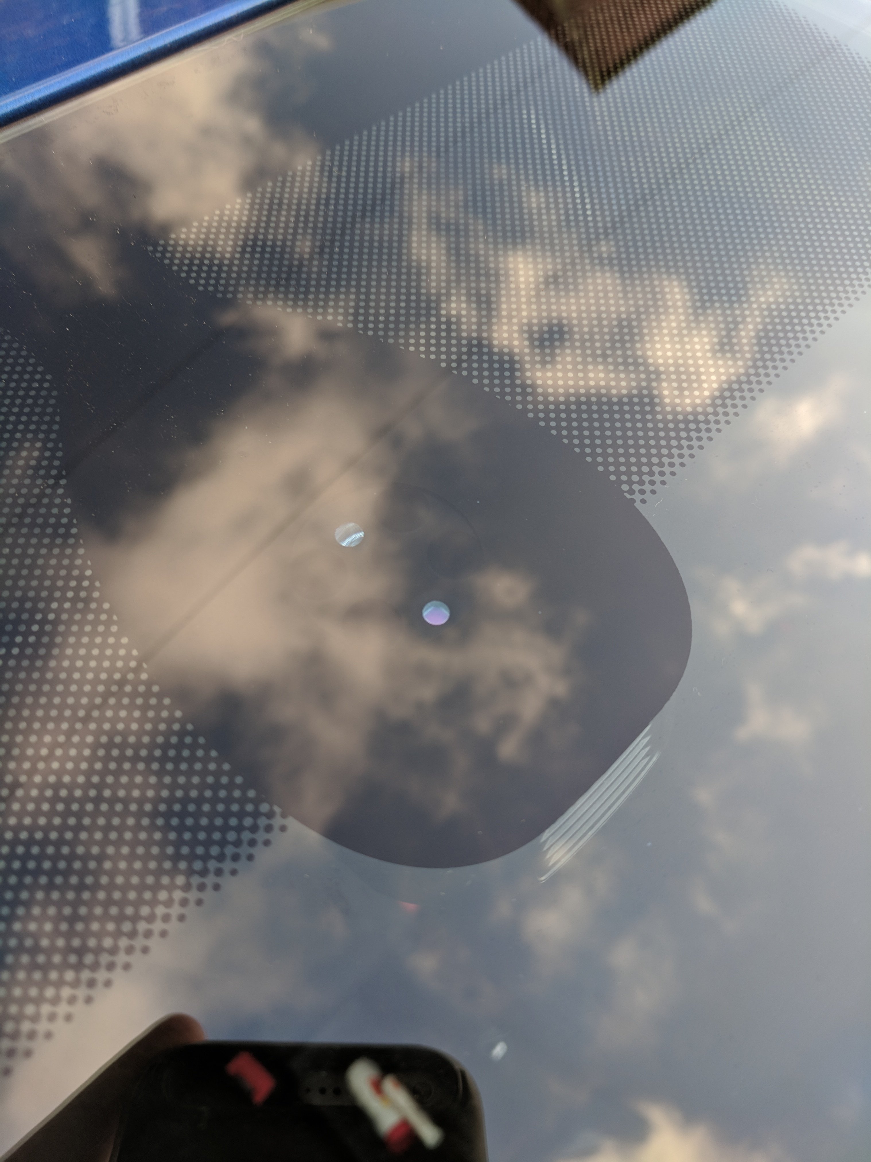

It's trivial to see if the RLS is fitted. Take a picture of the rear view mirror mount from outside the car and post it here :)

I’m guessing this needs to look like it has a dimple or two to show the sensors?
What’s weird is, if I turn the wiper on it will wipe every 10-15 seconds but if it’s raining it will wipe at a more consistent rate like it has a sensor...how confusing.

As above, I don’t believe you can spec auto wipers on their own. Retrofitting the RLS isn’t all that hard and while you are there you can add the lowline camera for Auto High Beam. Nothing is impossible on these cars.

Thanks for your references, it is appreciated! I can see I have the slot for the sensor, there's just no sensor in there...
