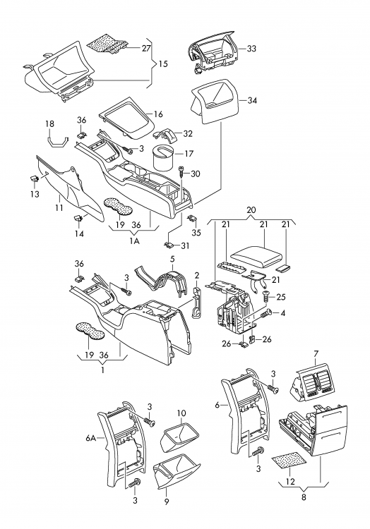

I want to check the adjuster under the centre console. How do I get the console off please?
I've found this diagram but not in the way of what screws to undo & where they are.
I would have thought the adjustment would be done externally.......usually by reducing the effective length of the outer sheath.....or similar.
I think on my Fabia it was reached by removing the ashtray/drawer.

I don't mean to remove the console but the adjustment was accessed like that.
Ah you mean the tray for the rear seat occupants (Item 8 in the diagram above). I haven't had time to take a look at this but the discs were very hot to the touch by the time I'd travled the 8 miles to work this morning.

Pretty sure that was on the Fabia, with that drawer removed you could see the nut to adjust the cable where it splits into two and just enough room to get a spanner onto it.
Rear disc brakes binding are due to the caliper not floating due to corrosion. You need to strip the rear brakes and clean up all the corrosion on the caliper which stops it sliding freely. Its pretty easy to do. Remove the pads and its obvious what needs fettling to free it up. You may find the inner pad worn badly compared to the outer because of this.
On octavia ii you remove the rear ashtray to get to the adjuster (so item 9 or 8 on the diagram in your case).

For reference, You can just get to the adjusting nut for the handbrake cables by removing the rear ashtray as mentioned above.
