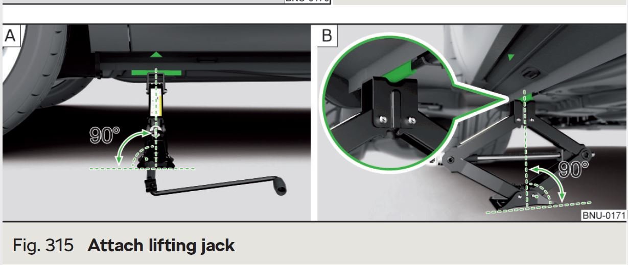

Looks like things have changed. There is no bias on the Karoq. The images in the manual suggest that the seam takes the whole load...
Yes I had a look at this this evening.  I also had a look at the emergency jack in the boot and there is definately no bias. The diagram does show the seam bearing the load. Don't know if this means it has to.

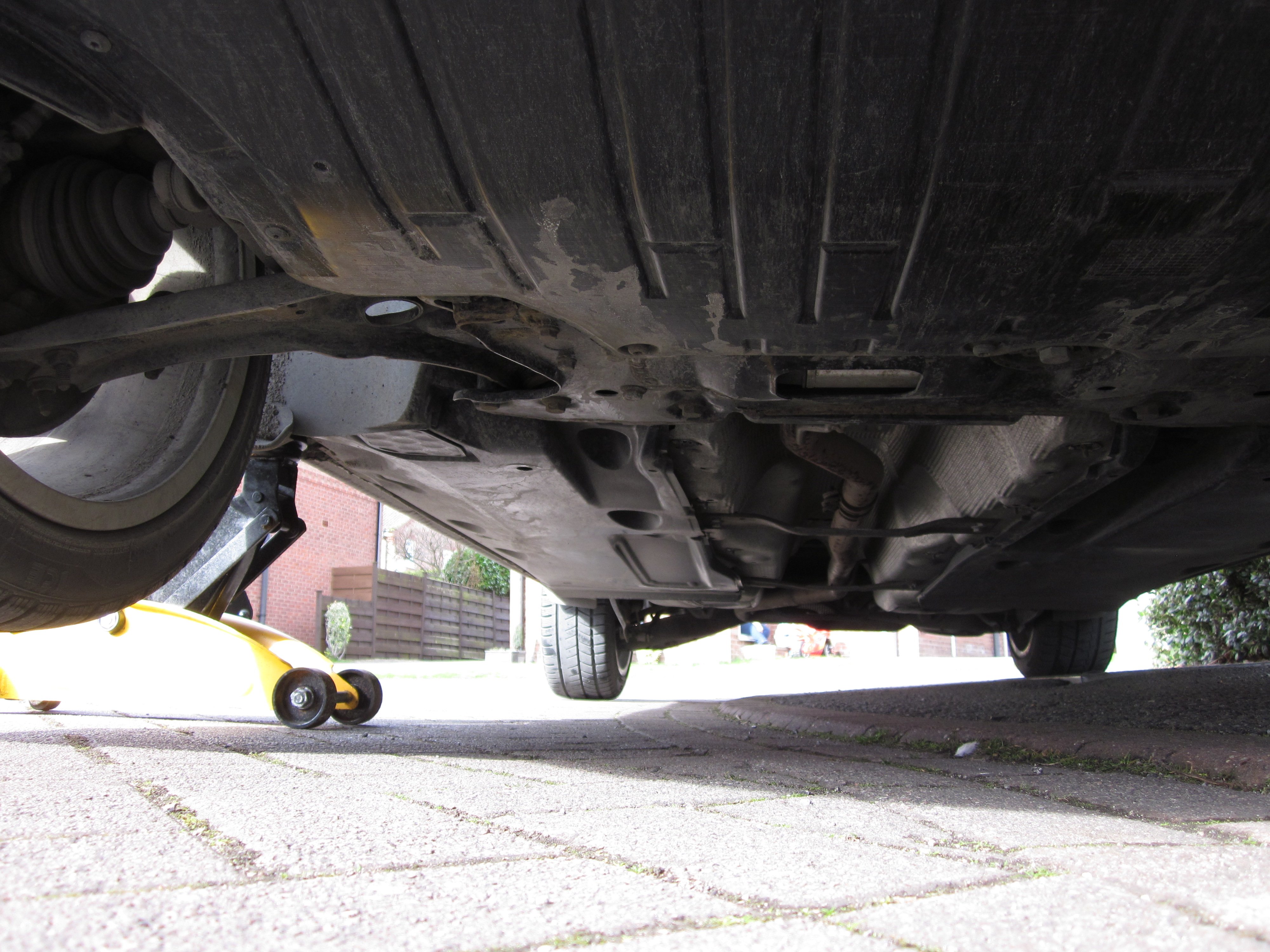

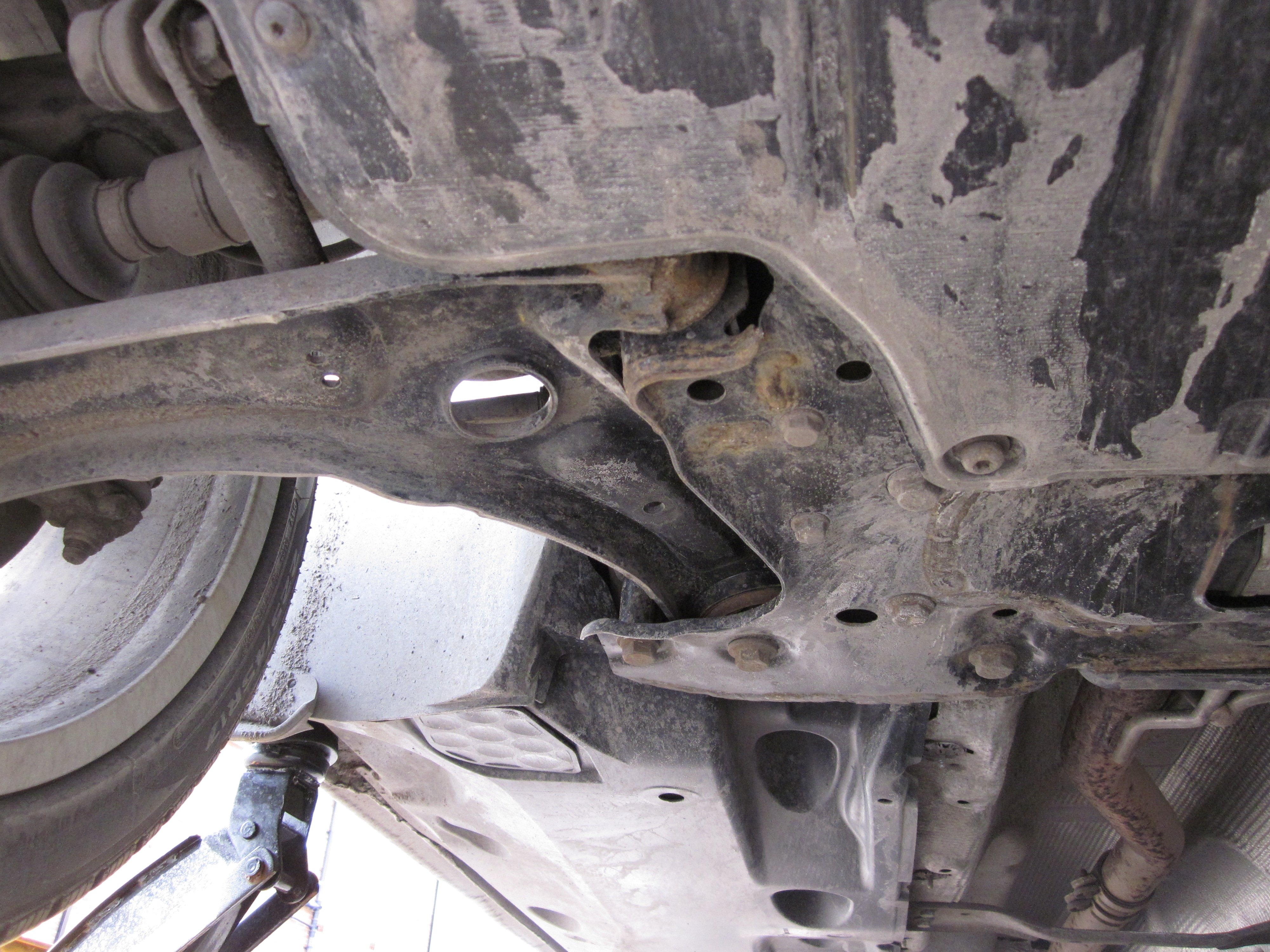

If you have a rubber pad and a trolly jack and are on a flat solid surface/ground that gives you the opportunity to access any number of suitable points on the chassis and suspension to jack the vehicle up ,as the scissor jack is designed for roadside emergencies using the sill.having owned some oldish cars which tended to have rusted out sills this is a jacking point I would never use to jack the car up.

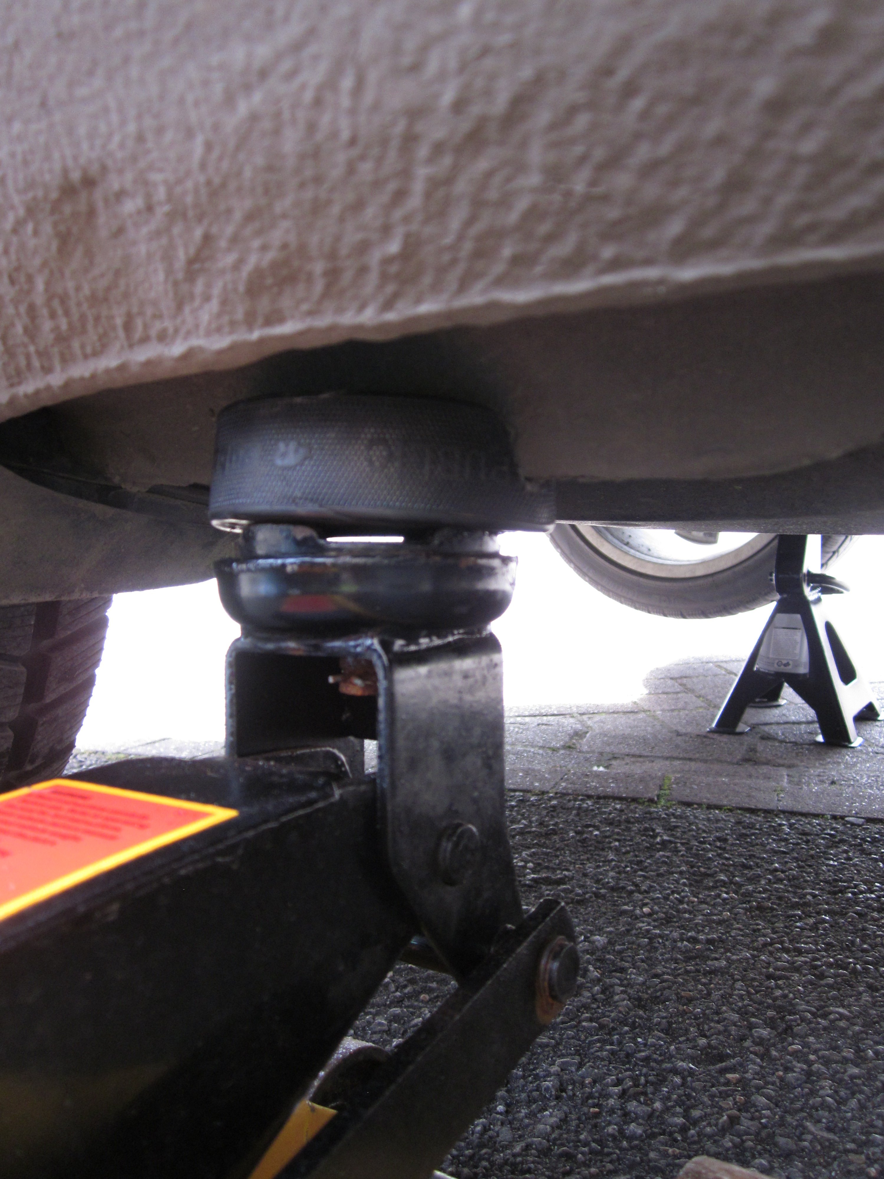

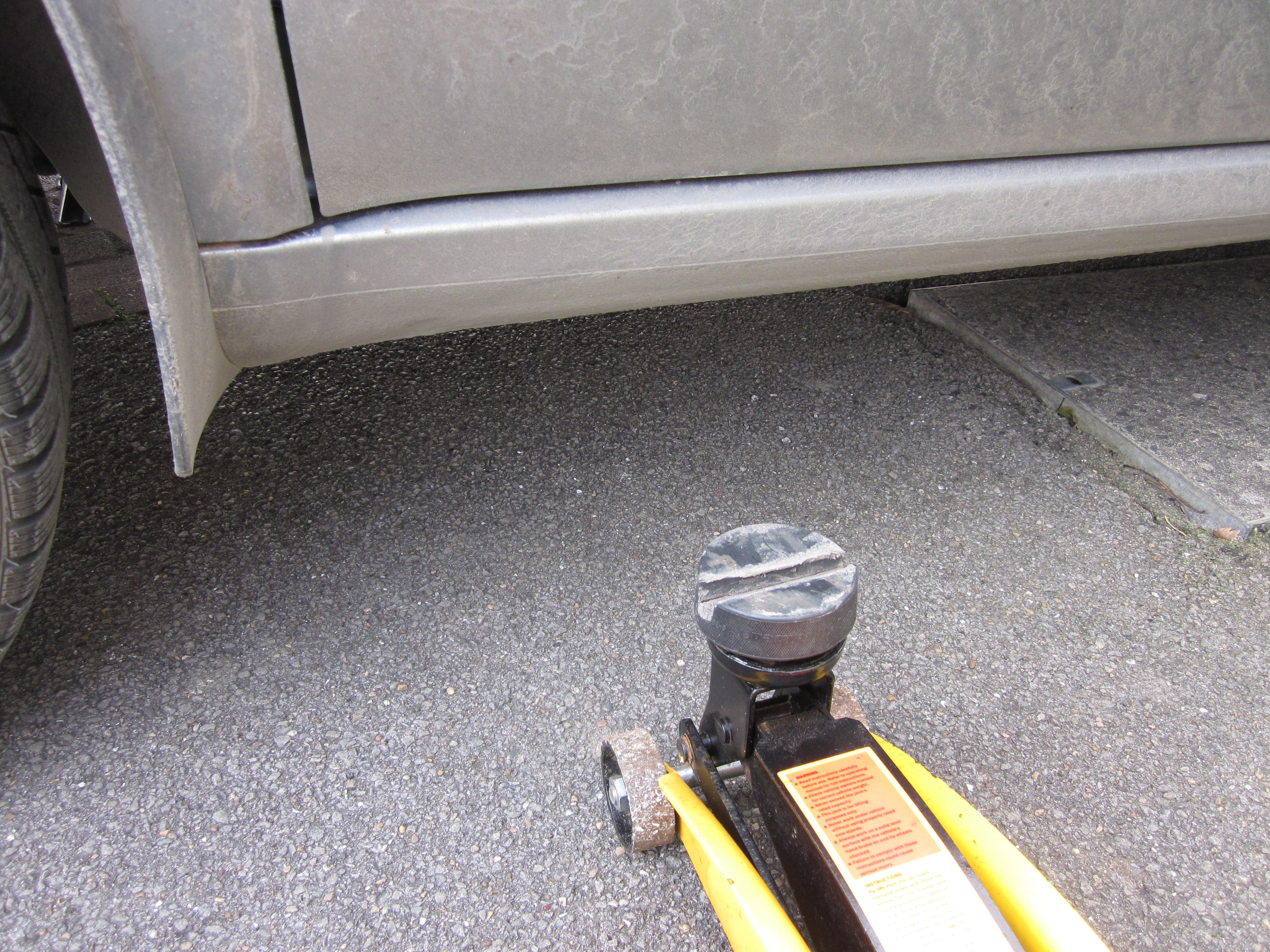

19 hours ago, silver1011 said:
I bought a couple of hockey pucks off eBay and cut my own groove in them to match the sill...
Loads on eBay, some are even pre-cut for you...
I’ve been looking at this picture and it makes me cringe thare is no problem with using a puck but there’s not enough souport from the steal cup on that jack your better of with a flat pad on your jack
 sorry to be all doom and gloom
"Support" for the puck or support for the car?
Worked a treat for years. Once the jack has taken the weight of the car and compressed the puck it's going no where...

I too have used a puck for many years. It is a standard un-cut one.
My jack cup is much larger than the one above and the puck sits very centrally
The puck compresses and it seems to work perfectly
I think what a Patrolman was saying is not the use of a puck but the fact it’s balanced on the cup of the jack rather than sat within it.
I have a slotted puck left over from when I had my Octavia and it was good for jacking up using the sill. It was deeper than the sill seam so the weight was taken the chassis platform and sill but never damaged either.
The pucks are too hard to use anywhere else though as there is little deformation to the surface so you get little contact. I use a Hilka jack pad after the original one became too damaged. The Hilka one fits nearly all jack cups as it will sit within the larger ones or over the smaller and is kept secure with multiple size recesses so the small cup sit within it.
