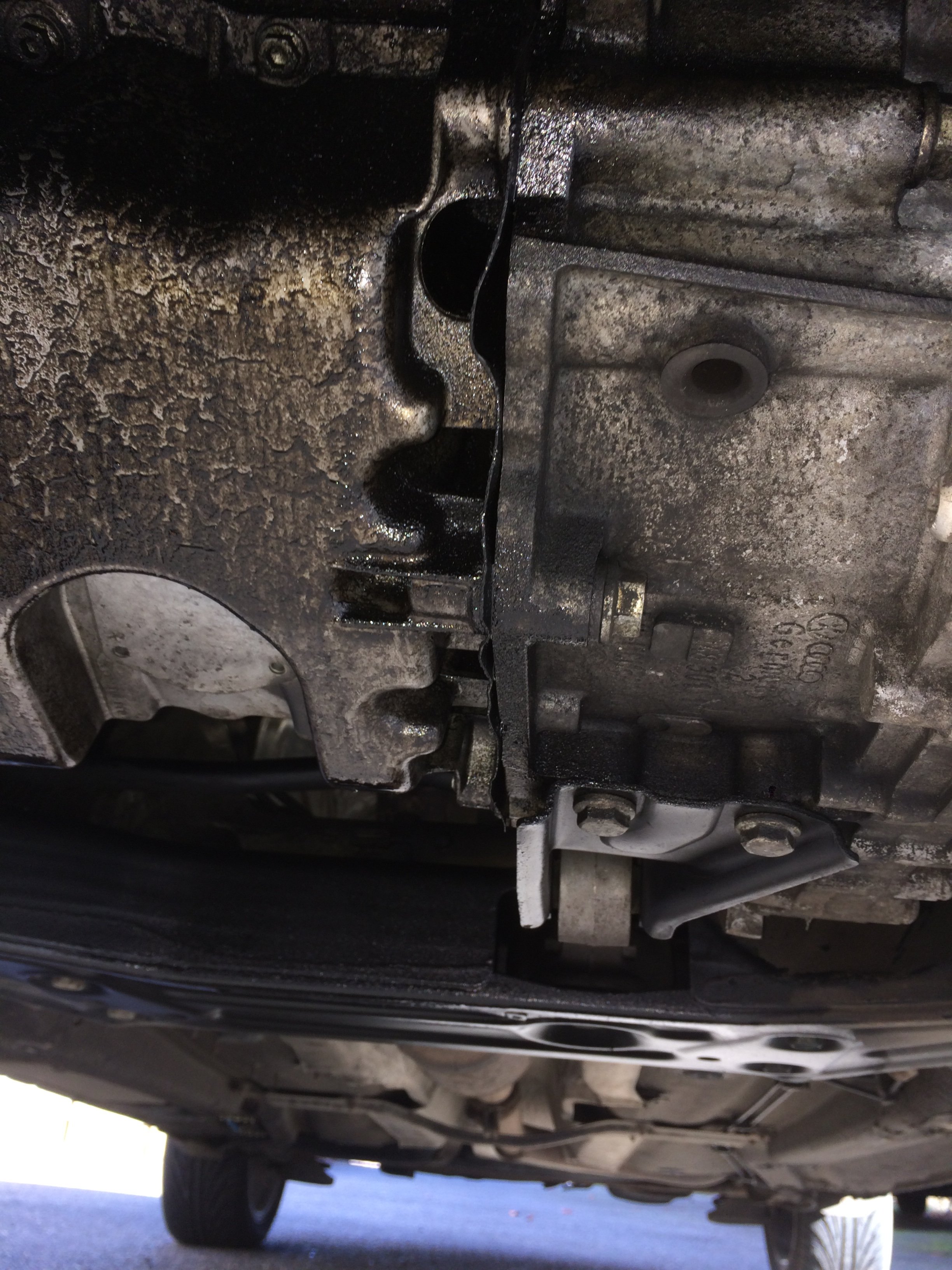

I have some strange squeaking noises when I slip the clutch in some of the gears. I had the gearbox oil changed to no avail; so I thought I'd just live with the noise.

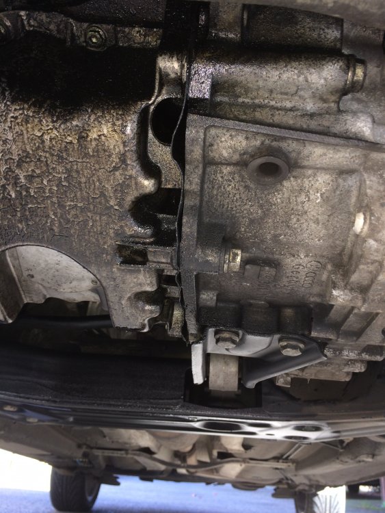

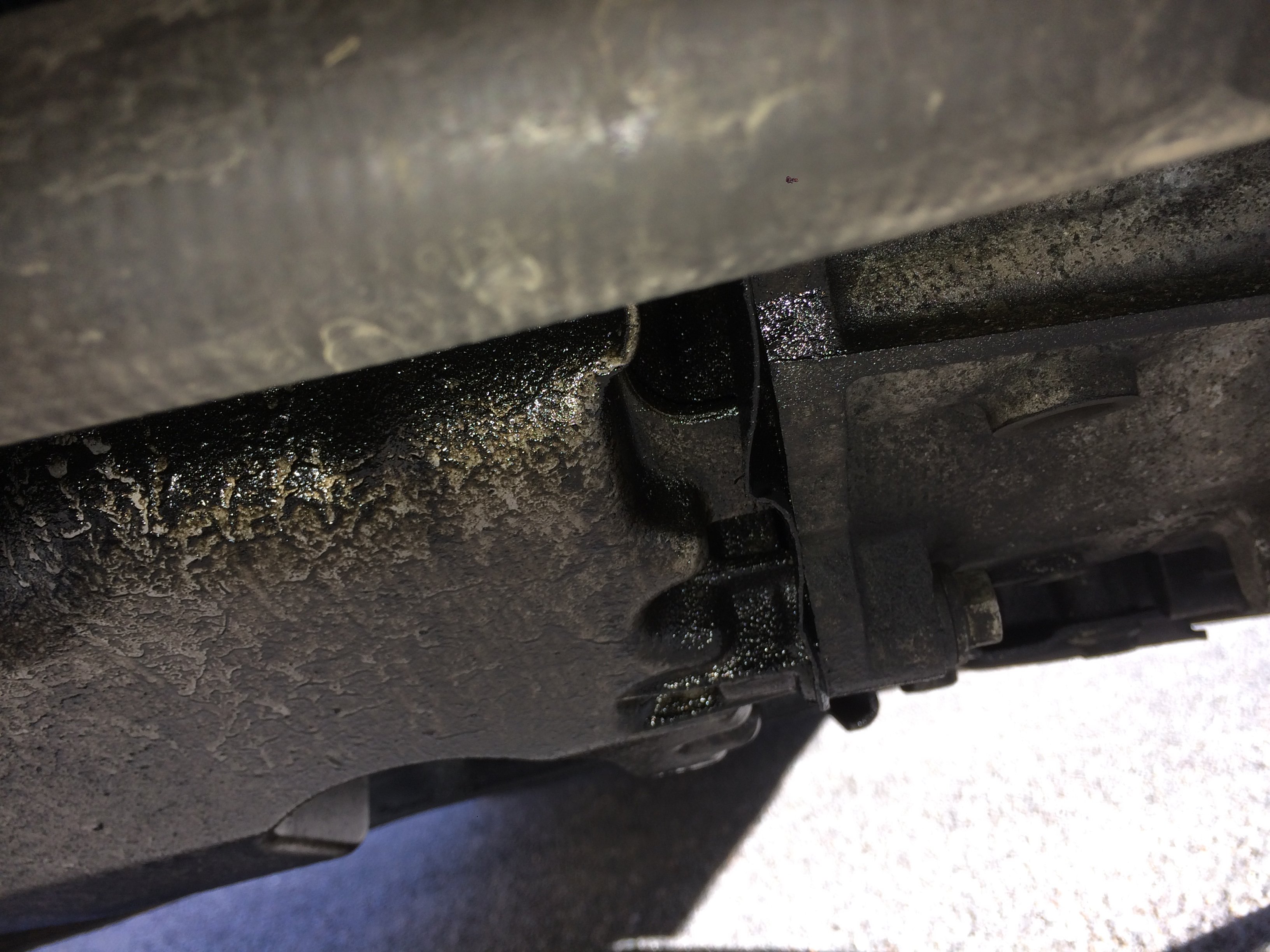

Today I tested some car ramps and saw this: what looks to me like some kind of gasket (I'm not very mechanically-inclined).
Does this look normal? Could this be causing the noises?
Cheers!

Appears to be item 27 here: https://skoda.7zap.com/en/cz/fabia/fab/2006-453/1/103-103015/
"Spacer plate".
Won't be intended as a seal, because there shouldn't be anything to seal in between the gearbox and the engine block. Any oil in there is either leaking out of the engine or the gearbox into the flywheel/clutch area.  There's oil all over the sump though, so first step is to clean it all up in order to see where it reappears from.
May be nothing to do with the noise.

Any idea why the spacer is warped?
Edited by ScaredSheetless
No sign of clutch slip, as I understand. But sometimes (usually when the engine is hot after a long journey) there is a metallic squeal when I slip the clutch gently from 1st into 2nd.
They probably bent the spacer when they replaced the clutch. I wouldn't have thought it would really affect anything.
Yes, the clumsy prat who last had the gearbox off did it.
Some parts of it probably stuck to the gearbox, other parts to the block. As the gearbox was separated from the block, it stayed stuck long enough to stretch and bend bits?

Which makes me wonder if the thrust bearing was misaligned when the garage re-assembled things. Were any of the staff wearing stetsons or chaps? ;)

I'm wondering if the problems have been caused by the garage who did the clutch work, and the subsequent statements were them covering up.

I think it already has. Aside from the oil weep, a clutch should be silent in operation.
