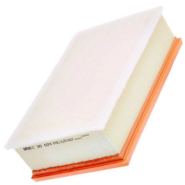

Apologies if this has already been asked but it's time for a service & I've always got service parts from euro car parts for previous cars, but they don't seem to stock air filters for the 1.4 diesel. There are various air filters on amazon but I'm not sure if it's the right filter, the car in question is a 2015 fabia with the higher power 1.4 diesel engine.

Turns out the filters that ECP are selling are the wrong size & shape filters, I didn't know until the mechanic servicing my car took my old filter out & discovered the new one was too big.
2 sizes for fabia mk1, 2 and 3 the smaller one is for up to FL 2010 and the filter goes in a plastic carrying frame before fitting. The later ones are larger and fit directly without the frame. If you simply discard the frame, the latest larger one fits all fabias. Thats basically what skoda did starting in 2010 FL.
So if the replacement was larger, then someone may have previously fitted an old style (cheaper) filter and used an old frame for it.

The filter that's currently in it is identical to the one listed on mann filter, but the new one I bought from ECP is very different & the listed dimensions are also different.

Thanks I found it when I searched for the oem part number, the genuine filter looks a lot like a mann filter
Thats because it probably is, Mann is one of about 3 or 4 OE suppliers of filters to VAG.
