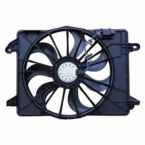

I have a 1.5 SE L dsg. Reading the above looks like the only change is “Holder+Fan”, anyone know what this is?
tom
It will be somthing like this fits in front of radiator
image.png.25605c4030dd7d9224137261d62eca50.pnglibrary picture

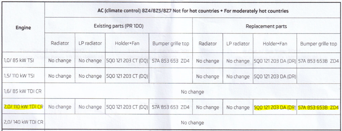

  • Does this help? - its Skoda's crib sheet on which engines require cooling mods for retro fitting a tow bar.
  • Given the table from Skoda breaks out the requirement for the modifications between hot countries and not hot countries, does suggest the changes are needed in an attempt to control engine and / or ge
Thanks
tom

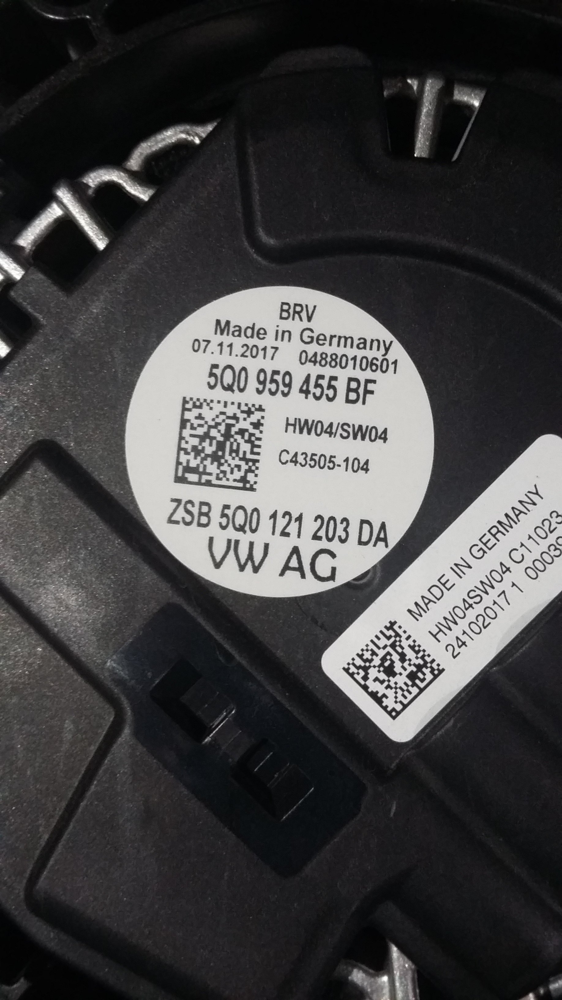

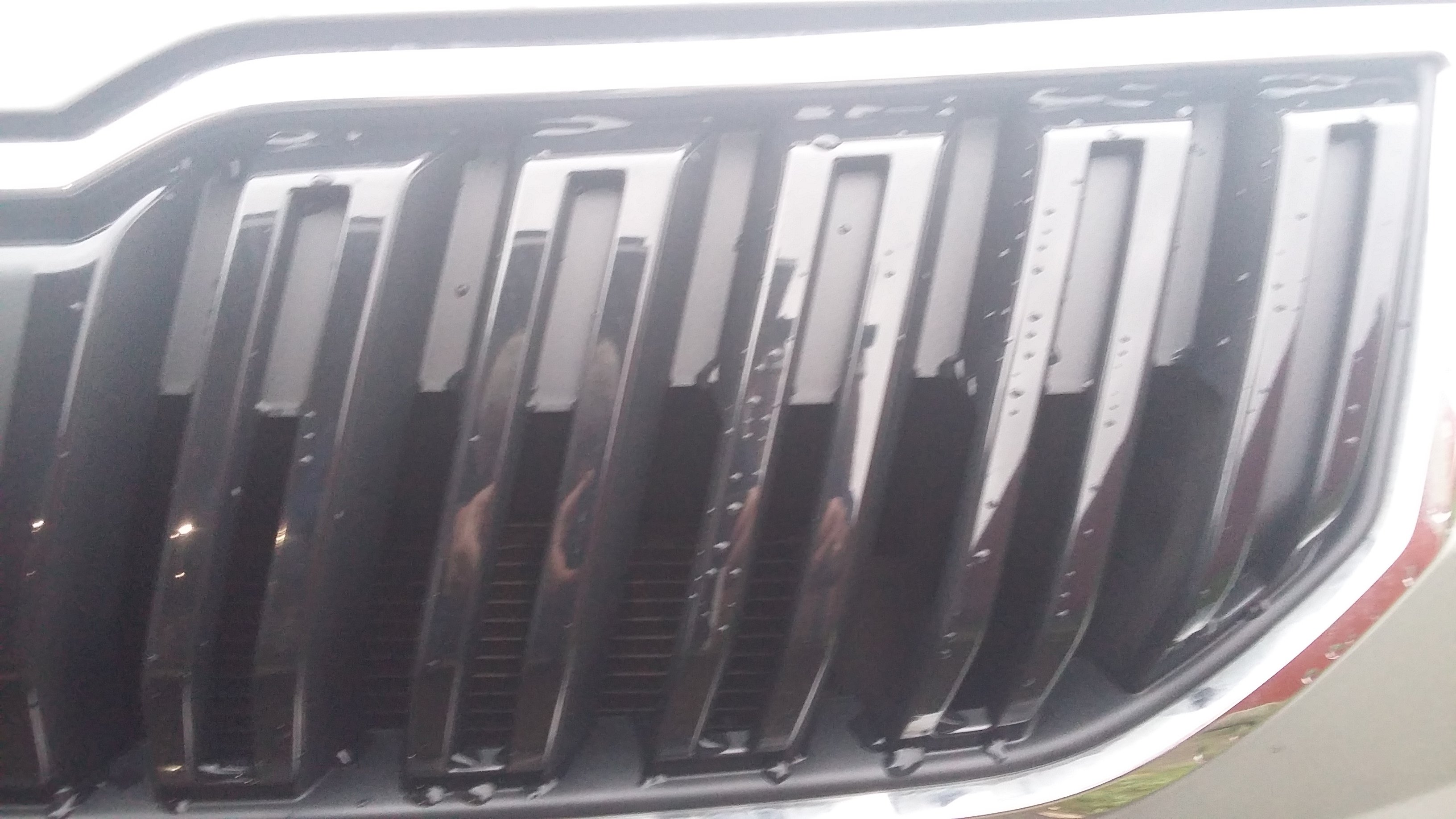

This is what a grill with cooling mods looks like - the vertical slots are about 4" tall (not 6" as I said above). They are about 1" for the standard grill.
On the fan the 'DA' is the significant part of the part number. Obviously these are for the 2.0 TDI - part numbers might differ for other engines.
I'm planning on just fitting the grill at the moment my caravan is light weight so I will see how it goes
Not sure about the above.  My SE L without towbar prep has a grill just like the above. I can get four fingers easily in the slots.

But if you look at the crib sheet above the 1.5 TSI doesn't require a new grill, just the fan.

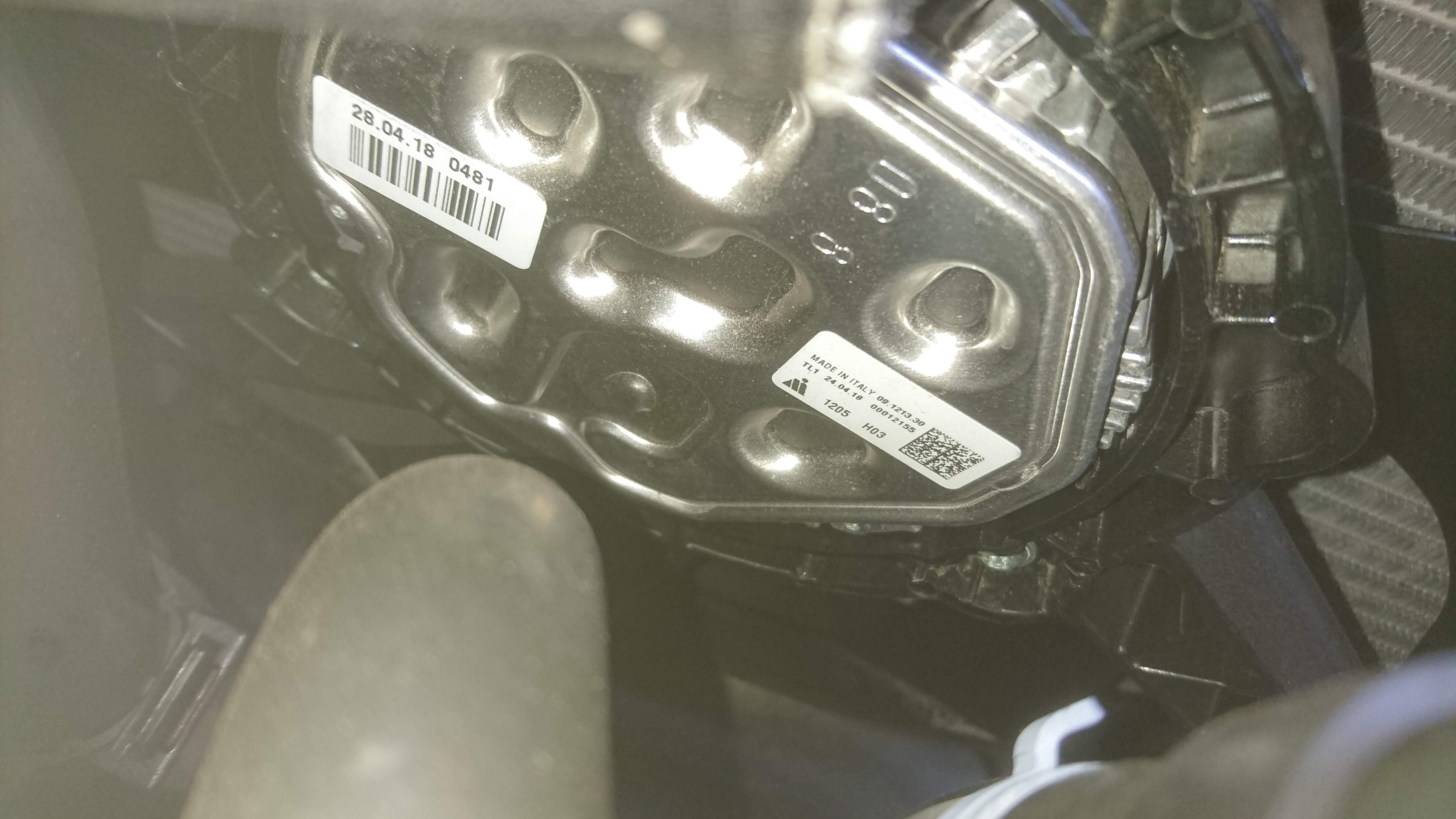

Is there a code on the data sticker in the boot to say you have towbar prep as mine does not have a black cover on the fan it just steal with two stickers on with no code
Edited by skoda1982
Funnily enough I don't have a data sticker in the boot or service book (I looked when I bought the car), as Skoda have all that data. If you ring Skoda Customer Services and give them your VIN they can tell you exactly what your car has.

Given the table from Skoda breaks out the requirement for the modifications between hot countries and not hot countries, does suggest the changes are needed in an attempt to control engine and / or gearbox temperatures.
For the UK (i.e. not for hot countries), and given you're only towing a small trailer or bike rack then I'd be inclined to suggest that fitting an aftermarket towbar, without also retrofitting the fan, holder and grill, you won't see any issues...
In hot countries the cooling mods are already done, regardless of whether you have tow bar prep.
You need to remember that Skoda will take some convincing that you did only carry/tow light things and therefore didn't need cooling upgrades.
