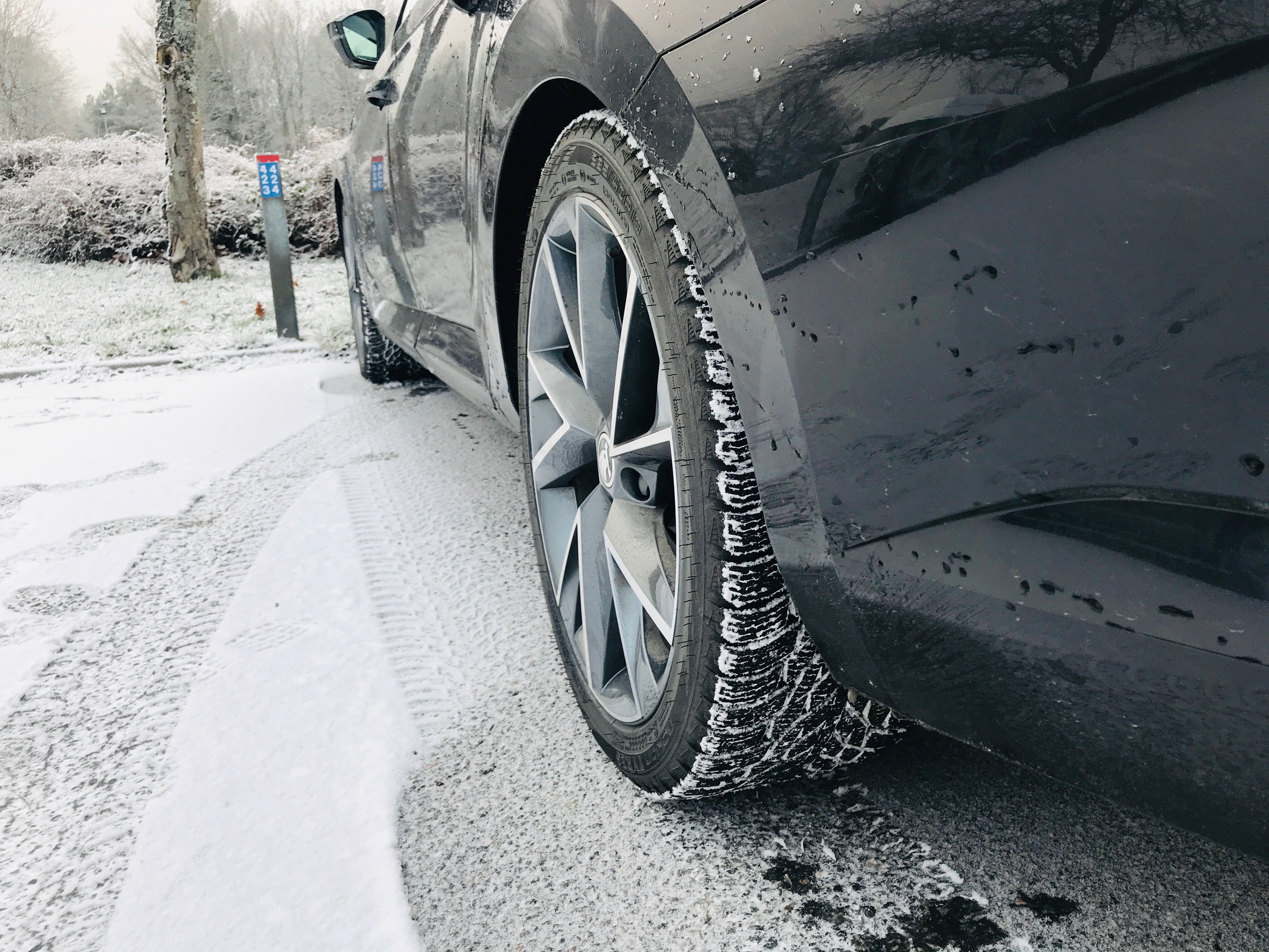

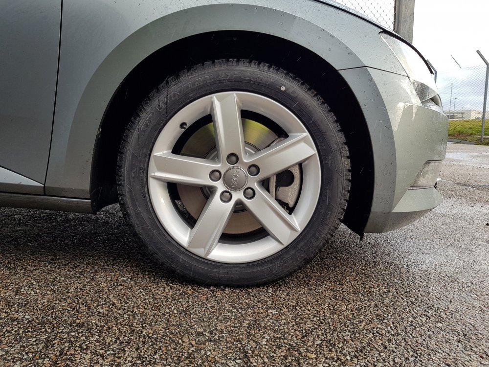

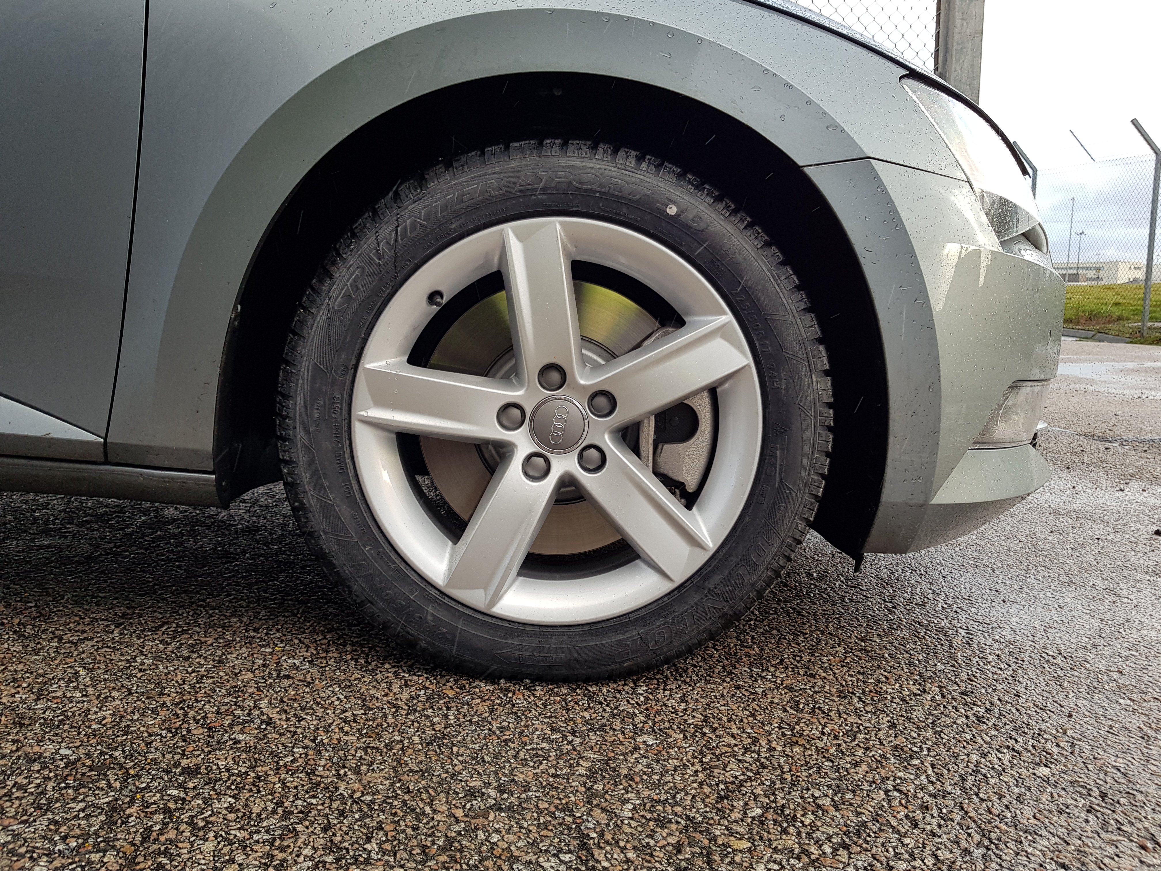

Can anyone post pictures of 17" alloys on the car. Debating whether to get all season tyres with original wheels or get myself the winter wheel /tyre package. On the Mr Winter wheel site now.  Living in the Uk (Scotland) the weather does not get that bad that making the choice between function and styling is so important . Having just received my new 280 sportline im loathed to dump those stunning 19" wheels . Terrible I know....

Vredestein Quatrac 5’s
I don't think that is terrible..... the black 17" alloy wheels I've ordered are certainly not going to improve the looks of mine either, and that was a consideration - hence the reason I didn't save a few hundred quid and opt for black painted steel ones. I drive down to the Alps a fair bit, so do legally need winter tyres, but my main consideration is that winter tyres are miles safer - not just in the snow & ice, but also in the generally wet, ****ty winter weather we get over here. If you've not driven on them before I think you'll be surprised.

@Macsamillion I've got the same 17s as @Bud on my 280.
I have the 18" Pegasus as standard on my SEL. The 17s still look good! The caliper clearance is quite comical though :D
