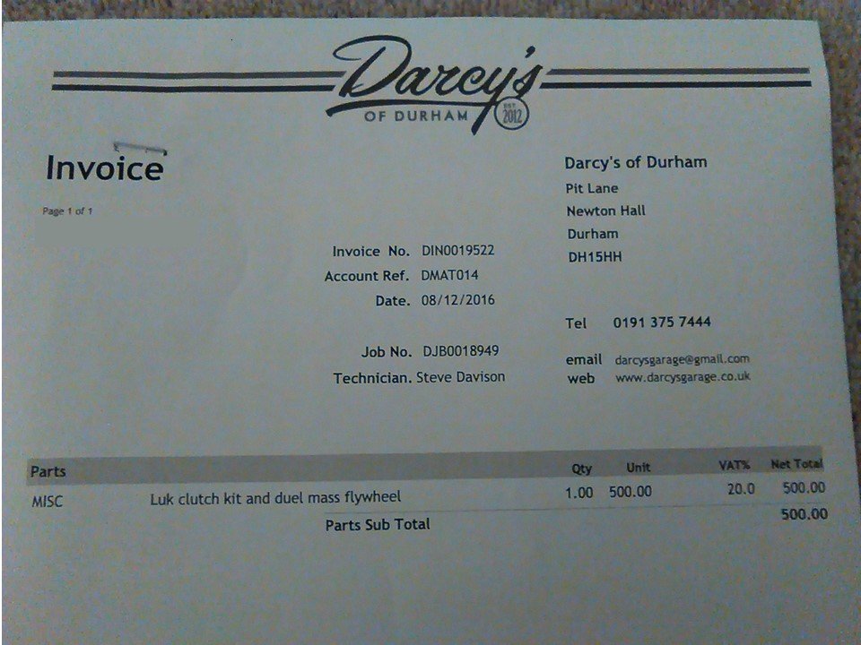

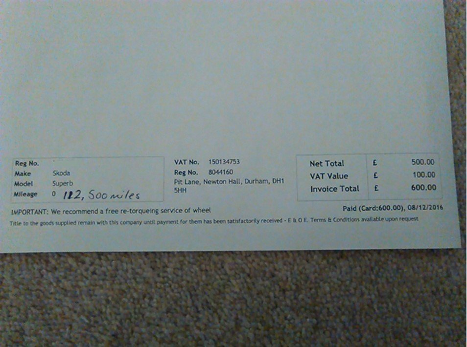

Where are you based?
I paid £600 for a LUK clutch and flywheel, fitted, for £600 inc. VAT from Darcy's of Durham...

Wow thats a good deal you got there! :thumbup:

OP has a DSG, not a manual.
I strongly suspect that this was for a manual box. The parts alone for the DSG box cost more than that.
My local dealer has quoted me just a shade under £2000 for the job. They reckon it's a 7 hour job, which I can easily believe.

It is, I'm not brave enough to run a DSG out of warranty.
