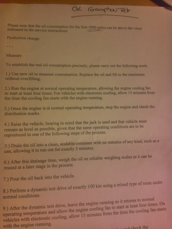

VW Group tell you or recommend to check the oil at Operating Temperature so not at 0*C or lower.
So they are saying see where 4 litres or 3.6 litres or 2.8 litres is on the dipstick at 90-100+ *C.
That means checking the volume of oil maybe 80*C hotter if it is at 10*oC in the cold engine.
Only check the 1.2 l 44kW engine with cold oil and it has a 2.8 litre oil capacity.
For Oil consumption tests the oil drained before a Test starts and after is weighed and not measured by volume so that they can tell or nearly tell the difference of oil lost.  They (VW) give the weight of a litre of engine oil as 856 grams @ 15*oC.

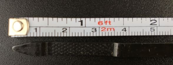

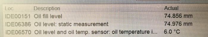

Mine is fairly consistent it seems.
At stone cold VCDS read 74.856 mm and on the dipstick from first wipe this was nearly to the top of the hashed pattern. Level is OK in my book.

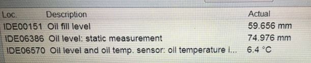

During engine running the level seemed to drop to 59.656 mm on VCDS. To be expected, its being thrown around the engine.

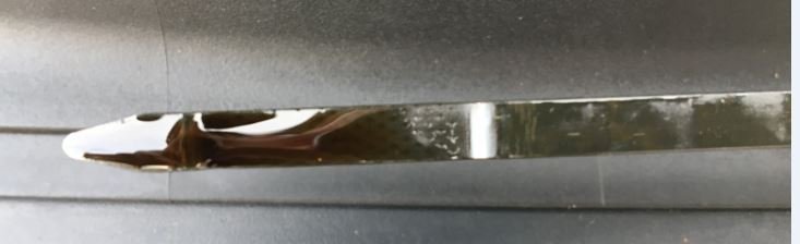

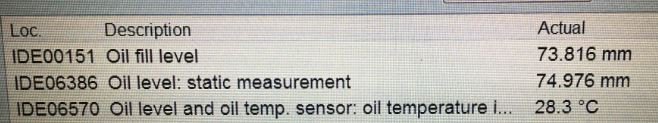

Then after being used a bit (not fully hot sadly) and rested for a good 15 minutes the level was back up at 73.816 mm and on the dipstick, this was again near the max. Oil settled but still warm.

Top work, shame you didn't take data points at 1, 5 and 10 minutes  after switch off though, could I encourage you to do some more? When you see my embarrassingly poor photos shortly, I hope you'll see that (my) peak levels are seen on the dipstick between 2 and 8 minutes after shutdown, several millimetres higher than cold.
