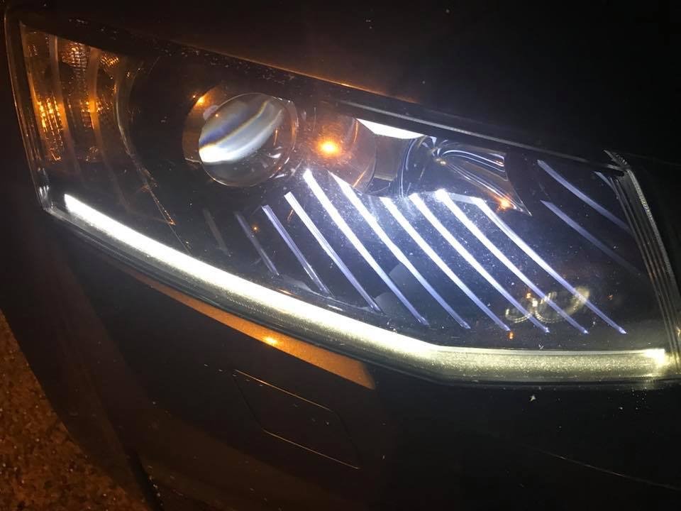

Even the bulb out warning came on when one of the old LEDs failed. :)
LEDs fitted:
Edited by aki78
