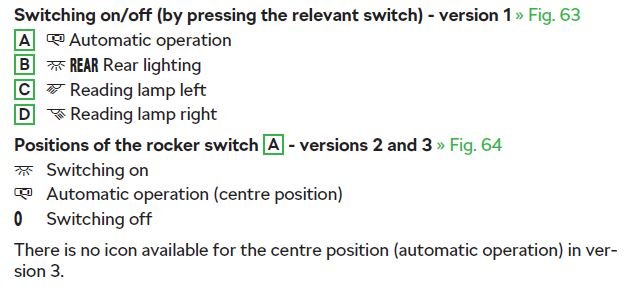

Eureka !! I too have been narked that the interior lights don't come on when unlocking the car, or when switching off ( I have KESSY system). Having studied the manual, I discovered there are 3 versions of the interior light switch arrangements, all a little confusing, but I ventured outside last night in the gusty wet weather with a wee torch & found a switch alongside the lights that I'd not seen before ( only had the Karoq 4 months !!). Pressing it once activated things so I now have lighting inside when I switch off, and that nice cosy glow as all the interior lights illuminate when unlocking from the outside, hence my opening "Eureka"  !

Another unknown switch? Is this down near the headlight rotary knob-thingy?
No, to the left of the actual interior lights.
I've not noticed an extra switch, I have a switch for each of the two individual light, and a central 3-position switch in the middle
Where is this mysterious button?

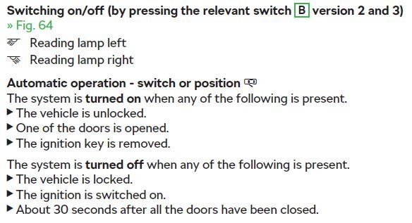

I have version 3 in those pictures.... Interesting that it says the lights will activate if "The ignition key is removed"... but we have no ignition key. All that gadgetry and technology, and no one thought to run a wire from the stop button to the lights!

In my car it's Button A in the top picture (in Variant 1) - it has the tiny icon of a car with it's door ajar, & when pressed activates the automatic interior lights on/off function. It can be left alone after that, no need to touch it again unless you want the feature cancelled.

Button 'A' results in the interior lights coming on when...
- The vehicle is unlocked
- One of the doors is opened
- The ignition key is removed
No mention of turning off the ignition via KESSY.
