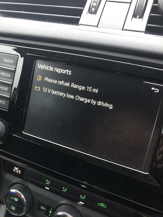

For a few days now my cars struggled to start, I thought it was down to the colder mornings.
Today was the worst and after driving less than a mile to drop daughter at nursery it wouldn’t start again.
”12v Battery Low. charge by driving”
Car has a years warranty left. Called Skoda Assist. Chap said they can’t make them quick enough, problem happens all the time.
For anyone else looking for the answer - It’s being replaced and coded under warranty.
Octavia Mk3 2016.

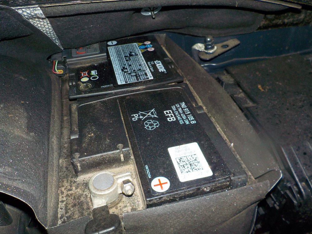

Modern skoda cars with stop/start are configured as micro hybrids .
As such the battery runs with typically 70%-80% charge. With the demands of frequent stop/start, energy recovery and load shedding, the battery is placed under far greater strain than was the case years ago when it was used basically for starting only.
Specially constructed batteries, EFB and AGM help, but in the end, running any lead acid battery long term at less than full charge leads to deterioration via irreversible sulphation and stratification, or to you and me, a short life.
A way to help stop an early demise is to fully charge the battery using a good quality external smart charger regularly. Turning the stop/start system off will also help stop deep discharge of the batteries, a quick way to kill lead acid batteries.
Unfortunately, this is the price we pay for EU/ECO regulations.

OEM spec batteries are designed to be the smallest possible for the vehicle requirements and still deliver 10 years of life on a 95th percentile useage pattern. The battery used by OEM's is tested to their exact specifications for construction, weight, deep cycling, and pass 600+ discharge cycles for AGM. Not many Aftermarket batteries can meet the same criteria except those from the top named companies.

VAG fits EFB & the smallest it can get away with..& the stop start function kills them off easier anyway....
Fit bigger case/capacity & AGM & use a trickle charger in between times..
Mind you I was coding a 17 plate Superb L&K (all options on it) that had a huge AGM from factory!!...so VAG can & do fit decent stuff...but only to the top spec...
