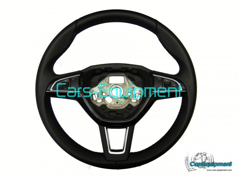

I'd like to remove multi function buttons as on photo one, from steering wheel from picture 2. Any idea how to do it? I can't see any screws and the plastic cover feels fragile, do not want to push too much.

AFAIK, you just pull the glossy plastic surround away and it reveals the screws for the buttons. I’ve never had to try and do it on mine, but I might have to when I change the steering wheel for a new one soon and I imagine it’ll probably be fragile.
Ok, thank you I will try that.
It was connected with fragile, plastic bolts. I used screw driver to go around it and managed to pull the plastic panel.
