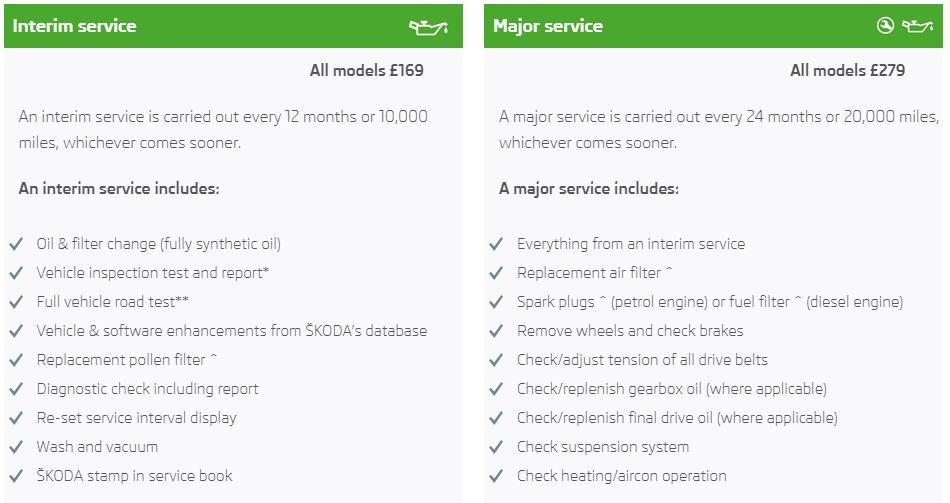

To keep it simple there are two different types of service interval to choose from...
1) Fixed (interim) - 10,000 miles, or 12 months, whichever is reached first. Suitable for low annual mileage, arduous conditions.
2) Variable (major) - Up to 20,000 miles or 24 months. The car monitors your driving style and decides for itself when it needs a service. Suitable for high annual mileage.
All Octavia models destined for the UK are set at the factory to Variable. The dealer should ask you which you prefer and change it accordingly before you collect the car.
A fixed service is £169. A variable service is £279...
As mentioned, if you press the 'Service' button in the infotainment system the car will tell you how many days and miles are left before it is due its next service.
I'm not sure you're quite correct with the statement 'Fixed is £169, Variable is £279' - the picture you've posted is for fixed service intervals only but on an alternating basis, so on the fixed regime you'd be servicing Interim, Major, Interim, Major, Interim, Major etc. etc.
Variable is a bit more of a mystery and as I understand it effectively they tell you what the car needs based on whatever mileage you happen to be on at the time, with the price quoted at the time based on those requirements.

The published pricing only applies to cars over 3 years old and on the fixed servicing regime. It also requires dealer participation (most do). Dealers are free to charge lower but not higher if a participant in the fixed price servicing scheme.

Skoda now advertise the interim at £159 and major still £279.
Do they charge extra if the car needs say, a pollen filter, or air filter ?
The description is unclear as it lists all the things that are part of the service, implying they are included in the price, but with little stars on some things which will only be replaced if required.
Included in the price but price not reduced generally if not required.
On the 3-10 year olds the £169 or £279 gets charged even if parts not replaced.
Odd that no parts, no labour checking or changing parts and no VAT on the parts not bought or supplied and it costs the same.
The Wash & Vacuum can take longer than the Service and the Roadtest and Diagnostic checks seems to take less importance with some Dealerships.
People trust that a 'Service' ensures a safe car, good inspections and really it is a Oil Service and maybe stuff done and maybe not...
Money for old rope but odd that regardless of a Citigo or a Superb the profits must be variable.
