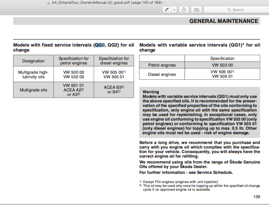

attached is a screenshot from the manual..

@Jamesgil - In your original post you state it's a 1.9Tdi90; that is enough to tell us it's not a PD (those are 130bhp or above).
You don't need an anti-foaming oil unless you have a PD, and there's no point in using a long life (aka variable service) oil with your stated change regime.

Sorry - missed that in an earlier post - in which case you don't need an anti foaming oil as it's an old mechanical injection engine - it's been a while since I've seen a Tdi90. I didn't realise this engine was still in cars by 2006.
If I remember correctly these engine respond well to a new set of injectors after about 150,000 miles (so as the OP's mileage is only 155km it's ok for a while) as the injectors wear giving a poor spray pattern that drops performance and economy and can cause wear due to bore wash. Other than that they slog on forever.

To be honest that engine is less fussy compared to the PD engine however I used to rate Castrol Magnatec semi synthetic for that breed of engine.

As you're in the Dominican republic I'd say a good quality 15/40w oil should be fine for the ALH motor (5/30 for European winters) especially if you can get one thats VW505 or higher rated. the 50x.01 (PD) oils are designed to withstand the injection pump pressures that can literally break the oil molecules. I put 506.01 in mine for 250k miles and changed it every 10k.
Whats more important with TDI engines is to let them idle after a run for a minute before turning them off, this allows the temperature of the oil cooled turbo to drop enough to prevent cooking the oil.
