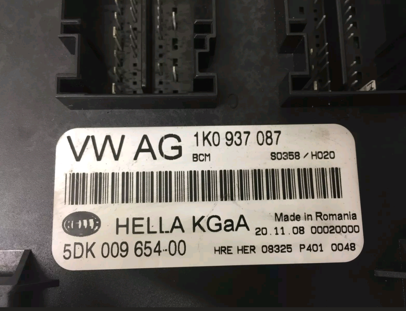

My current BCM is a 1K0 937 085L. I think I need at least a ...086 or above? If so, I have an offer of a 1K0 937 087 for a good price, will this be suitable too? My reckoning says it should be....

The picture i've got doesn't have a character at the end of the part number, any thoughts? (photos attached)
The 087 module came from a 2009 octavia elegance,

That's probably the very first revision that came out so I'd avoid it.
This one is more age appropriate and is probably what they would have fitted at factory if DRL/fogs were spec'ed: https://www.ebay.co.uk/itm/142934251119
It also matches the ones that came in my '61 plate (MY12) Octavia Elegance with factory fitted DRL/fogs :)
