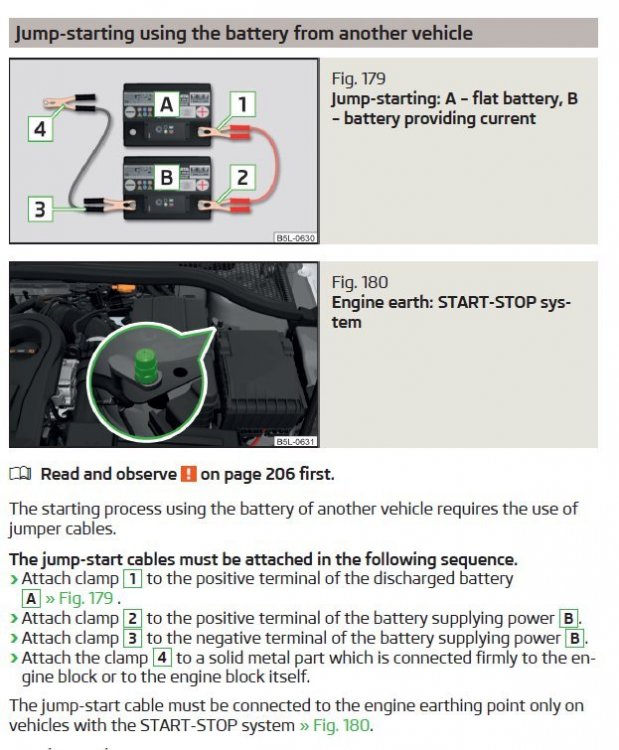

If jump starting cars with start/stop the negative lead must be connected to the nearby post not the battery.
Thanks very much. I must go and have a look for that now!!!

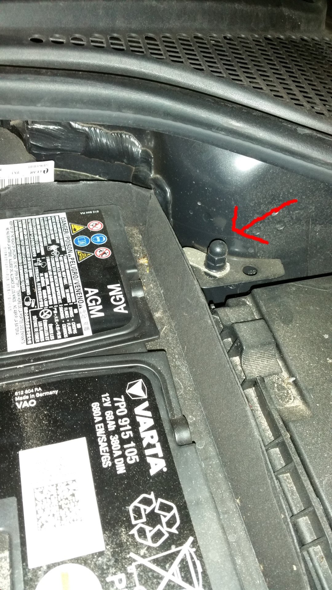

Spent ages looking for something green and the picture in the manual isn't that good for my eyesight.
I think this is it, even if it's not green, as the photo above here is a lot clearer.
It's just green in the photo to show what part you're looking for.
If you look where the arrow is pointing to it's black.
A-ha! You are, of course, correct.
Thanks.
