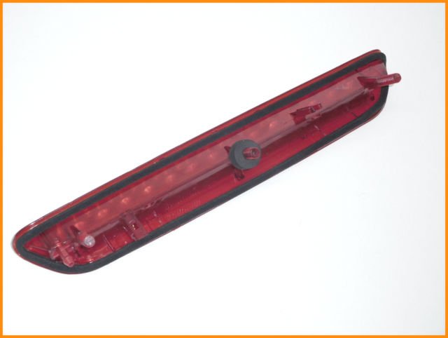

The high level 'third' brake light on the estate is often the cause.
It has a foam / rubber gasket which deteriorates over time.
Pop off the inner plastic boot trim and try a water test, with you sat in the boot and a friend hosing down the tailgate...

Cheers Silver...   I looked at that from the outside over the weekend but didn't get round to removing it to check.
It strikes me that there is too much water for it to be that but definitely worth a closer look - thanks!

So the next stop is the high level light suggested by Silver...   fortunately the interior of the car itself is still dry..
