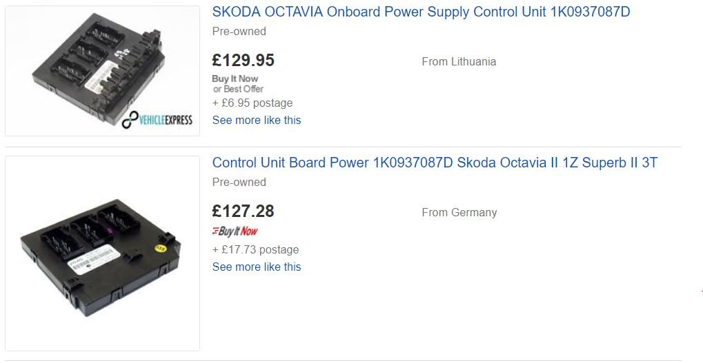

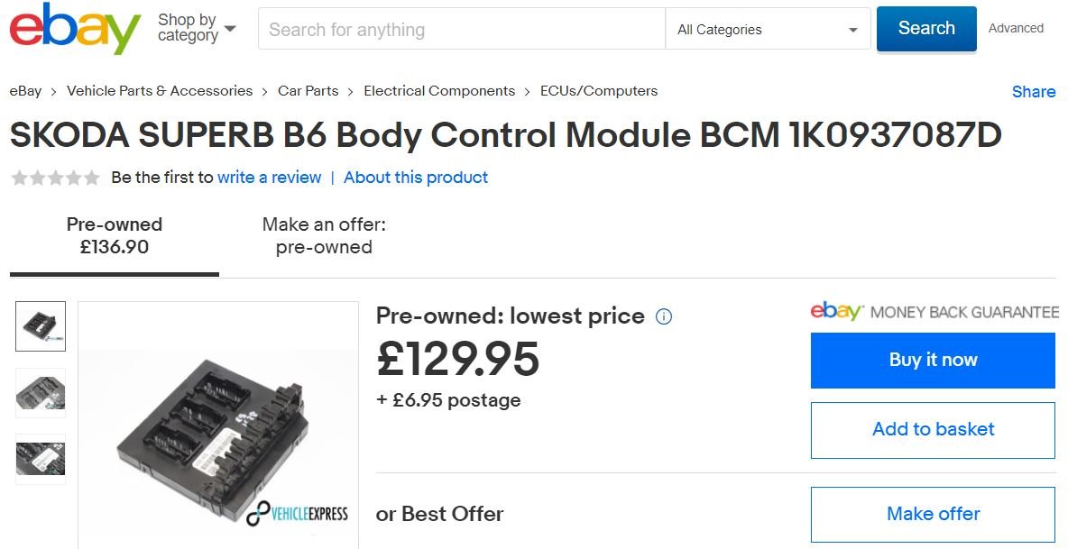

Could probably be fixed by ECU repair companies, but may well be cheaper to get a secondhand one and swap that in?
7 of em on Ebay from £118 second hand to £250ish for a new one with one at £35.
