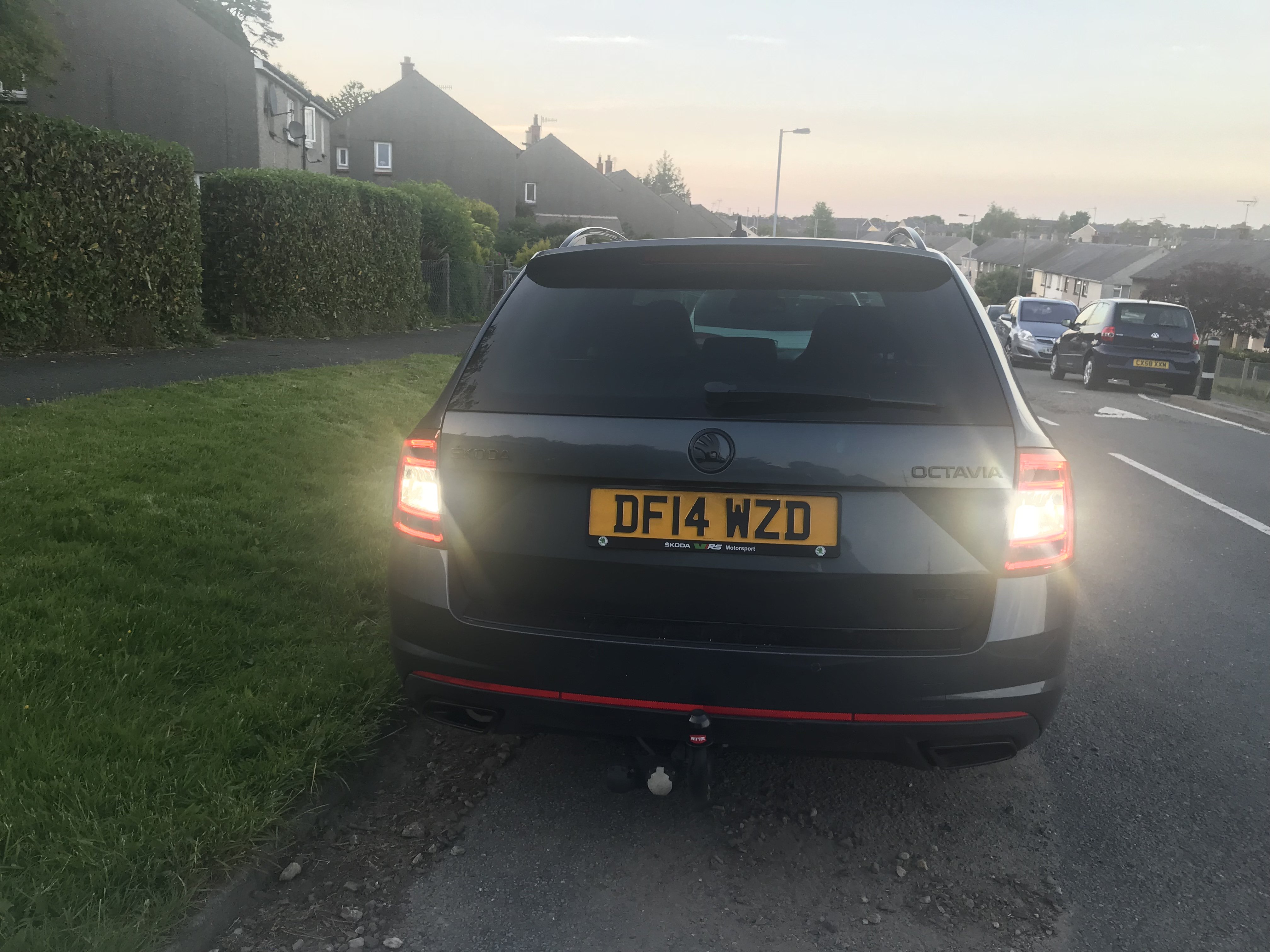

I did however replace the rear indicators. Used these:
https://www.amazon.co.uk/gp/product/B073TCVC4C
Straight swap, no coding. The work excellent and give zero errors.
