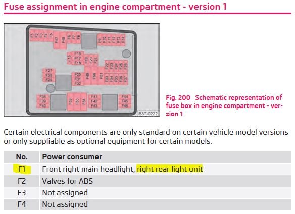

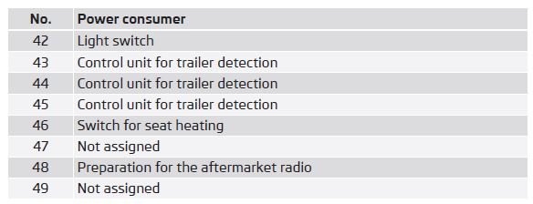

There is nothing obvious listed in the fuse box on the end of the dash...
So perhaps check out the fuse box under the bonnet, it at least mentions 'rear lights'...

it was the near side of the two that had blown... but when taking it out I shorted it... which stopped the other one from working....
I have had a look around the net at it seems that this doesnt have its own fuse....   Will try just fitting new bulbs to see what happens..
