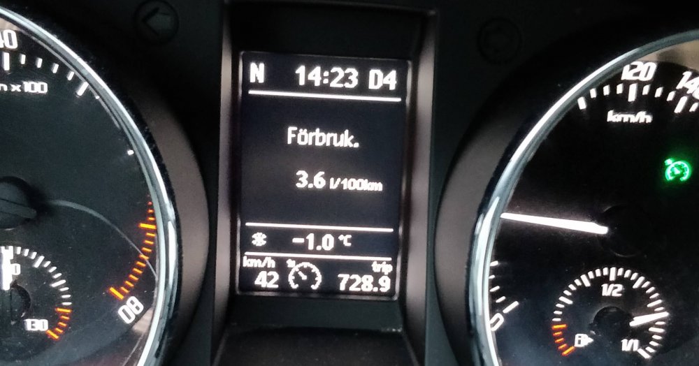

Just activated this, and am very happy with the results (and at the same time a little stumped as to why they didn't sell them like this). The set speed is displayed on the Maxidot, and the turn signal stalk lets me increase/decrease the set speed 1 km/h at the time. In other words, it acts as if it were a Golf. This is a vast improvement over stock, at least to me!
How did you activate this feature?
Using an OBDeleven device, but VCDS works as well. It's there among the available adaptations for the instrument cluster control unit.

Yes. The figure in the bottom left corner is the stored speed in km/h.
The stalk, before the change, did do the speed change. But the single tap merely applied the throttle for as long as the tap lasted; there was no connection making one tap correspond to one km/h. So, 3 really fast taps could amount to just 1 km/h increase. Now I can do 10 fast taps to increase the speed by 10 km/h, and it remembers the number of taps and shows me in numbers which speed I'm trying to maintain.

Yes. That is exactly how it works now, plus it gives out the "wanted speed" in digits.

The stock Yeti cruise control operates "blindly", with no readout of the stored (=wanted) speed.

It's an adaption channel in the instrument cluster, it should be called "Cruise control display" or similar.
The only caveat is the ECU software also needs to support it and most Skoda ECU's don't, it seems to be more of an issue with TDi's rather than petrol engines.

Even if the ECU doesn't support it, the adaption channel should be present in the cluster and nothing bad will happen when it's changed.

enor: Looks like a very helpful mod but a couple of queries if I may
(1) Does the CC symbol & Speed only display when the CC is activated (i,e. does the mileage normally show unless the CC is switched on?)
(2) When the CC is switched on is the vehicle speed still displayed on the centre of the dash as per normal?
Thanks
Yes, and yes.
