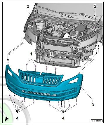

Assuming the Karoq isn't that dissimilar to the Kodiaq, it's a 'bumper-off' job.

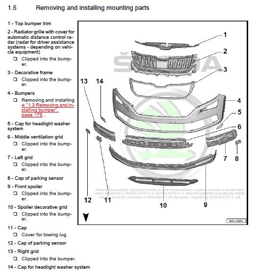

Once off, the centre and two outer parts of the lower grill 'clip in' from the back...
Thanks, looks fairly similar - it's the middle ventilation grid that's gone, maybe the bit to the left as well
