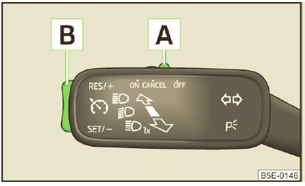

Well that didn't work, on account of the stork having no button on the bottom. The only controls associated with cruise control are the plus/minus rocker switch and the three way on/cancel/off switch on the top.
OK. This is positively the last time I try to help with this one.
The top of the rocker switch resets to your old speed as previously set (70 in your example). The bottom of the rocker switch sets your current speed (40).
If the cruise is already set to, say, 50 the top half raises the speed 1 mph for a short push 5 for a long one, the bottom half reduces the set speed.
Enjoy.
If the OP looks closely at the cruise control it actually says 'RES/+' and 'SET/-' opposite the rocker.
I just leave cruise on permanently and use the controls as camelspyyder says.
I only flick the top button to 'Cancel' and let it flick back to 'On' when I am too lazy to dab the brake pedal to cancel cruise :)
It does indeed. Thankyou both for your patience and humility with my inability to read the instructions!
