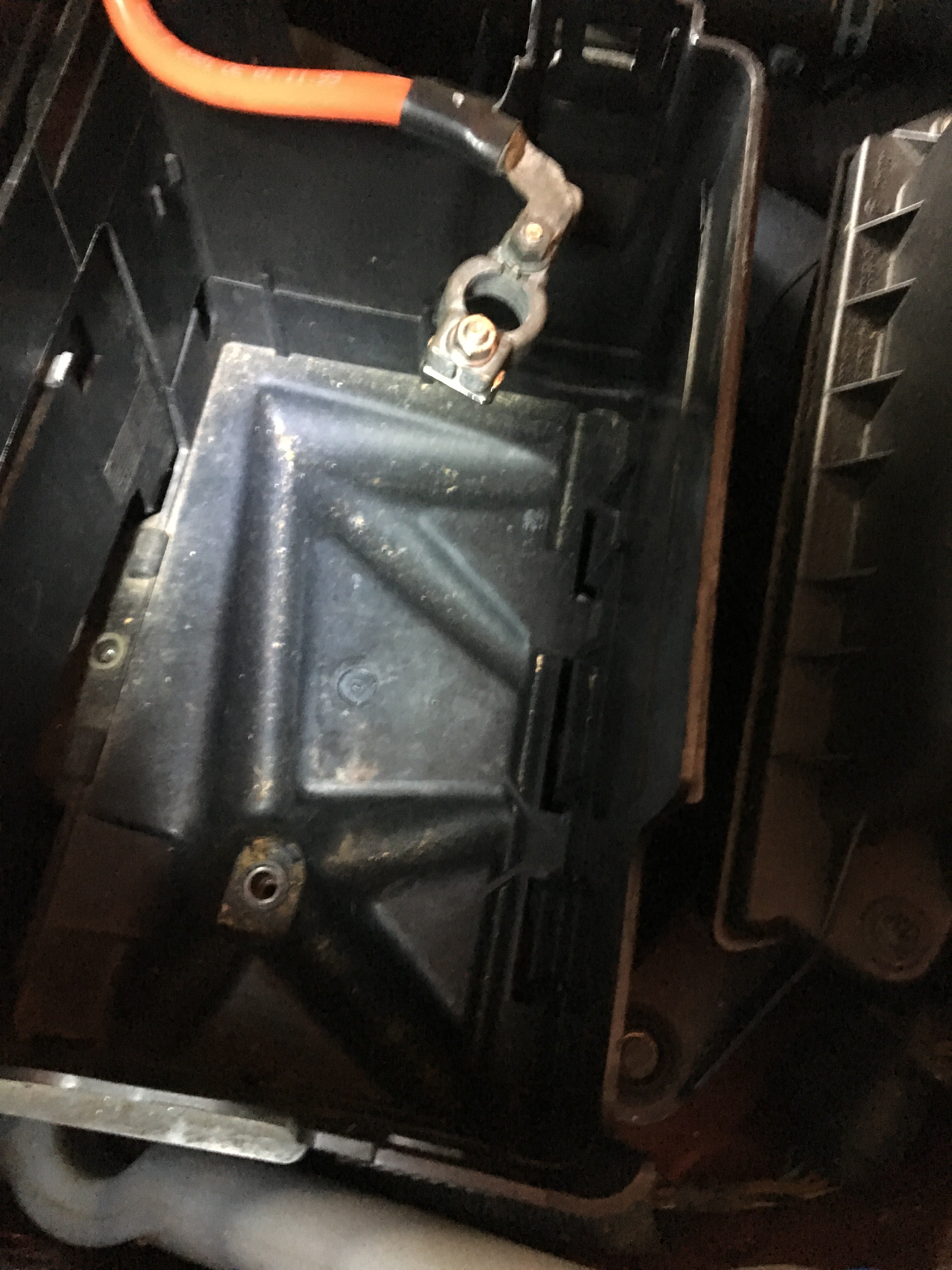

i have removed battery and one 8mm bolt inside bottom of battery case
what else it holding it ?

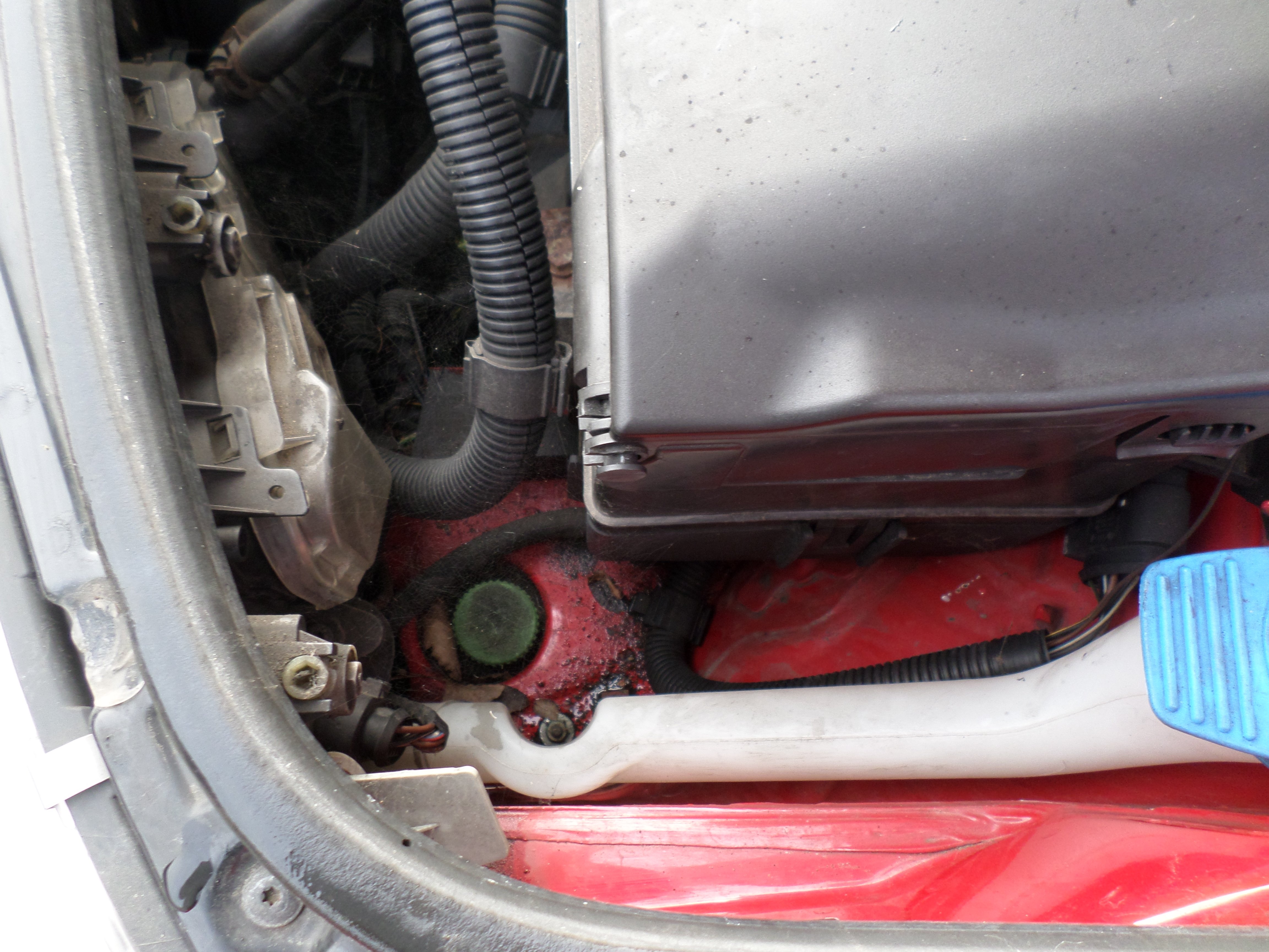

The reservoir cap is in front of the battery, down behind the headlight, pale green cap, I don't think you need to take the battery out.

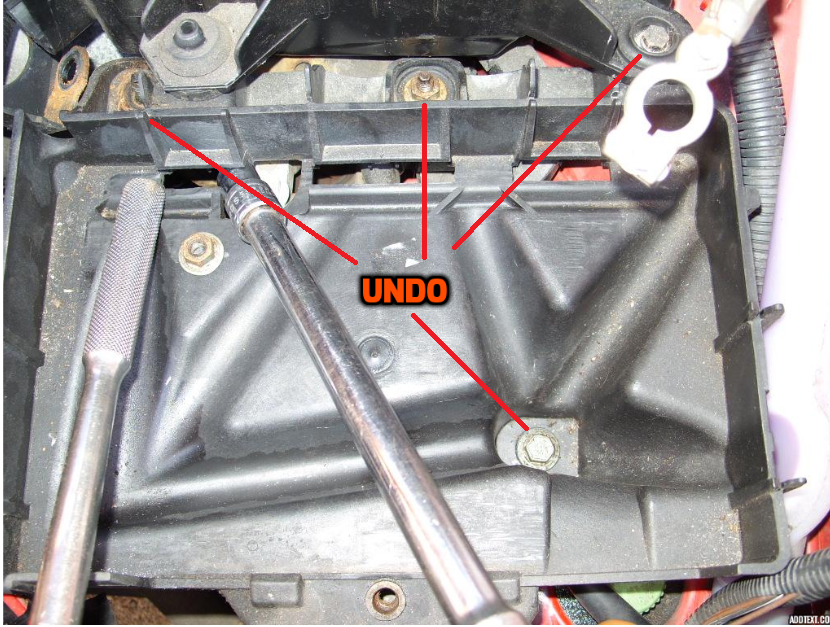

You need to unclip the square battery box from the bottom tray to access the other nuts/bolts.
I have the same model Fabia and I took a pic of the battery tray bolts last time I had it out...

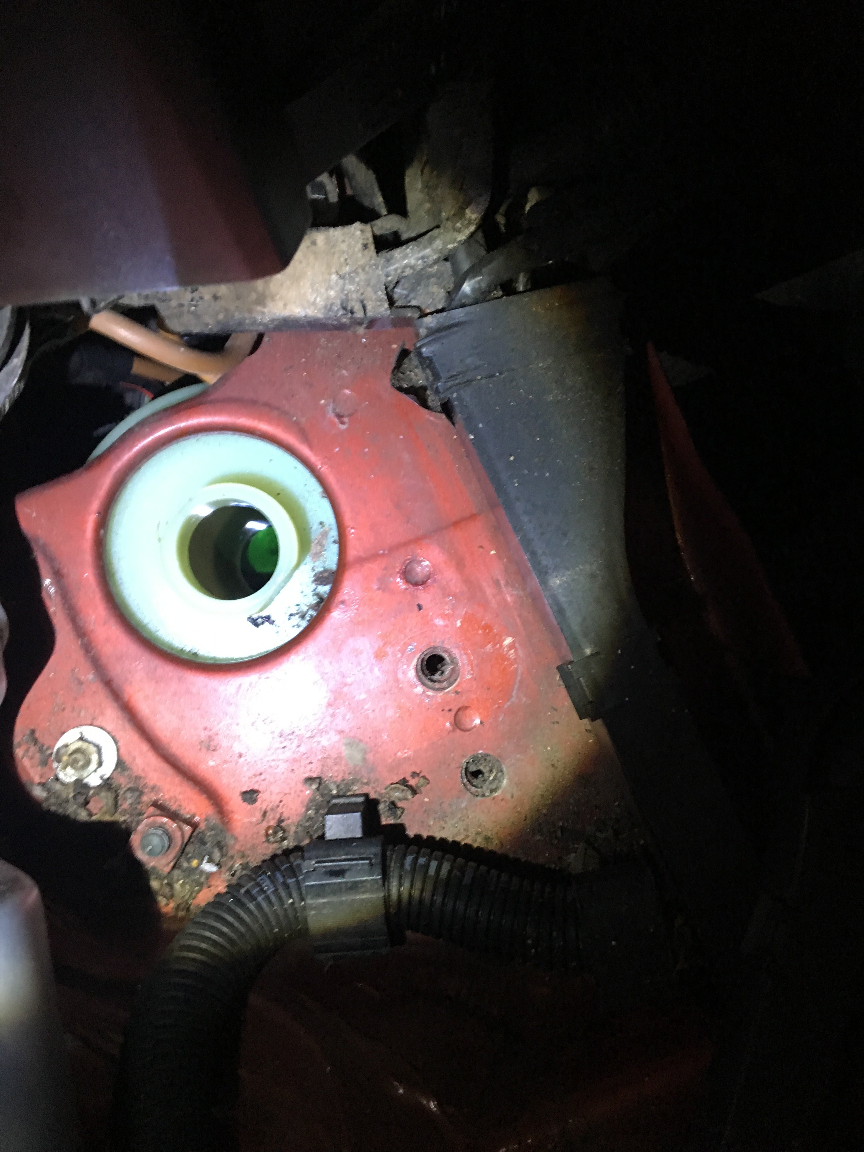

Battery tray removed
have found oil level not even touching minimum part of dipstick, have topped up, around 40ml, yet to try.
It's possible that the fluid is leaking into the passenger side steering rack gaiter. Mine does it but it's a very slow leak on mine. Just top it up and see how it goes.
