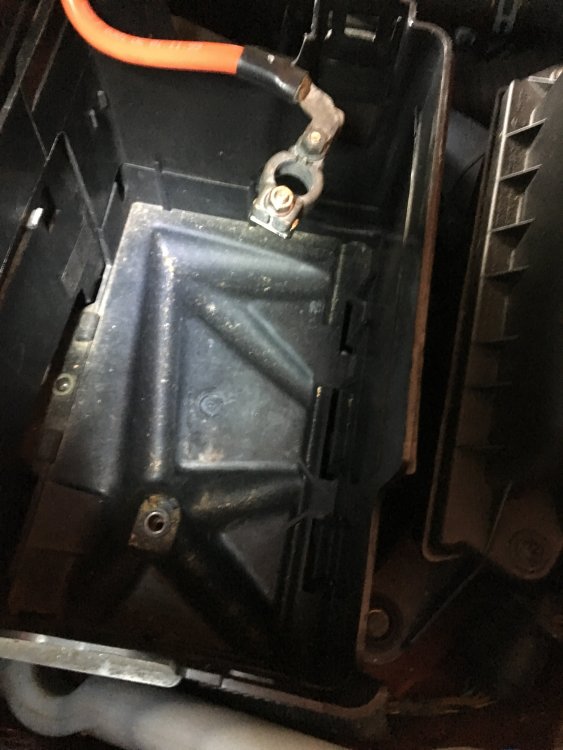

  • You need to unclip the square battery box from the bottom tray to access the other nuts/bolts. I have the same model Fabia and I took a pic of the battery tray bolts last time I had it out...
