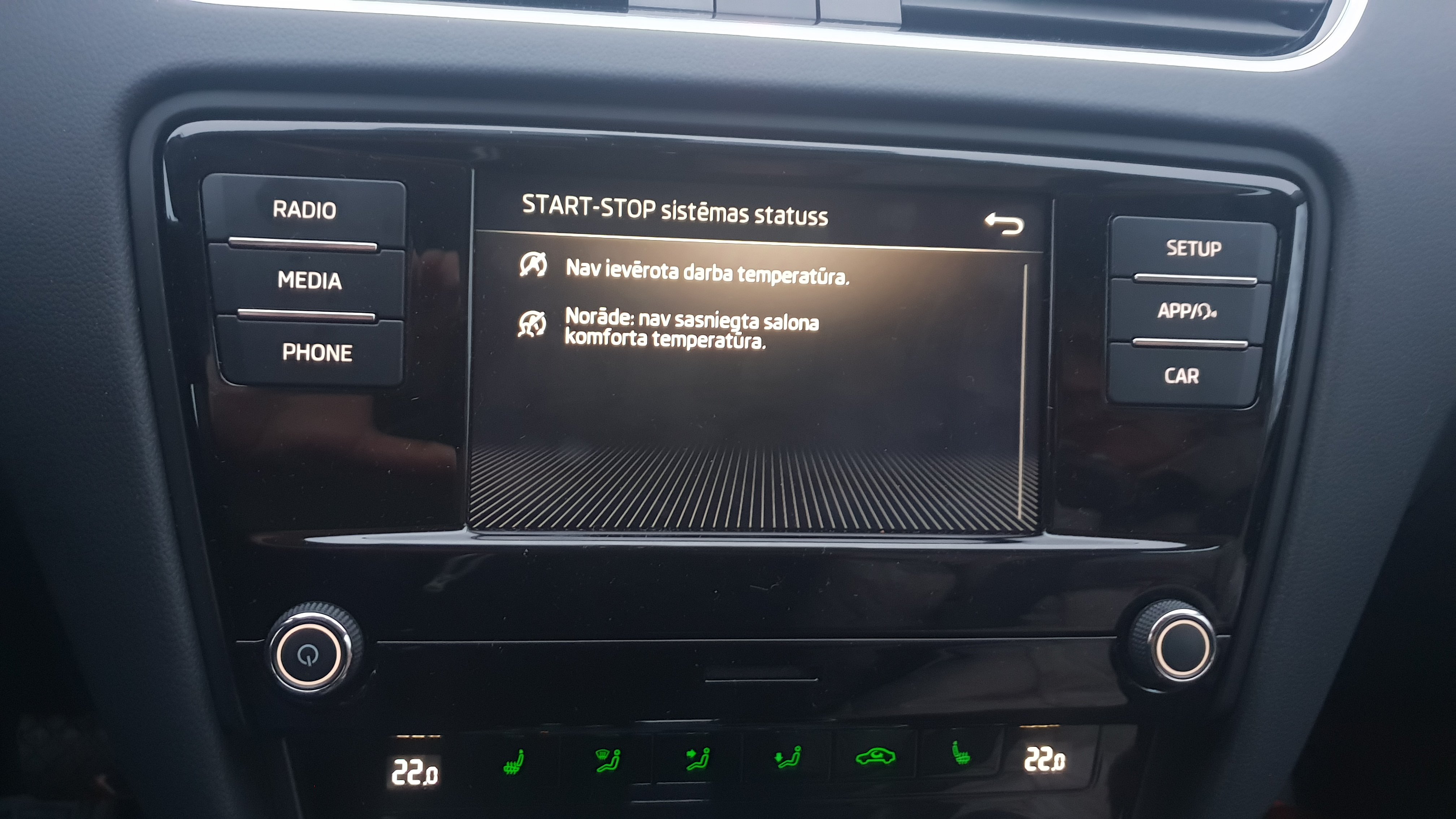

Just make a photo of the car unit and we can tell ;)
Here we go
That does look like a Swing - are you sure it supports Android Auto?
