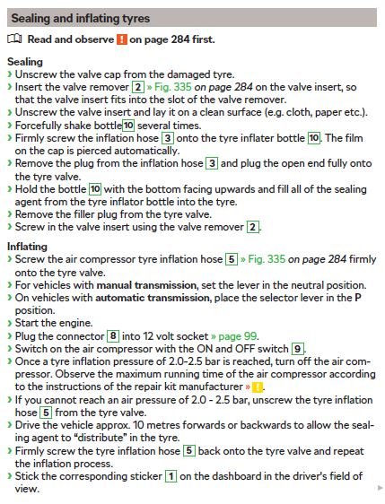

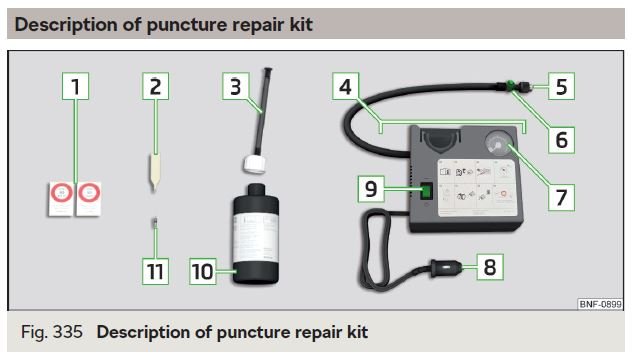

There are several versions of the inflator, but most have a gauge (item no. 7) and an off / off switch (item no. 9), allowing you to inflate the tyres to your preferred pressure...
