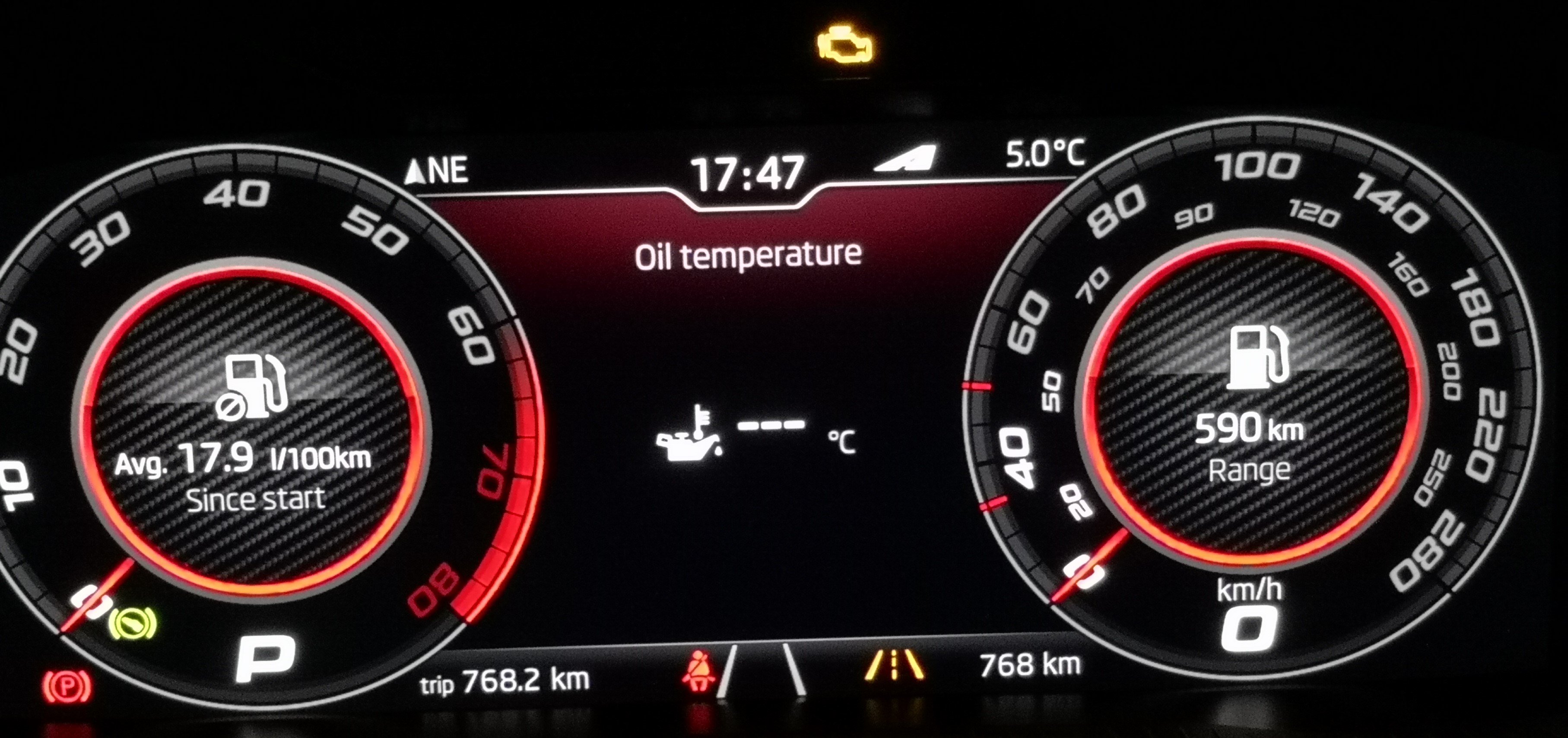

That is a really good question! You are talking about the smaller numbers that are in the inner circle of the dial, right?
It would be nice to have them, they make it look more full. So, if someone managed to get them with VCDS or OBD11 it would be great to share the option.
17 Instruments > Security Access (23257 I think) > Adaptations > (IDE13094) Speedometer_final_value > Change this to Version 4 for 160 mph end and 10 mph increments or Version 5 for 180 mph end and 10 mph increments. I have mine set to Version 5 just because :D
Sasha you are a legend!! Change applied and looking awesome with the sports displays as well. Thanks for working this out, I suspect VasilTorbov will also be making the change shortly :-)
Awesome mod! Just tried this on my 272 Sportline that should have come with 280km/h max speedo value instead of 260 like the rest of "brother cars"... :wondering:
Also I just realized how nicer the speedo looks with all the smaller speed increments  :thumbup:

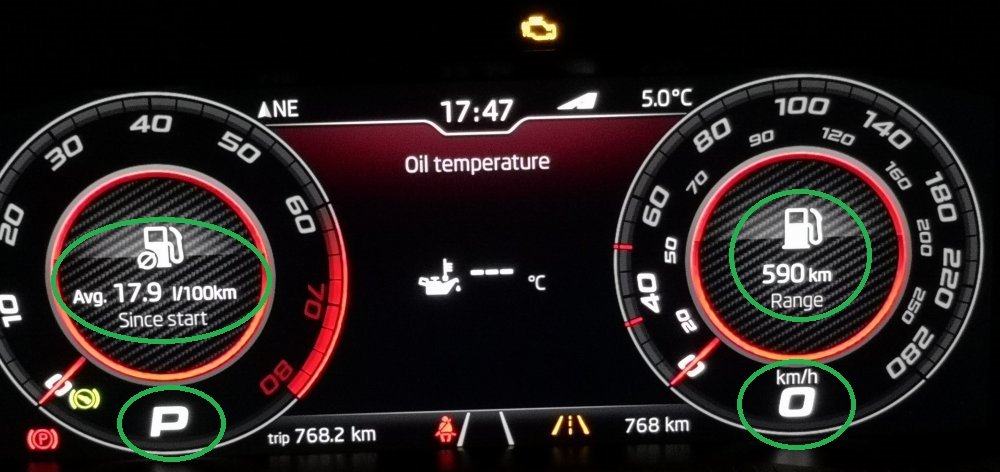

Thank you for your reply.  I didn't mean the maximum speed. I mean the contents of the green cycle which shown as this picture you posted.
Oh!  Well that's a standard customization option, no need for OBDEleven. Hold the VIEW button on the steering wheel for a sec and a menu with 5 options will show up (Auto, Classic, View1,2,3). Either Auto or Classic show only gear and speed I think but selecting View 1,2 or 3 gives the various extra info inside the dials.
You can also change what info each View will display via the main menu (screen), I think this one in the pic was a custom one I had created, with avg consumption and range being displayed. I have since them customized all 3 Views the way I liked them to be.
There's instructions in the manual but you could be right if lost in there, let me know if you manage or I can provide a step by step.

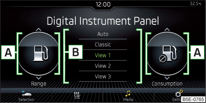

43 minutes ago, newbie69 said:
I see, not sure really as I have only ever used the VIEW button. I could play around a bit with settings of the car just in case but I don't know of a way to do this via obdeleven currently (although I could be just unaware of it)
I would appreciate it If someone can share the information about how to enable the View menu on the screen, or guide me how to change the view setting via obdeleven...
So, on a factory fitted VC, you can set the view from the infotainment screen as well as the VIEW button. Main Menu > Vehicle, there , under "Selection" choose the "Digital Instrument Panel" sub-menu and you have access to this screen:
Unless you just haven't found that menu give it a try, otherwise I guess yours being a retro-fit lacks the "Digital Instrument Panel" entry under Vehicle menu options.
In that case it would be a matter of enabling this sub-menu in VCDS/OBDEleven but I have no idea of where this adaptation would be...
Edited by newbie69
