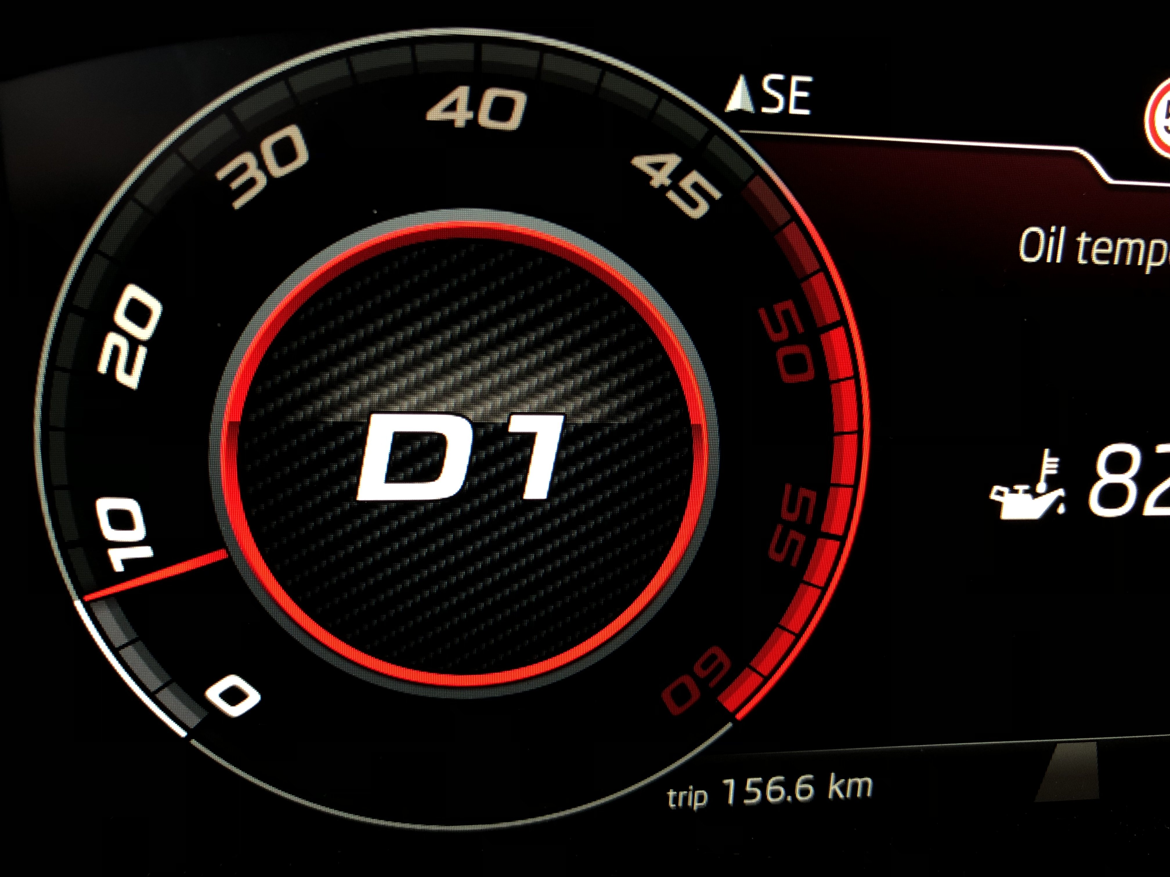

I've seen photos of Superb Virtual Cockpit with the RS skin (assumingly coded in):
it is in my mod list for when my Sportline arrives, a VCDS or OBDEleven thing for sure although I haven't looked up the exact instructions yet.

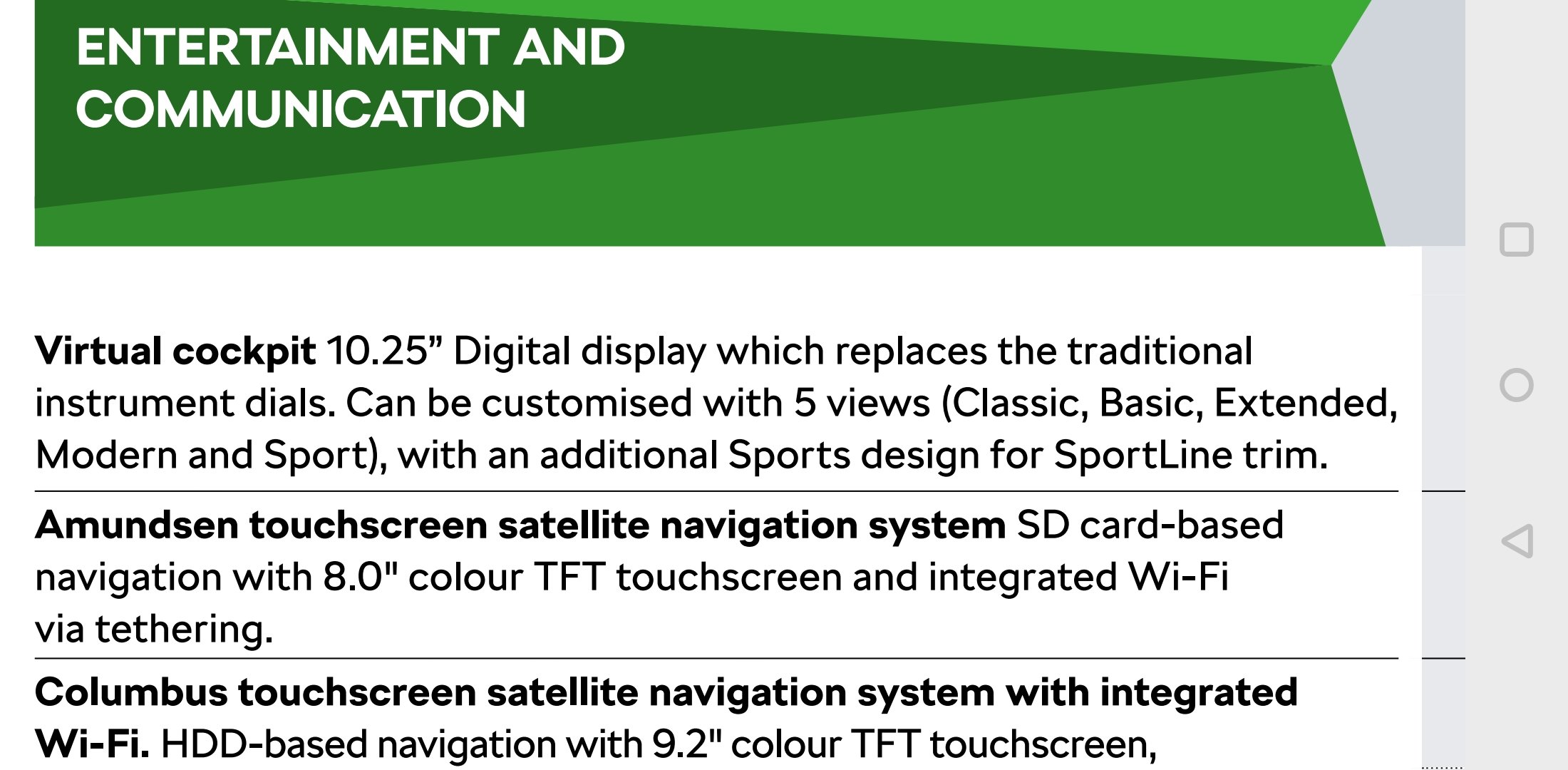

I was browsing another thread yesterday and someone with a Kodiaq Sportline (non-vRS) reported that it came with that skin as standard so we should be good with our Sportline Superbs!
Just spotted this on the online pricelist
Additional sports design for sportline trim

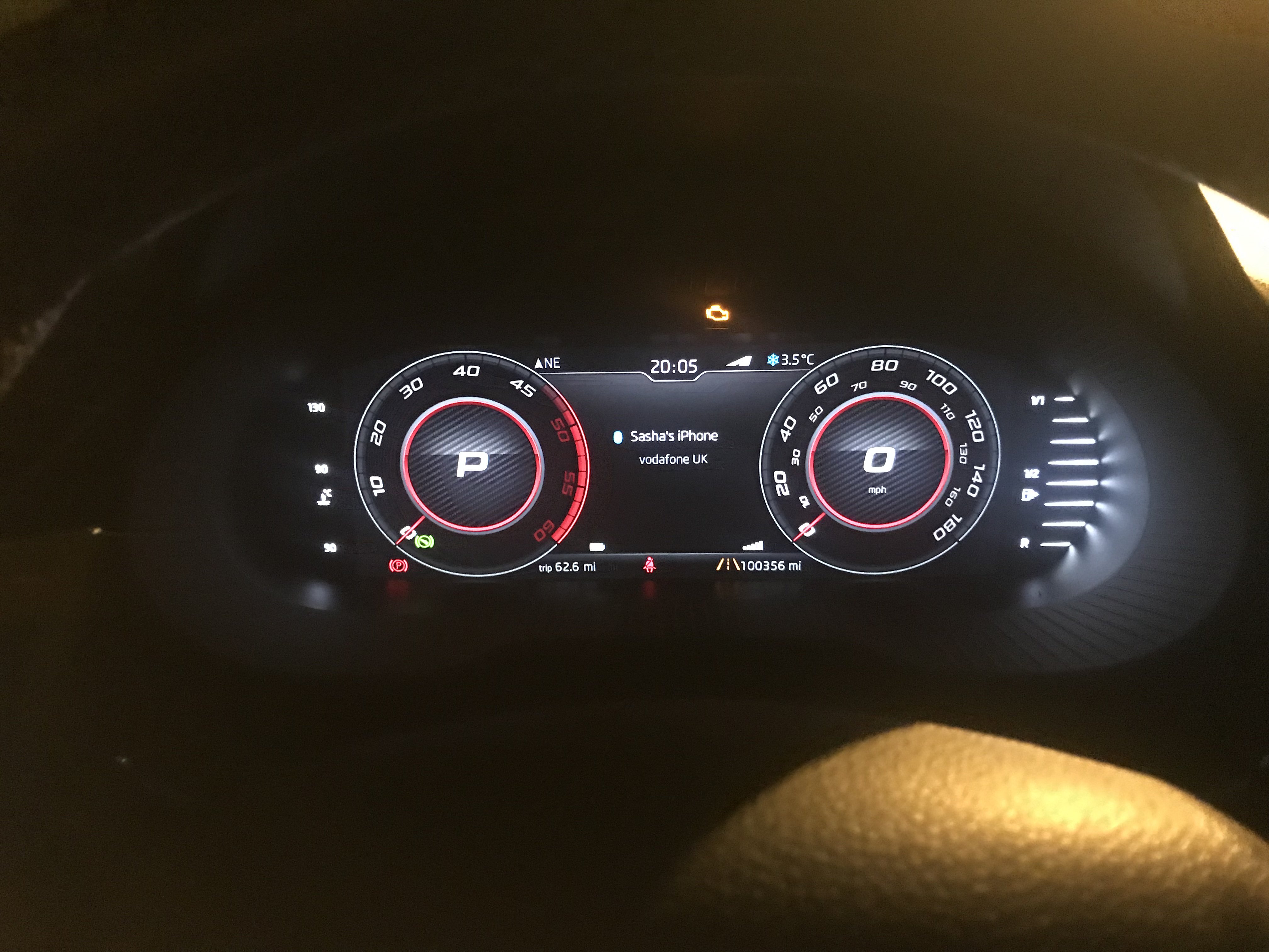

I have the answer
In adaptations, you need to change the Tube version to Version 3 et voila :)
1 hour ago, SashaGrace said:
I have the answer
Persistence is the key! Nice find!  Which module is this adaptation in? Guessing either "17" or "5F" ?
Edited by newbie69
It’s in 17 Instruments, just in case the SportLine doesn’t come with it :)

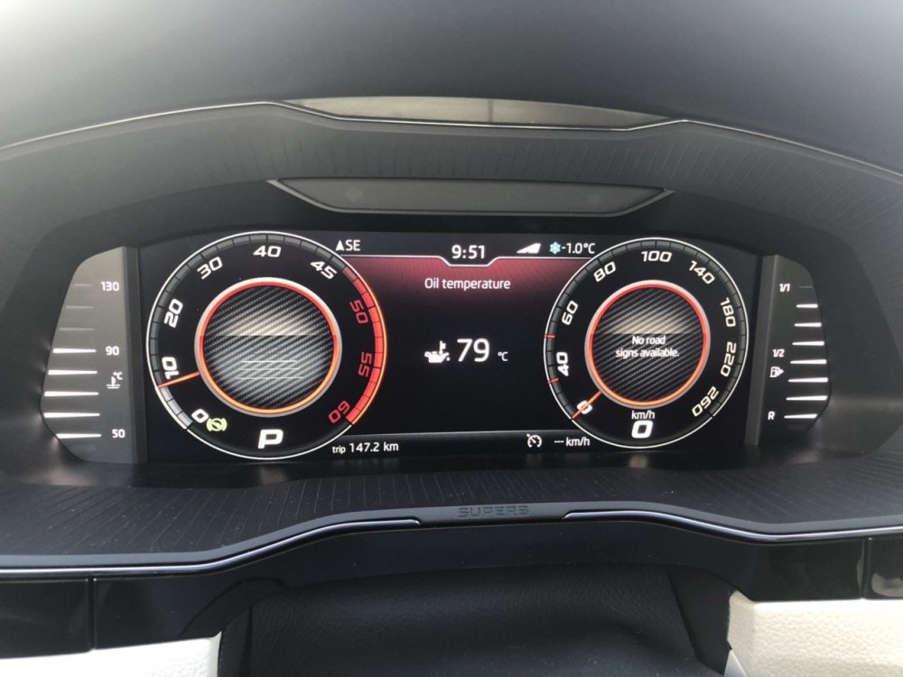

Here is mine as well, but do you see the difference between the styles in our Cars and the picture earlier in this thread. The red inner rings are pure red and for ours they kinda fade in the middle where the Carbone line is. Is that normal and do you think it can be fixed?
I hope so as the solid red rings look way better
We have the same skin in the Sportline as posted earlier, the "good" one with the solid red ring.  Here is the only pic I took of mine right when it arrived at the dealers and you can easily see it, no orange/fading colours:
Maybe what was posted just above is an effect of some particular mode/menu/camera settings?
I was able to get a better picture. They tried to make a 3D effect looks like. It's just not in my taste :)
