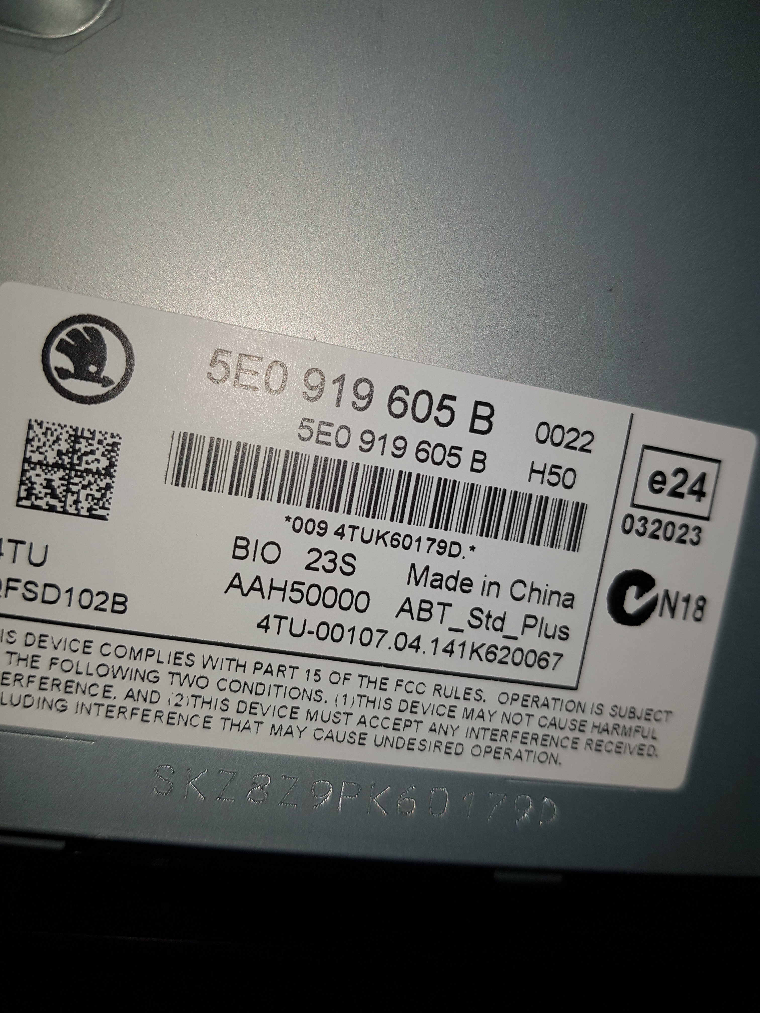

I need to replace  my radio touchscreen E50 909 605 B.  The dealership quoted me over £400 for a new one . There is one on EBay  but it is part no. E50 909 605 H. Will this work in my Octavia  mk3 ? I've read about  coding ? Will this be an issue ? I have the little key things to take the screen out can I just unplugg the old one and put in a new one ?

Do you mean 5E0 909 605 B  and 5E0 909 605 H, or are you sure the part number you have is E50 909 605 B ?
Yes that's the one  rustynuts.
Ah, another mistake. 5E0 919 605, not E50 909 605
Sorry . Not great with all this.
Any ideas if it is possible  just to unplug  and swap.  Or is it a fools errand?

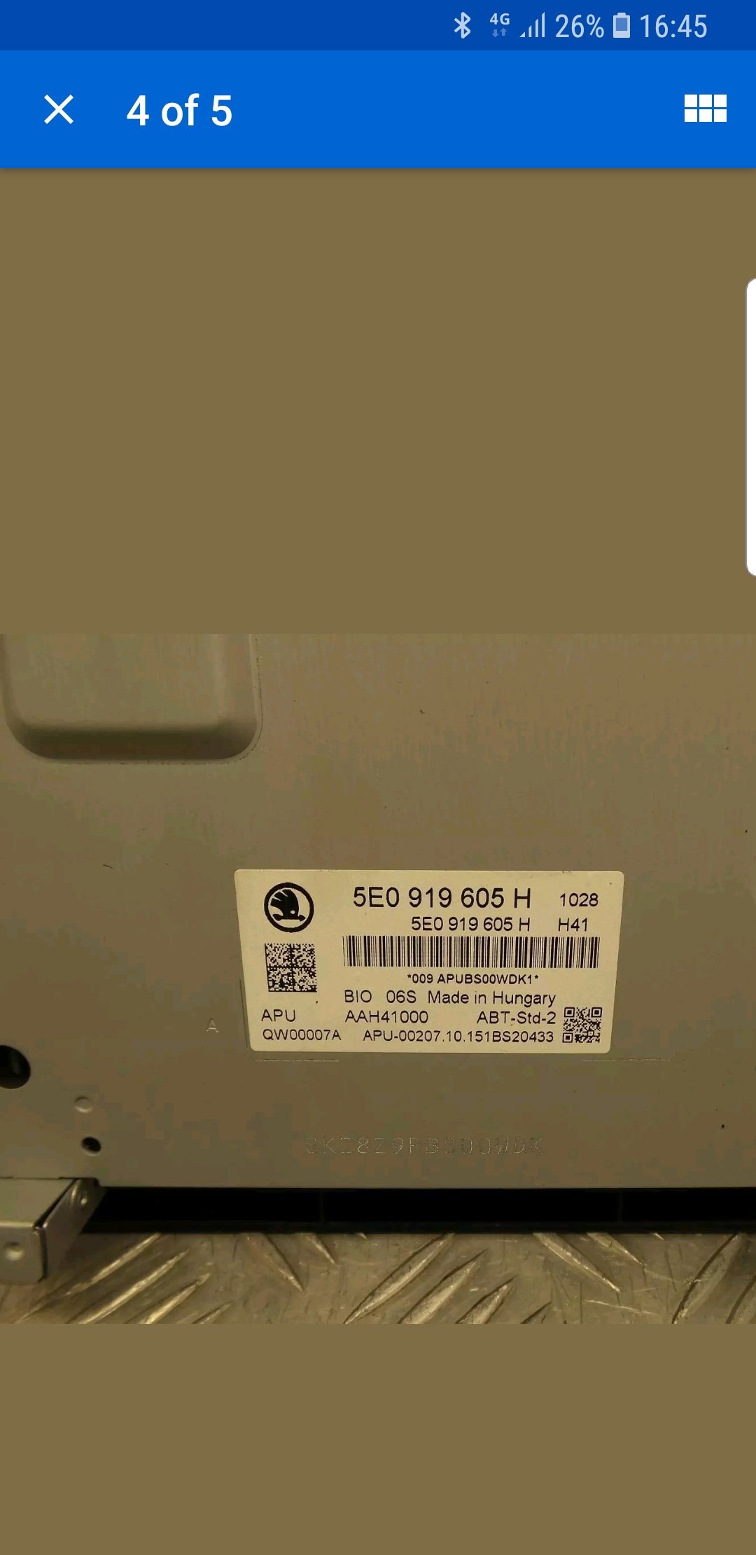

The letter at the end is rather important, as some Bolero infotainment unit screens have the same part number as Amundsen screens, but obviously will be missing certain buttons (Nav for example). So you'll need a screen which has the correct buttons fr a start. I can't find any reference to part number 5E0 919 605 H. Have you got a link to it?
Don't  know  how to link you to it . Hope this helps
It has right  buttons.  No Sat nav
No, that's no use. That screen is for an MIB2 unit and yours is an MIB1. The resolution is different so it won't display properly.

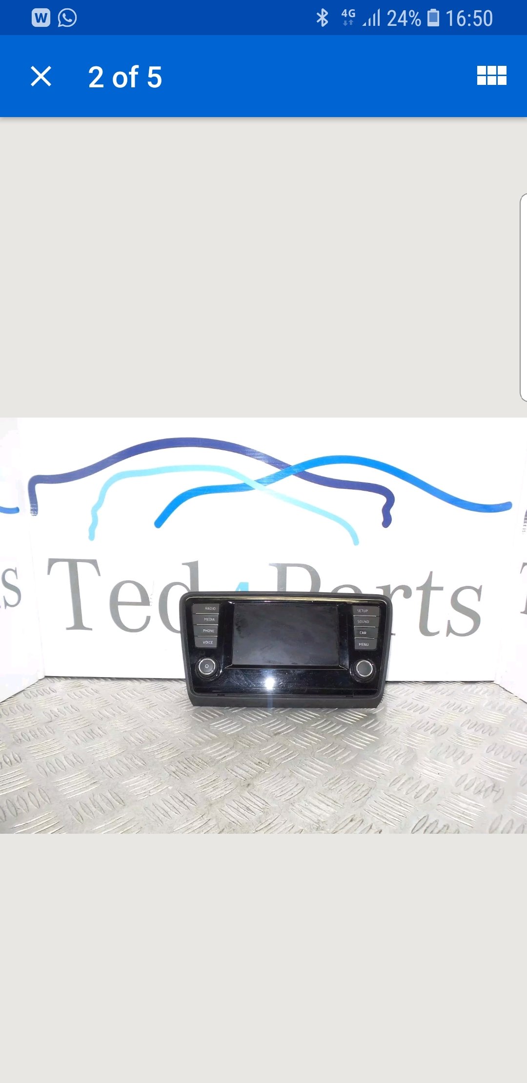

Take a look here...
https://www.ebay.co.uk/itm/352544096974
The seller has listed it as from a Rapid, but then in the details he says it's from an Octavia. It's a little more expensive, but should be the correct one if the donor car is an Octavia. The Rapid didn't use that part number.

Would you know if I buy this would I simply  unplug  the old one  and pop this one in place and it would work ? No need to recode it . Are the screens car specific,  lock to one car or are they just a screen ?
They're just a display/input unit. No coding required and it should just pop in and work. Be careful when you remove the smaller plug from the rear of the screen. They are a tight fit and can get damaged if you're heavy handed.
