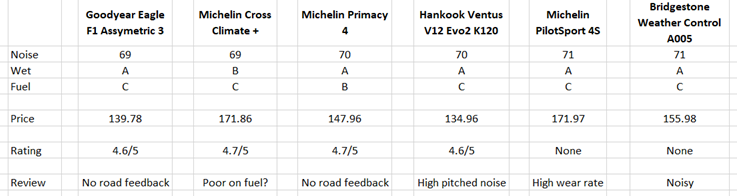

So it looks like I'll have to go with my second choice - Goodyear Eagle F1 Asymmetric 3. Can't say I'm too disappointed TBH - it was a close call in the first place.

  • Michelin Premacy 4 are a lot quieter and seem better in the wet than Pirelli P7; haven't had them on long enough to comment on wear but reviews suggest this is good.   Many people (me includ

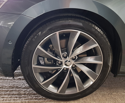

    Thought I'd give an update after a week and c600 miles on the new Asymmetric 3's.   Road noise - they are significantly quieter than the P7's. To the point where wind noise (pipe down in the

Personally all seasons are my choice, i have on our fleet, vredestein quattrac 5, goodyear vector 4 seasons gen 2, and michelin crossclimates all very quiet and long lasting.

So as of just before Christmas I now have Michelin MPS4s. Quite expensive, but I justified it with the hope that they would last better than the Kumhos. Well so far I have to say they feel and sound quite hard. Definitely louder than the Khumos. Grip is indistinguishable from the Kumhos even on twisty Scottish country roads. Handling is possibly a little tauter. But I have to say the noise and ride harshness is noticeable every time I set off. So I will only have them again if they last significantly better than the Kumhos (taking into account they are quite a bit more expensive). Being hard, they hopefully will!

I suspect the susceptibility to tyre noise is due to the light body weight. My experience with the P7s was that tyre noise was generated at two different frequencies, the usual low frequency tyre rumble and a really annoying higher pitched noise that could be heard through/over loud rock music on the media system. The worst of it is the windscreen seems to focus it.
Later cars I've driven seem less affected so clearly its an issue they are aware of but VAG are so secretive.
