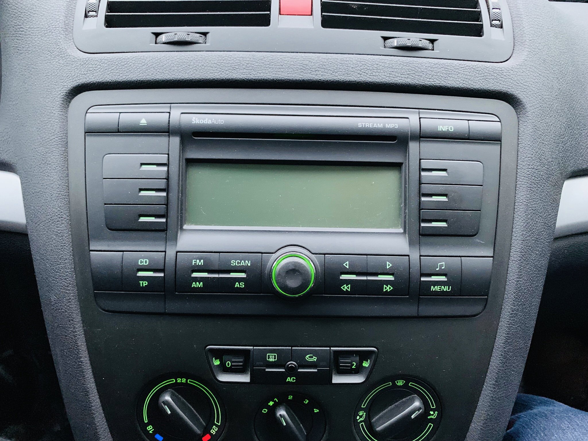

I have a 2007 Skoda Octavia mk2 (Z1) without steering wheel controls and I’m looking for a car stereo headunit with CarPlay and Android, that I want to replace the factory stream mp3 stereo with.
I have been looking at the RCD340G CarPlay Plus Radio Green as an replacement stereo.
Link 1
https://www.ebay.co.uk/itm/Green-Button-6-5-MIB-RCD340G-CarPlay-Android-Auto-For-Skoda-Octavia-2006-2012/253263142104?hash=item3af7a8dcd8:g:VIoAAOSwZRpaZyMB
Link2
https://www.aliexpress.com/item/Carplay-Noname-RCD330-RCD330G-Plus-Radio-Green-Backlight-For-Skoda-Octavia-fabia-6RD-035-187-B/32830355746.html?spm=2114.10010108.1000023.3.2234316ekJkzro
Does it work with my Skoda Octavia 2007? Is it any good?
Do I need to replace the radio trim? I have the manual air conditioning controls. If so, what radio trim do I need?
Are there any other things I have to take to consideration?
This is a picture of the dash in my car
Kind regards,
Benjam

My car is the Octavia 1z3 with the stream mp3 HU and I also wanted to find something that is basically plug and play. But all the new stereos that have been found only fits the Columbus HU so I can swap the radio trim from Stream mp3 to a Columbus.

I agree with you. Stream is really bad and I can’t wait to update it. I have checked out Kenwood and Pioneer players that support Carplay (because me and my wife have iPhones). They are little pricier and I guess they would require better speaker’s and soundproofing to extract the extra value. Too bad that you have had some issues with reverse camera etc. Hopefully you get them resolved.
Did you change the radio trim or did the Kenwood fit the original Stream trim?

The only really not OK bit is the Aerpro plastic surround trim, facia kit thingy. Their dedicated, Skoda-matching kit ($103.00 AUD) doesn't integrate with Stream radios fascia. Don't buy it. It requires major surgery to both the existing Skoda radio trim clips and the Aerpro supplied trim which is only about 15 mm across. You'd have to cut all the clips and glue them together, somehow getting the spacing right.
I rang Aerpro in Melbourne twice to ensure I had the right part before ordering, including letting them know I had the Stream version. When called afterwards, straight up they said, yes, we are hearing it doesn't fit the Mk2s. We will get back to you once we have a fix, a few weeks. Meanwhile the HU just hangs there. I painted the mounting brackets black...
