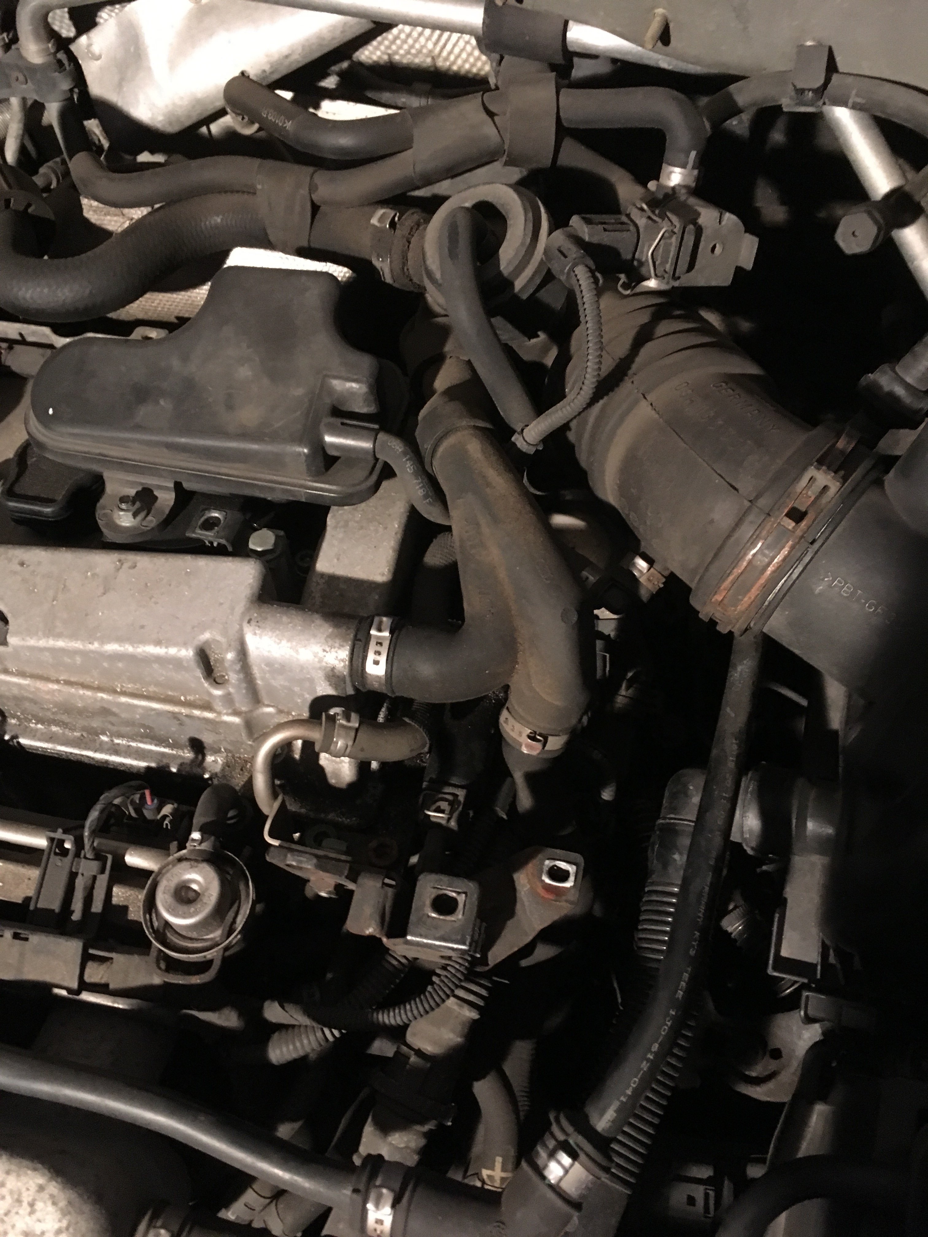

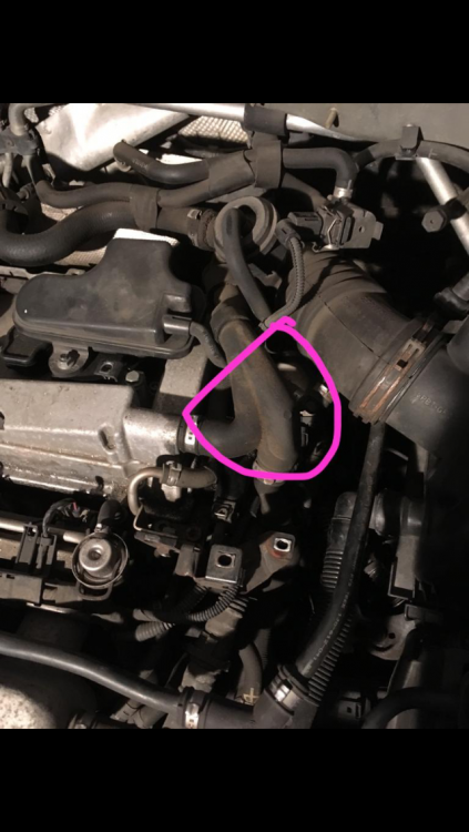

Also, this y-piece (right in the middle of the picture) is extremely soft, is that normal? Looks like some sort of breather. - I know hoses can collapse causing issues etc.
Edited by 4Wardy
1 - breather hose which usually cause problems, not rly expensive one, expect to be full of oil and cracked in the Y shape or under.
2. Under this is N249 and lots of vacuum pipes, which usually collapse also and create bunch of stuttering.
3. Just under the oil level pipe is PCV breather hose + valve, which usually is fcked up also and can cause oilo consuption + erratic run under load. Pain in the ass to change it, but it worth every penny.,

The Y shape breather hose is 06A103221BH
Could that y hose be the problem then? Is it normal to be super soft or should it be firm?

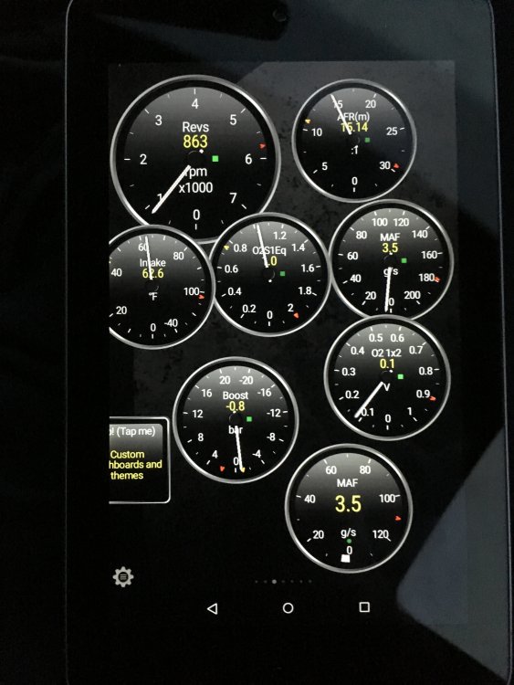

Ok, so I have A quoted an android tablet. I’ve got torque and it connects to my obd dongle.
i will download the pro one shortly now I know it works.
what gauges shall I put on the screen and how do I log/store the data?
thanks
MAF/turbo pressure/rpm/coolant temp/ air/fuel ratio

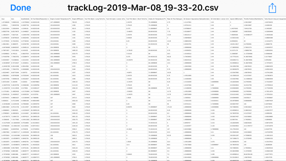

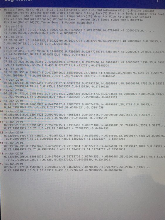

How to store data - dunno I use regular VAG.COM to do that, but there should be some option.
For example healthy MAF should read max 2.7g/s on fully warmed engine without acc on.
Ok I’ll try and work out the storing of the info.
i was able to watch the garages whilst driving to a degree I noticed the maf was 4.8 when off throttle and I think I saw 6.something.
boost when flat out was about 15 psi but I did see 42psi.
maybe that was a bum reading though.
will set it up and try in the morning when the car isn’t behaving!
Cheers
Anything more than 3g/s without acc on and fully warmed means that your MAF is on its way to motor heaven.
