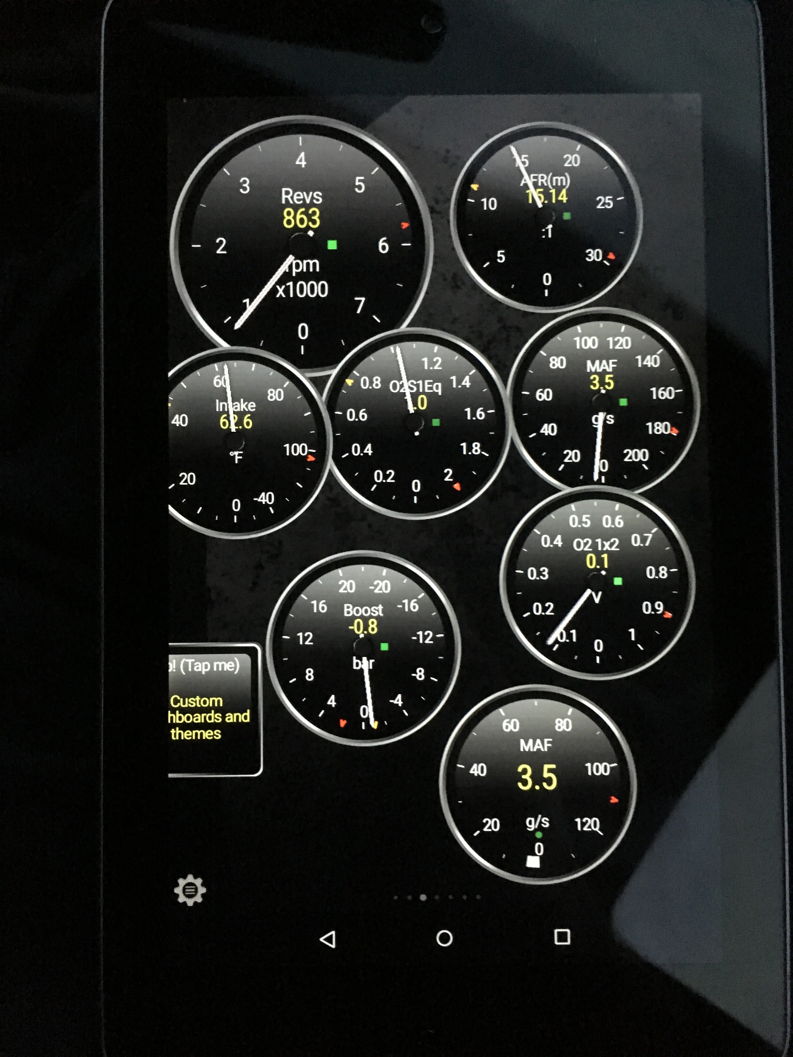

Struggling to sort the logging at the minute but you can see max limits in green for all the gauges.
screenshot is at idle.
maf 178g/s max and 3.5g/s at idle once warm.
Edited by 4Wardy
That MAF reading is on idle is bad, who did the  chip? Do you have another VRS around to try swap the MAF for free? Also 178 g/s point to more than 210HP or MAF is telling more than it really is, causing the car going rich.

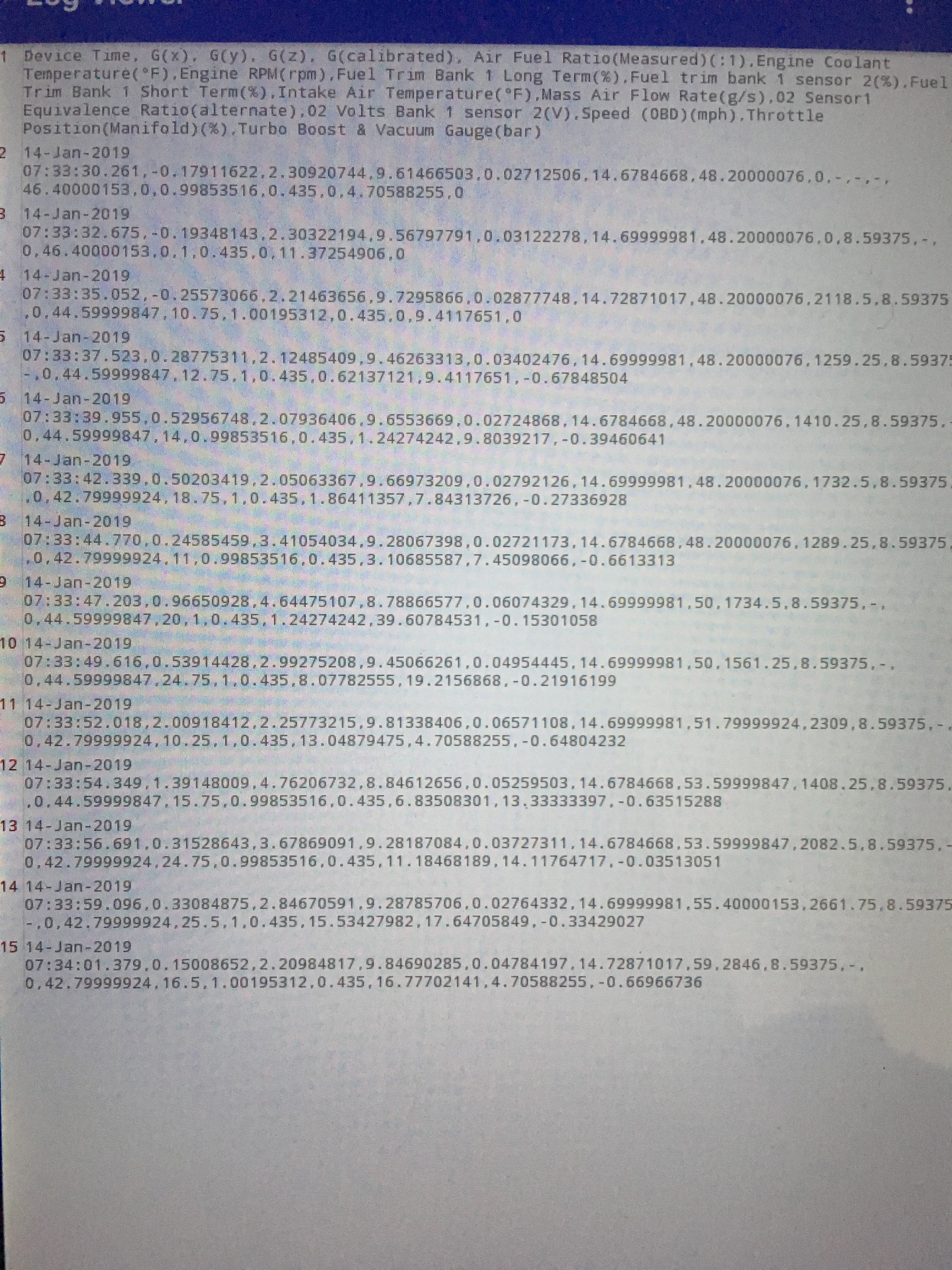

Could you post the log data in text here so i can give it to table excel?

I can’t seem to load that data any other way.

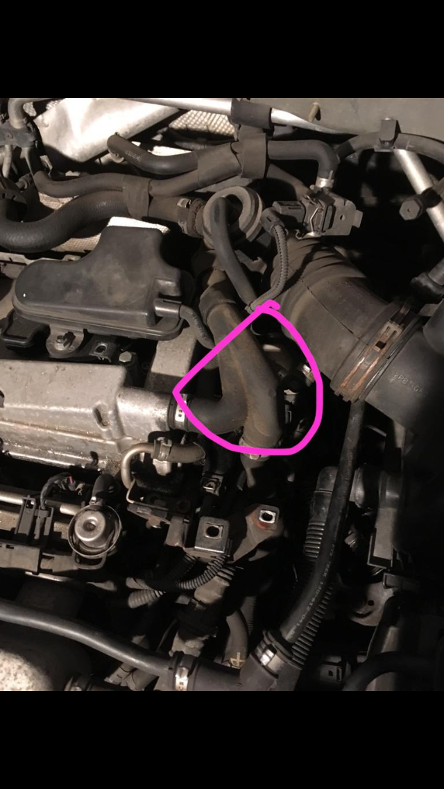

Well I have found an old friend with vagcom so will be getting it to him as soon as he can fit me in. But in the mean time can you tell me what this y-hose is and what it does please? It is very soft and I can see it collapsing when I accelerate hard.
 Could be part of the issue?!?
Read one of my post earlier in this thread. I have described this one already.

ive replaced all breather pipework from the oil filter housing up to the pcv including the y piece which was very soft.
the whole run of pipes was full of congealed creamy white oil and sh1tty bits.
the bottom part of the hose seemed to have a split in it and as soon as I touched it, it shattered.

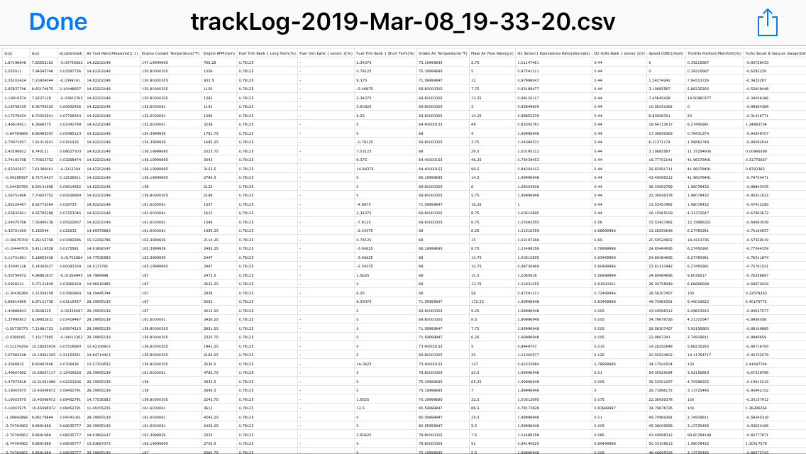

Just managed to do some logging if it helps diagnose. Hope you can read this.
