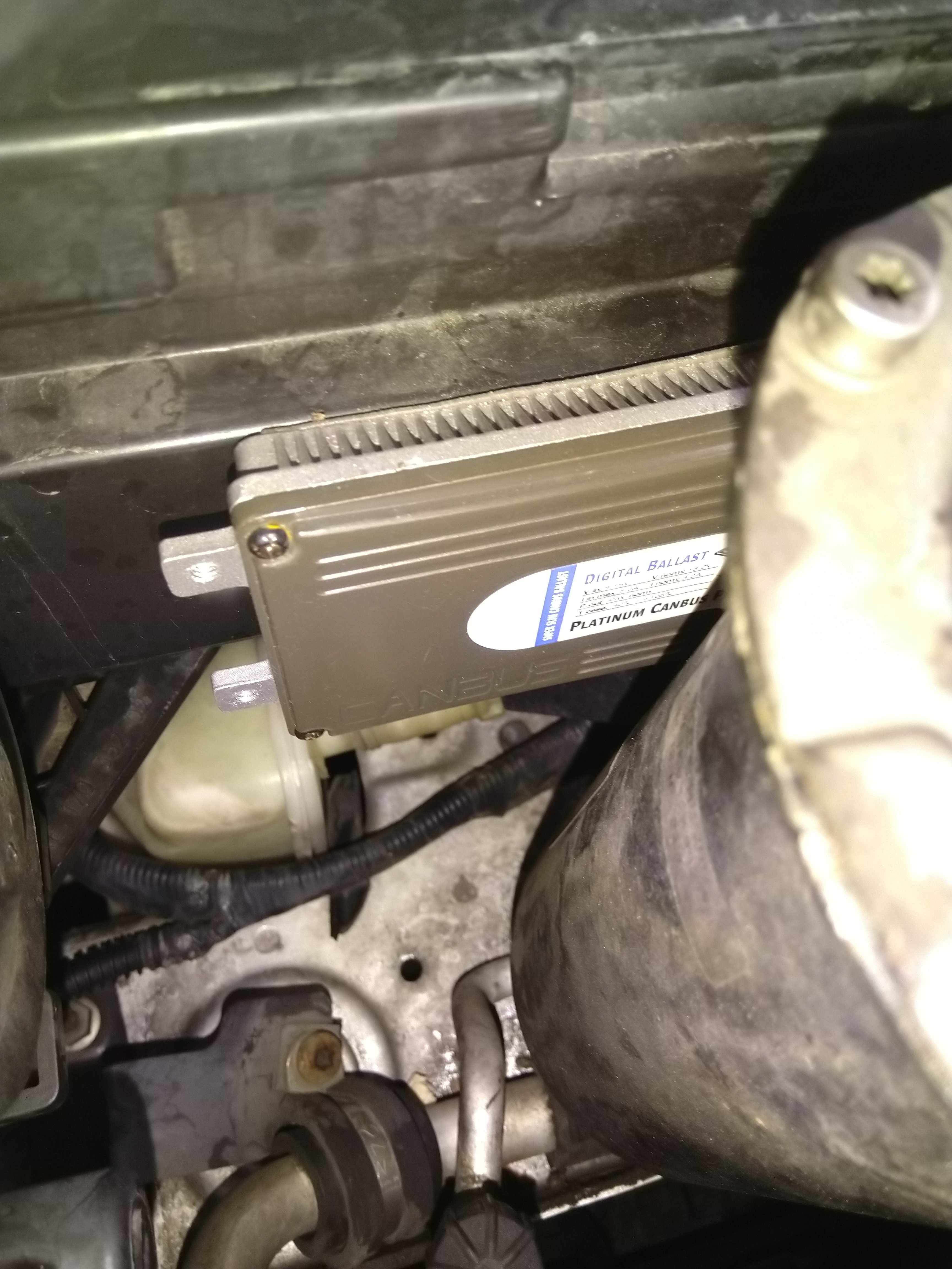

So I then fitted an Ali-Express HID conversion which required a lot of fine tuning of the aim settings to avoud being flashed by other drivers but once done the lighting as again 2 or 3 times better than it was, when they were set too high the illumination was stupendous and I think a proper factory install with the levelling motors and sensors would be a lot better than what I have but its still a great improvement on the yellow candle lit puddles of light before.

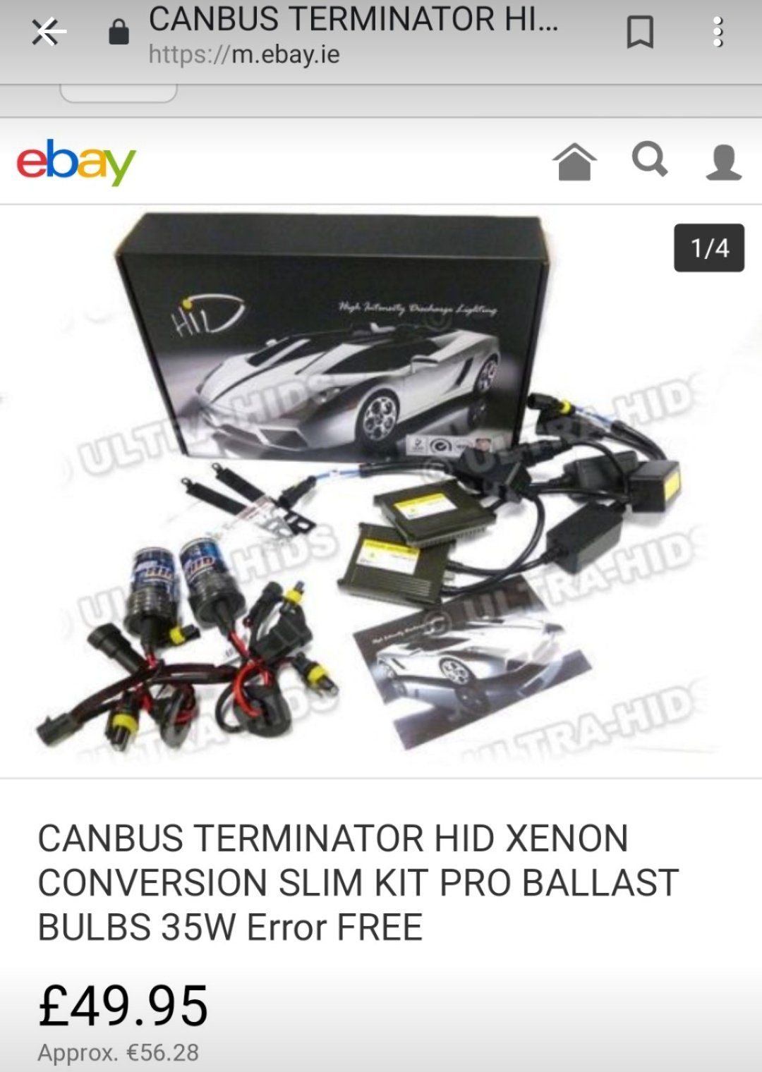

As I do an awful lot of night driving, I was having lots of issues with my bulbs, chopping changing, night breakers, led with cooling fan etc etc....
So I just went with Hid xenon s.. Love them and my eyes feel the difference also. This is a great kit with little or no interference to any audio or electrics.. it's an easy install using your original h7 clips or buy pre cut clips. The ballast fits perfectly to the smooth rear side of your lamp housing as in the pic below, just use 3M double sided tape, no need to screw.

This was the HID kit that I fitted
What colour temperature did you go for?
Just looked at the order details, they were what was then called "warm white" so I guess its the 4300k ones, the number rings a bell.
They just look white to me, no trace of yellow or blue but its not a harsh clinical white, it compares with the daylight white LED downlighters in my kitchen and not the warm white ones in the lounge. I believe other colours may have a better range.
Hope that helps, I dont regret my choice but have nothing to compare it to.
