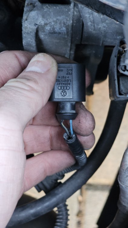

I've recently been plagued with my reverse lights staying on after putting the car into reverse and taking it out of reverse.
I took out the sensor, cleaned and installed it again and the issue is still there.
I then discovered that when the the reverse lights are on, if I move the wire attached to the reverse switch they turn off which would indicate to me that either the wire or connector has a loose connection.
I was going to buy a new connector and snip the old connector but just wanted to double check that this is the issue just to be on the safe side.

Yes, it's quite common for the wires near that connector to degrade, possibly due to the transitions between relatively stiff plastic convoluted trunking and the free bits of wire just before the connector entry. Vibration and engine movement can cause the insulation to crack thereabouts, then water can get in and turn the copper conductors within into green and black dust over time.
It's probably best to remove that section of convoluted sleeving completely, buy a connector with tails of wire prefitted, and keep cutting back the insulation of the existing loom until clean bright copper is found. Then splice the wires together from new connector and loom.
Part number is just visible in your photo, 1J0973702, I think.
Having said all that, a bad connection would tend to make the light(s) not work, rather than stay on when they shouldn't be on, unless the two wires are shorting together somewhere near that same area.  Cutting that short section of trunking off may reveal something. Could also be that the switch contacts are sticking, but probably best to improve the wiring situation first, if any damage is found.

@Breezy_Pete thanis for the reply!
Yeah I found some of the connectors on Ebay for cheap with the part number so I can just order one.
Yeah it's a weird one. When I push the wire and shield toward the connector I can hear what I assume to be the switch engage/disengage and the reverse lights turning off.
