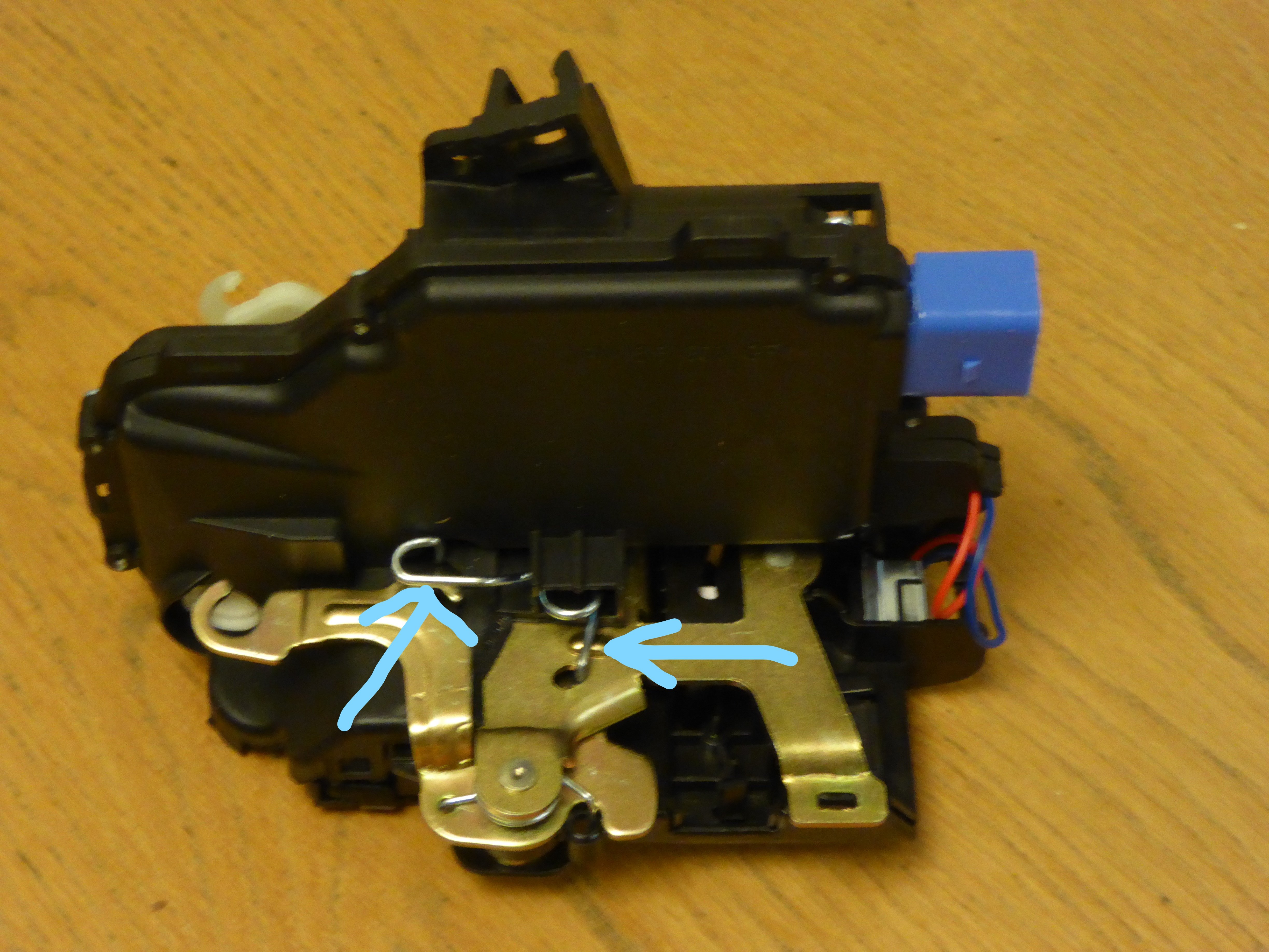

Driver's side door lock mechanism. Haynes says the spring must be fitted to slot in door handle release lever (visible under the lefthand arrow head). But when I do that it just unclips as soon as I pull the lever. The lever has its own spring anyway. Someone on YouTube advises to chuck the spring away. (!!??)

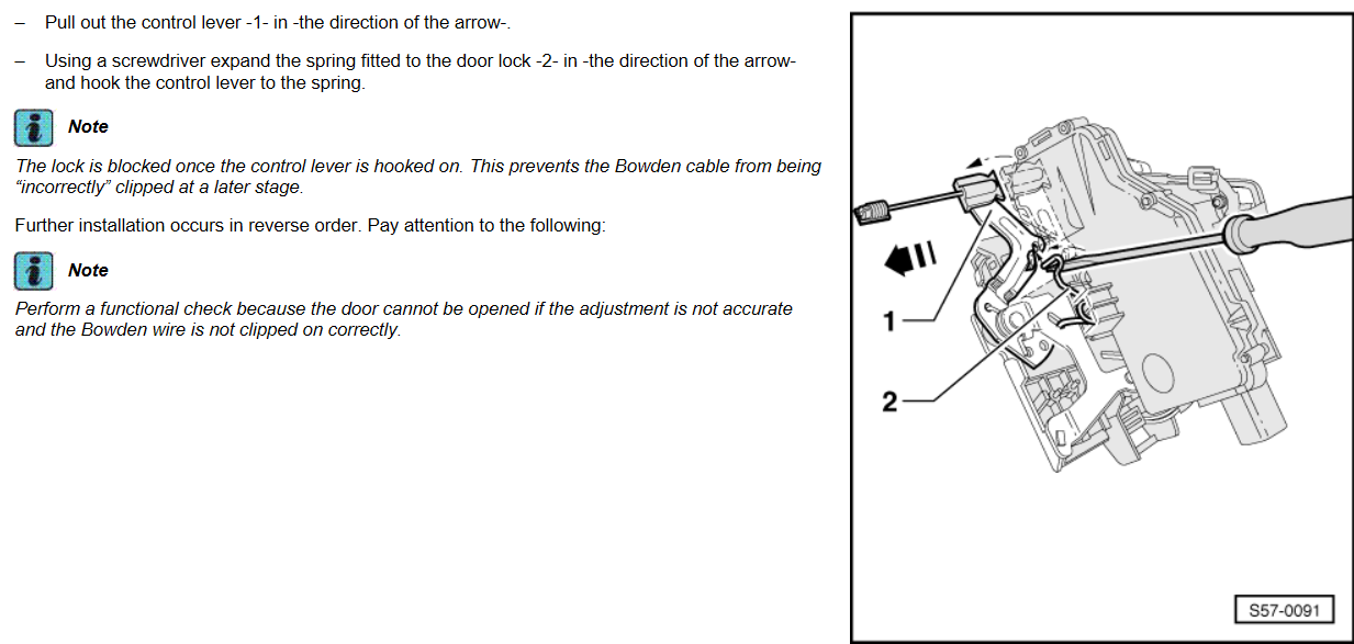

It's just to facilitate assembly.
