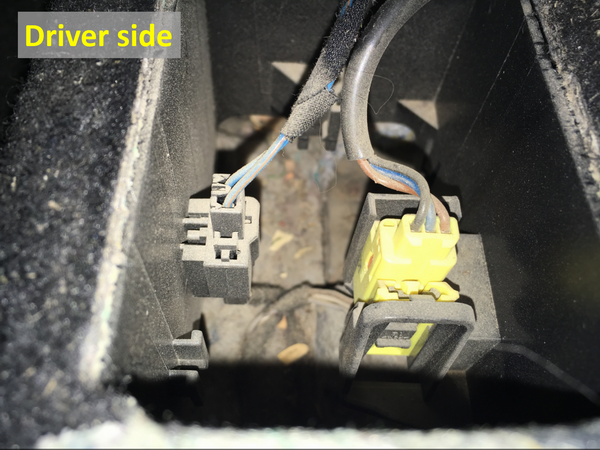

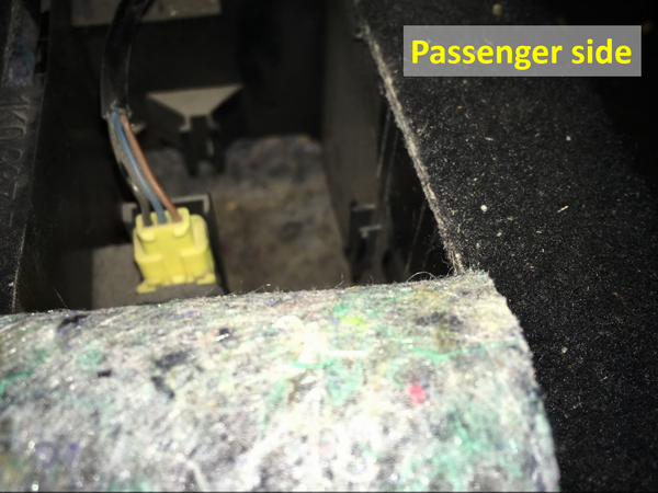

I see that my car is equipped with driver's and passenger's airbags beside two seat airbags. However, the VCDS scan showed two serial numbers. So, does this mean my seat airbags are not recognized.
I took pictures of my seats connectors in case you wanna look at. Also, the VCDS scan is shown below:

I have the curtain airbags as well and mine only shows 4 (rather than 6). It seems the seat ones do not show separately..
